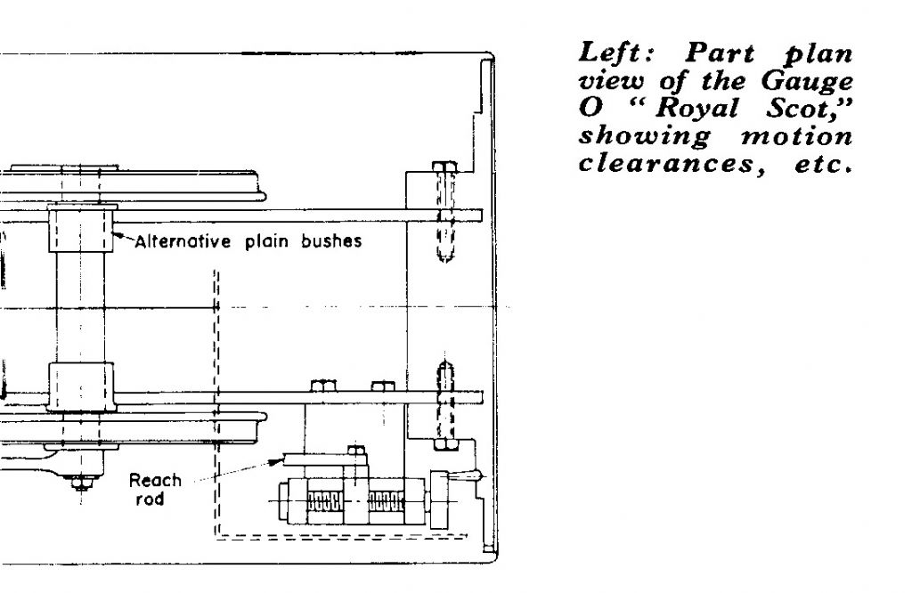

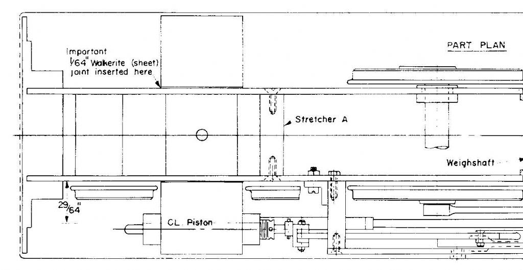

      Looking at Martin's ME articles (1969) about building Royal Scot in gauge 0, I am puzzled about the use of Walkerite sheet joint between frames and cylinders.
      Never seen anything like this before?
      Can anyone, please explain what is it for?
      Chris

        David George 1
          @davidgeorge1
          I believe that it is a insulation gasket material probably to prevent heat transfer to the frames.

              #527395
                Not my area of interest or expertise; but I note that the drawing asserts its insertion to be Important
                … Presumably because of its thermal properties, and/or its mechanical ones.
                One would hope that Martin Evans included a textual explanation … somewhere !
                Edit for clarity: __ If Mr Evans only included it as a convenient ‘packer’ then its important characteristic might be the 1/64” thickness.

                    I agree the gasket is intended to prevent heat transfer in this small engine,Why not use gasket paper,might have to use nearest metric equivalent for thickness,a local motor accessory shop sells a gasket paper which is very tough,it resists tearing much better than the old type gasket paper,or try to get some of the graphite coated,grey colour gasket material which has been asbestos free for many years,suppliers to the vintage vehicle owners is also good source ,I would suggest a visit to an auto jumble but thats not on at the moment with cov 19 lockdown.

                      J Hancock
                        @jhancock95746
                        Success or failure in this gauge can rest on the rate at which heat is lost in the cylinders.
                        Personally , I would make as much of the frames as possible in that area 'disappear', ie a hole.
                        The 'gasket' material thickness is probably vital to stop 'clashing ' somewhere.

                          Nick Clarke 3
                            @nickclarke3
                            This is the other half of the OP's drawing:-
                            As the only dimension shown is the thickness of the gasket material, one must assume that this is necessary for motion clearances.
                            Reasons for including it might be a. the original drawing of the cylinders was incorrect or b. that the cylinder castings, originally meant for a different design, would not clean up to the size required here.

                                        Clive Brown 1
                                          @clivebrown1
                                          Martin Evans, in his book "Manual of Steam Locomotive Construction" suggests putting thermal insulation between frames and cylinders of smaller models, adding to the effect of lagging the outsides of outer cylnders.
                                          The material he mentions in his book is "Hallite". Similar to Walkerite AFAIK.

                                          Chris Kaminski
                                            @chriskaminski64716
                                            Posted by Clive Brown 1 on 15/02/2021 12:00:02:
                                            Martin Evans, in his book "Manual of Steam Locomotive Construction" suggests putting thermal insulation between frames and cylinders of smaller models…
                                            Well spotted Clive yes
                                            on page 75 of 1983 edition of his "The Model Steam Locomotive" he says:
                                            "…Sometimes gaskets made of some kind of heat-insulating material are used between cylinder and frames, to reduce as far as possible heat loss from the cylinders. A sheet steam packing material such as Messrs James Walker's "Walkerite" or "Golden Walkerite" is ideal for this purpose…"
                                            So, I guess mystery solved and my question is answered cheeky

                                            Jeff Dayman
                                              @jeffdayman43397
                                              If you did want to try an insulator sheet to reduce heat transfer from cyls to frames, you could try a sheet of printed circuit board FR4 material with the copper removed. Quite a good insulator and mechanically very sturdy, no very compressible either. Just a thought. As others have said it is likely not needed as seen my many existing O scale steam locomotives without it.
                                              Another thought – if Martin Evans had milled away the material around the cyl screw holes and other openings by 1/64", leaving the holes as islands, it would leave an air gap in the majority of the cyl face which likely would reduce heat transfer significantly without reducing strength and with no effect on alignment.
