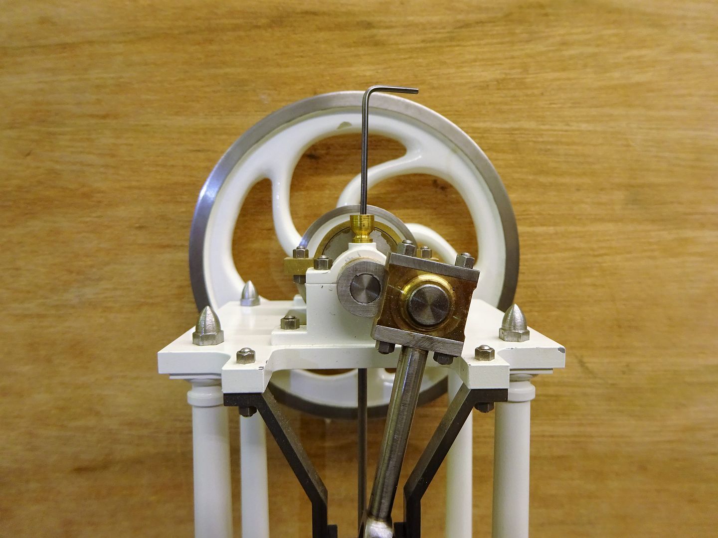

      Can any one point me in the correct direction for timing the eccentrics for this engine in its piston valve configuration ,as have constructed same opting for 7/16" bore's BUT the designer gives NO indication of just how to time the eccentrics ,Think I have managed to work it out that at TDC THe accentric should be 90 degrees in advance of the TDC OF PISTON , Can any one confim or denigh this for correct setting Regards Paul S

          It is usual for the valve to lead the crank by 90deg plus approx another 30degreed so the thickest bit of the eccentric would want to be at 4 o'clock when the crank is at TDC .
          You can reduce the angle to about 10deg if running on air but 30 works for both as a good starting point.
          here is one I did earlier though running anticlockwise as viewed so max throw of eccentric is at 12 o'clock where the allen key is and the crank at 4 o'clock but same setting as eccentric is 90 +30 ahead of the crank

            Many Thanks Jason thats re assuring as am in the right area just not enough / With that setting is the engine avble to reverse .ie;- inside outside admission on this small marine engine there is a steam reversing valve where in becomes out and vise versa
            #610066
              Ah, if you are using an air valve for reversing then you will probably to have go with no lead so just set the biggest throw of the eccentric at 90degrees to it's crank as you said in the first place. I was thinking of the slide valve version which you can't change air direction.

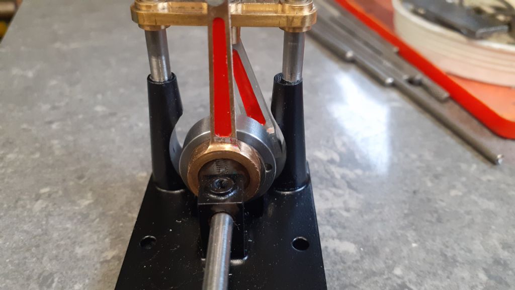

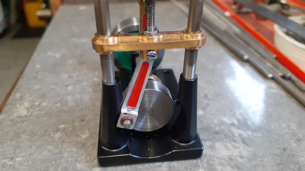

                As you were, I just tried it on my Gamages replica which has approx 30 & 90 so when the air is feed to the central inlet (inside admission) and it will only run in one direction. Feed air into the two exhausts (outside admission) and it will only run in the opposite way. Short video uploading.
                #610078
                  Rough and ready video as it was a bit of a job holding the two tubes, flicking the flywheel and holding the phone.
                  Starts off with air going to the two outer ports and engine runs anticlockwise.
                  I then change to air into the middle port and engines runs clockwise, try to flick it anticlockwise a couple of times but just wants to start going clockwise.
                  This is what you would want in a RC boat so that the servo moving the air diverter will give fwd & rev, being a twin cylinder you will get self starting.
                  This shows the max eccentric throw at the top and although hard to see the crank pin is at 4 o'clock.
                  Looking from the opposite end 4 o'clock becomes 8 o'clock but still that 30 & 90 diference to 12 o'clock

                    Many T hanks Jason for time & trouble in replying. So eccentric (max throw ) needs to be approx 110degrees in advance of TDC of piston , think another problem for Marcher is to much friction at the moment (Need running with electric motor) to bed all in , Then neeed to construct boat to fit her in possibly MIRANDA If i can increase size by approx 10-15 % just a little more involved than the IOM boats I usually construct , Many thanks Paul S
                    #610134
                      yes 110-120degrees.
