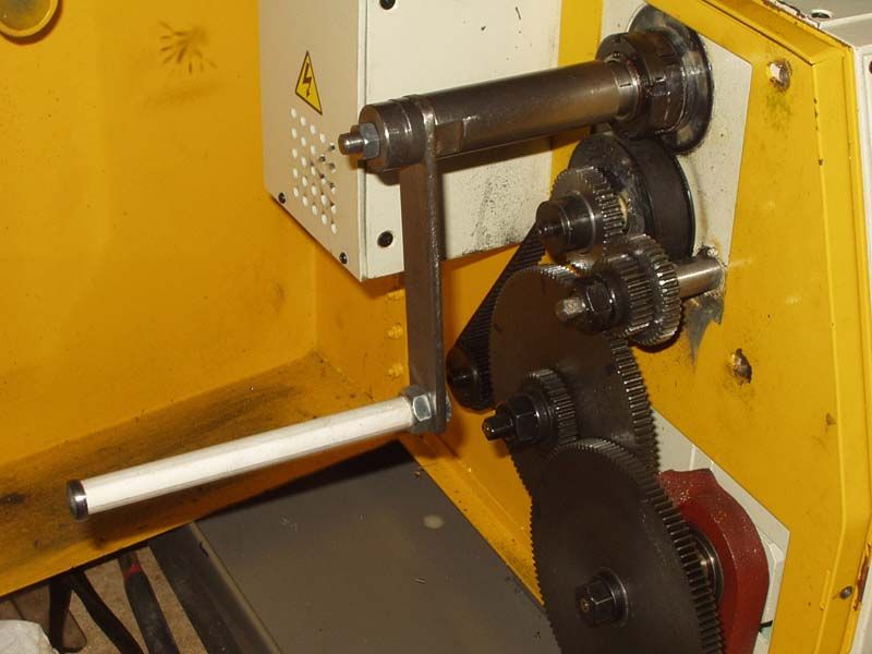

      Does anybody find these mandrel handels  usefull ? .  They are a great addition to any ones lathe . Mine is sprung Loaded for safety. Usefull when dieing down threads(not title threads) in use I always switch the m/c off . When cutting fine metric threads with M/C switched off i can lock  the handle .i close half nut take a cut buy winding handle bring tool  out leave half nut closed wind back take another cut . Feedback welcome

          With an Inverter drive, I reduce the speed to very slow and do the same but under power, with the S7 clutch I find I can judge the stop point very well. If you do not have an inverter, the handle is a good way of doing it, if a little tedious.

            Nobby, This is how I do my threading on spacers on my BH600.  I only have 1 thread for the undercut and often 2 threads for the job.  With female threads it would a braver man than I am. Even with inverter drive there is only 20 thou to play with.  I can’t rely on the drive to stop in 1/2 a turn.
            In my version the handle fits into slots around the circumference.  Down the centre there is an adjustable rod which I can use as a backstop.

                    this is the handle I made for my Chester Comet.
                    my lowest speed is 100 rpm so short threads are a no no under power.
                    It’s an expanding mandrel type.
                    as you can see I have to open the gear cover to fit it so turning the power off is a must.
                    Roy
