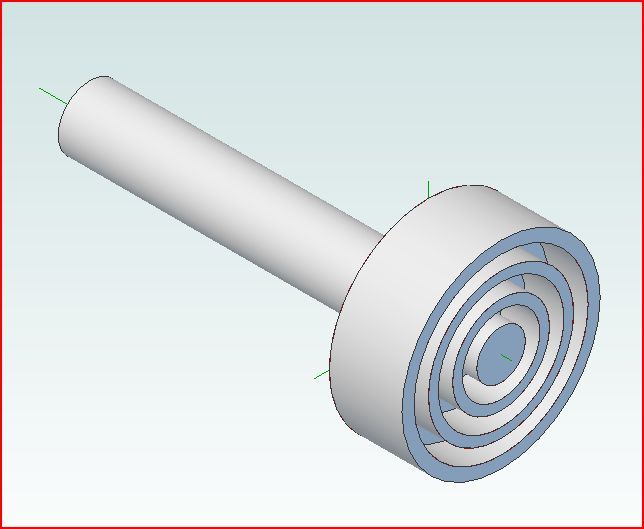

      I need to make a square cut groove that is around 8-10mm deep on the flat edge of a round bar. Like a "O" but i need 3 of them getting smaller.
      I thought a parting tool would be best, but now I have snapped to of them, i'm thinking maybe not!
      Work piece is an old large steel bolt head approx 41mm now its rounded off,
      Any tool that is deep enough to cut, while being small enough not to jam and snap as the cut gets deeper.

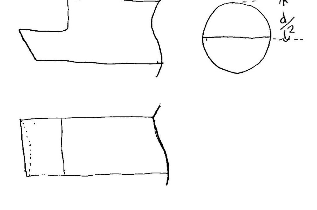

                  #130523
                    At that depth and width you may want something more rigid in which case grind something like this from a 10mm HSS blank

                    jason udall
                      @jasonudall57142
                      NEIL nice
                      'course I hadnt thought that ….
                      most I have used have been insert holders..with large ( about 45degree worth) keel for support ..which is what brought the hole saw to mind

                            #130549
                              Sounds like this is whats wanted
                              #130553
                              littlerick
                                @littlerick
                                yes thats exactly what i need… im going to get some tool steel and have a go at making a tool for the job.. main problem is getting it strong enough while at the same time shallow enough not to jam on sides..

                                Grizzly bear
                                  @grizzlybear
                                  Thank you JasonB for the picture, Impressive. We just need to know what its for. Branding mice perhaps.
                                  Regards, Bear..

                                  magpie
                                    @magpie
                                    41mm bolt head, will have to be BIG mice !!!!!

                                          Although these show the middle being trepanned out of a plate the tool is similar to what I sketched above except for the rounded end as that was left over from a previous use.
                                          This is 5/8" (16mm) brass cut 8mm from either side
                                          And this is 10mm steel cut just short of 5mm each side then hit it with a hammer and the middle drops out safely.
