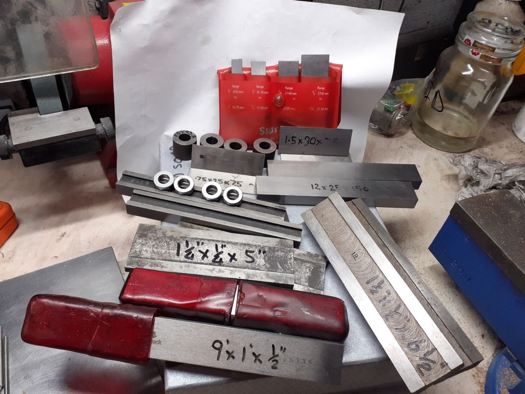

                            I have half a dozen pairs of HSS tool blanks which I use as parallels when required. I don't know how accurate they are, other than that my measuring kit shows the individual pairs as identical.

                                  I was given a large piece of 1/8 thick gauge plate,thin parallels are useful when setting small thin pieces of work up in the vice,I still work imperial, so if you have say piece of 1/4 square material and want to remove say 1/32 then what is required is a narrow parallel but with height 3/16 below the top of the jaws,so I made a series or pairs of narrow parallels where the height below the jaws was more important than width this allows me when dealing with standard stock to be able to set up this material with a good grip on the work with enough protruding above the jaws to allow machining,very useful fo machining parallel keys and similar work, A toolmaker friend used to use aluminium bar for parallels to save damaging small cutters,he just fly cut them in pairs,just make sure the vertical head is trammed truly vertical. Hardened and ground Industrial parallels were used as they maintain accurracy over years of use and withstand lots of beating down of jobs onto the parallels with a lead hammer,nothing wrong in using soft parallels.

                                    I have a selection of parallels which I have collected over the years. Although most of them are hardened and ground they are wide ranging from .75mm thick to 2 inch and some are buttons which are very usefull. I also hsve a set of adjustable parallels from Starrett which I bought when I was a bit younger and still use regularly to measure slots and use as parallels as well. The round button parallels are very usefull as you can bolt through them as well as spread them about to suit castings etc.

                                      Bearing outer races are good as ‘button’ spacers.
                                      #481264
                                      peak4
                                        @peak4
                                        Posted by not done it yet on 21/06/2020 11:19:00:
                                        So are inner races. I use both for squaring short items in 3 and 4 jaw chucks, rather than using straight parallels.
                                        Just select one a bit smaller diameter than the workpiece and wrap it in self-adhesive window draught excluder; the foam stuff on a roll.
                                        That way you can leave it in place, and it doesn't rattle whilst you're machining.
