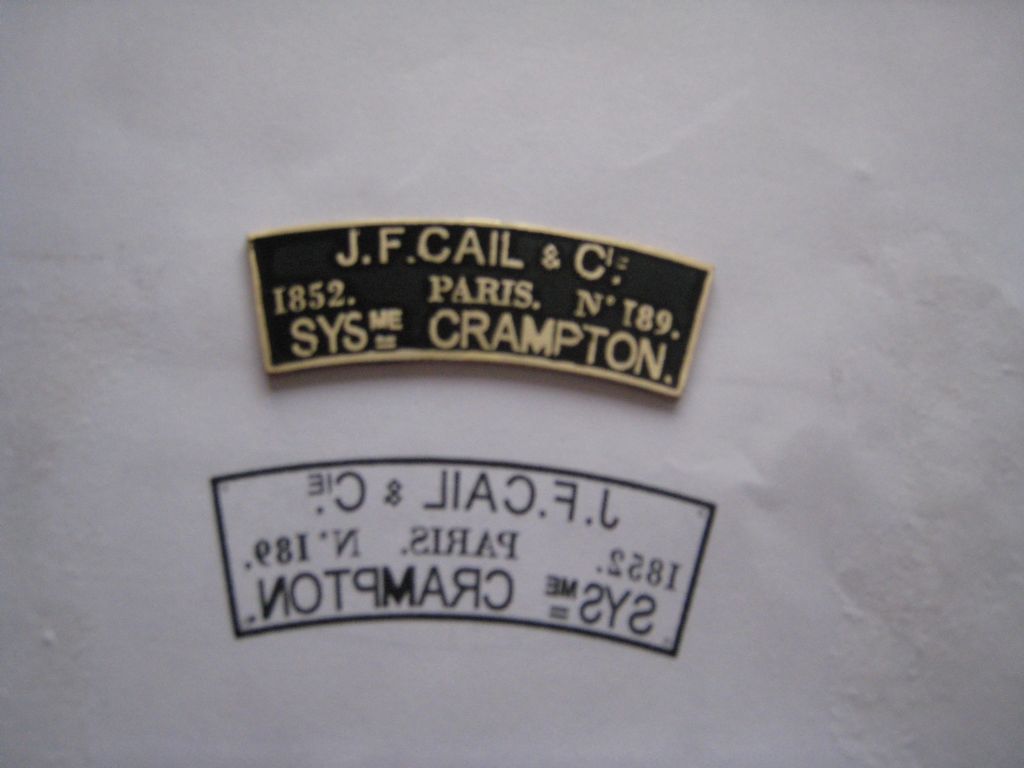

      Hi, I am trying to make the nameplates for my 5 inch gauge Crampton Locomotive ' Le Continent'. It's not a produced design so i can't buy a set. I've managed to create the artwork using Open Office. Photoshop would have been a lot better but I don't have it. I am using negative photo resist film which you can get cheaply on eBay . The difficulty I am having is getting it to stick successfully to the brass sheet. I think the correct temperature is 110 degree C. Using a domestic iron bubbles the material up. Putting the brass on the iron and heating it works better but not 100%. Has anyone any experience of this stuff please? Usually it's used to make pcbs and a laminator is used. I haven't got one to try that but anyway I think the problem would be it wouldnt go through slowly enough to heat the brass.

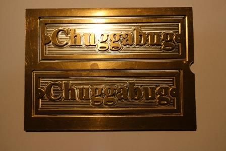

                        Another JohnS
                          @anotherjohns
                          FYI:
                          I made some for a friend by engraving from artwork. Did write this up for Diane, but article was probably too long and the software was free, so has not appeared in print.
                          In essence, I drew it up, saved it as a jpeg file, and sent it into LinuxCNC, which understands image formats and will engrave from that.
                          All I needed to get was some engraving cutters, From my album, the first results:

                            #400247
                            Stuart Smith 5
                              @stuartsmith5
                              The etched brass in my previous post is 28mm diameter.
                              #400249
                              John Rutzen
                                @johnrutzen76569
                                The engraved ones look excellent but they will need cnc software? Did you get them done by an outside firm? I wasn't quite sure whether you did them yourself?

                                #400346
                                John Rutzen
                                  @johnrutzen76569
                                  Hi , I've got a photo of a finished one but can't figure how to upload it? I'm using a macbook. Any ideas please?

                                    John Haine
                                      @johnhaine32865
                                      I engraved these for a member here…
                                      Will PM you.
                                      #400356
                                      John Rutzen
                                        @johnrutzen76569
                                        #400357
                                        John Rutzen
                                          @johnrutzen76569
                                          As you can see the result isn't professional quality but it's adequate for my model. My son did the artwork on Autocad but it took him a long time and he's good at it!. Unfortunately the only way we could reverse it and get a negative was by taking a screenshot an using that so we lost resolution.

                                            Posted by John Rutzen on 14/03/2019 14:21:30:
                                            Not sure about AutoCAD, but most CAD tools create text in blocks of fixed characters specifically so you don't get a negative when you mirror the block. It ensures text always remains readable, which is usually what's wanted.
                                            Everything else can be mirrored, and an efficient way of producing a symmetric object is to draw one half only and to create the other side with a single mirror command.
                                            To produce a true negative of a word you have to first select the text and Explode it . (Explode converts complex objects like text into their component arcs and lines.) Once broken into parts, reselect the whole lot and mirror that. As the components are now ordinary arcs and lines, they should mirror as wanted.
                                            Of course once text has been exploded, you can't edit it as text any more. Double check spelling!

                                              Wingo
                                                @wingo
                                                With Autocad there is a setting to control if text is mirrored or not when using the 'mirror' command on objects.
                                                On the command line type MIRRTEXT and change the value shown, that will then allow the text to be mirrored. Change it backl to prevent mirroring.
                                                IIRC value 0 gives No Mirroring and value 1 Mirrors the text as well as the object.
