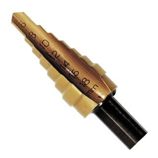

                Paul Lousick
                  @paullousick59116
                  Step drills are designed for making holes in sheet metal. Available is a range of sizes. Drill to nearest hole size and finish by hand with a round file if necessary. (Hole size can also be enlarged with a taperred reamer).
                  Paul

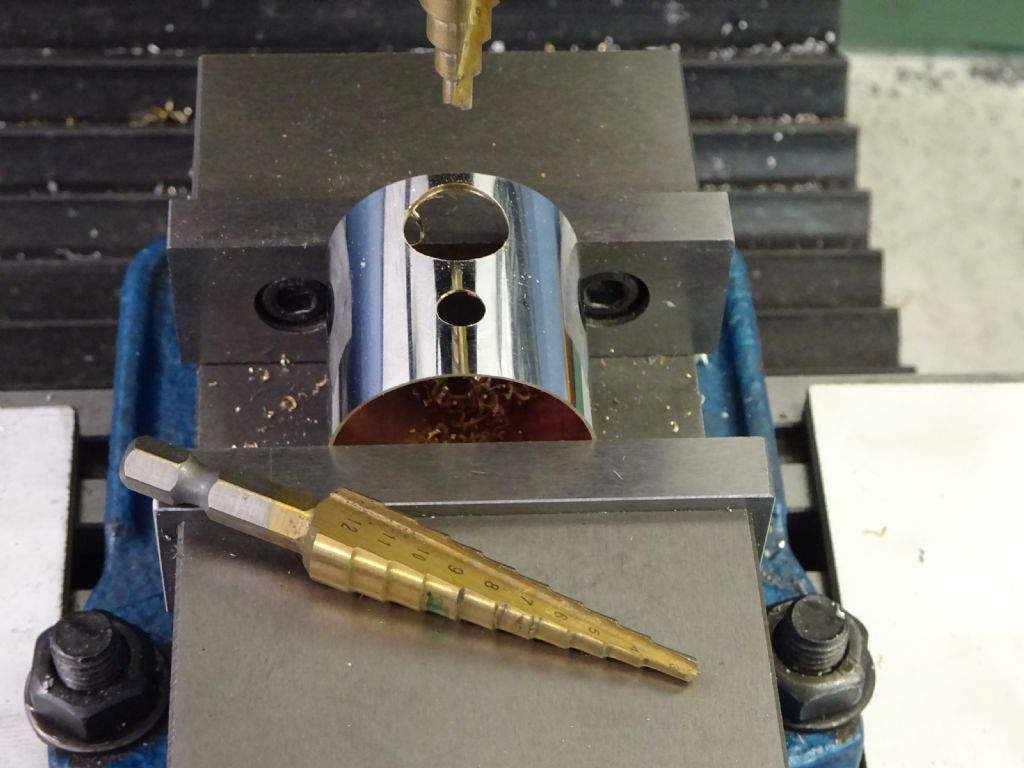

                                      #405773
                                        Step Drill for me, think the one at the back in this photo was 16mm, if you need a really accurate fit then do the last step with the boring head – sharp tool sped as you would if turning 18mm dia in teh lathe but may have to be less if the head is off balance.
