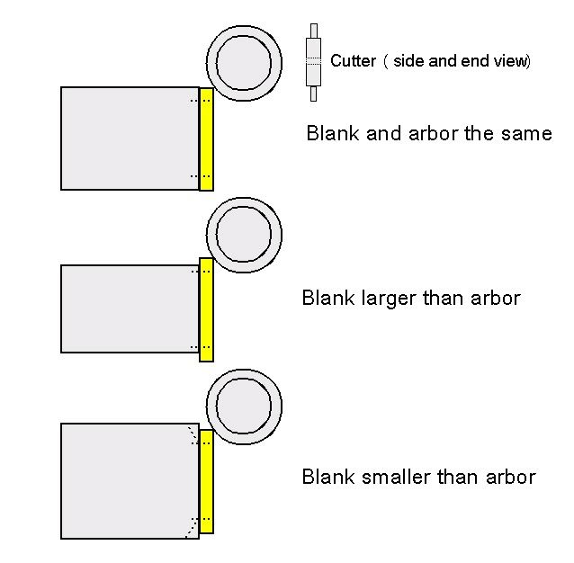

      Hi NDIY, this is a difficult one to describe …
      The cutters will be PP Thornton or similar and the profile of the cutter 'side on' is the shape of the tooth and then it thickens out for strength. If the arbor is larger than the blank the cutting action back and forth across the wheel will see more resistance as it meets more aluminium that it needs to do.
      Likewise if the arbor is less than the diameter than the lowest point of the tooth there is no back resistance as the cutter passes through the brass only and providing the arbor is not dramatically less than the tooth depth will still provide good support for the cutting action.
      If the arbor to be identical in diameter to the wheel OD so it gives full support, does not resist the cutter more than necessary and given the two metal sandwich will help reduce cutter burrs.
      I still tend to keep it just a bit less than the full wheel diameter so I can see what is going on with the rear face of the blank and know that the cutter is going all the way through.
      This probably needs a picture to make sense, I'll knock one up and post in a minute.

      Alan Wood 4
        @alanwood4
        Apologies for the size and the generic nature. The side view of the cutter is also generic but if the arbor is larger than the blank you will get the 'thicker' section of the cutter impacting on the arbor.

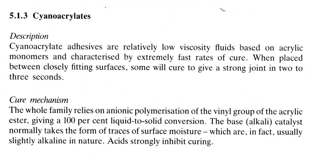

                  #443349
                    Posted by Alan Wood 4 on 25/12/2019 12:58:45:
                    Bill suggests that standard single applicant SuperGlue goes off better at an air interface. (At the time of his authorship twin pack SuperGlue might not have been readily available). Bill postulates that having the grooves in the end face of the arbor increases the net length of air interface and therefore makes the bond stronger.
                    I would be genuinely interested to see the source of that idea … Could you please quote a reference ?
                    Although 'superglue' is a much-used, and therefore largely meaningless term; in my limited understanding, the behaviour of cyanoacrylates is quite different to that stated.
                    My 'go to' source of information about such sticky subjects is:
                    'Adhesives in Engineering Design' by W.A. Lees
                    [ Bill Lees has a legendary status, way above Granny ]
                    His general description of Cyanoacrylates starts thus:
                    Perhaps the behaviour is very product-specific, but I think you will agree that the two 'models' differ greatly.
