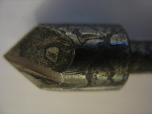

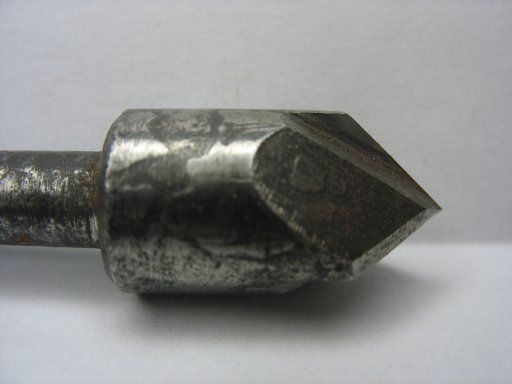

                  Countersinks – if you look at GHTs book he offers advice on countersinks – and recommends, effectively a pointed D bit. He is dead right, they cut beautifully and NEVER chatter  -and a touch easier than 3 lobes to make!

                                      Now, if I can work out how to do it, I am about to post two pictures of the countersink which show the “inclusions” (for want of a better word). Your thoughts would be most welcome, especially if it’s due to overheating.
                                      Hooray, done it!   Which just goes to show that one CAN teach an old dog new tricks!
                                      Regards,
                                      Peter G. Shaw
                                      Ok edit no.1 Apologies for the quality of the photos. The camera is a Canon Powershot A610 used in Auto mode, Macro, and flash turned off. And handheld!  Photographer I ain’t.
                                      Edited By Peter G. Shaw on 20/02/2010 21:12:45

                                        Hi Peter
                                        Yes I think that would be fair to say slightly on the rare side of well over done! But it works – which is the main thing.
                                        Probably a little high temperature but more likely under the heat for too long. Meyrick can probably tell us the technical reasons – in laymans however by over soaking you bring the carbon to the surface and it oxidises.
