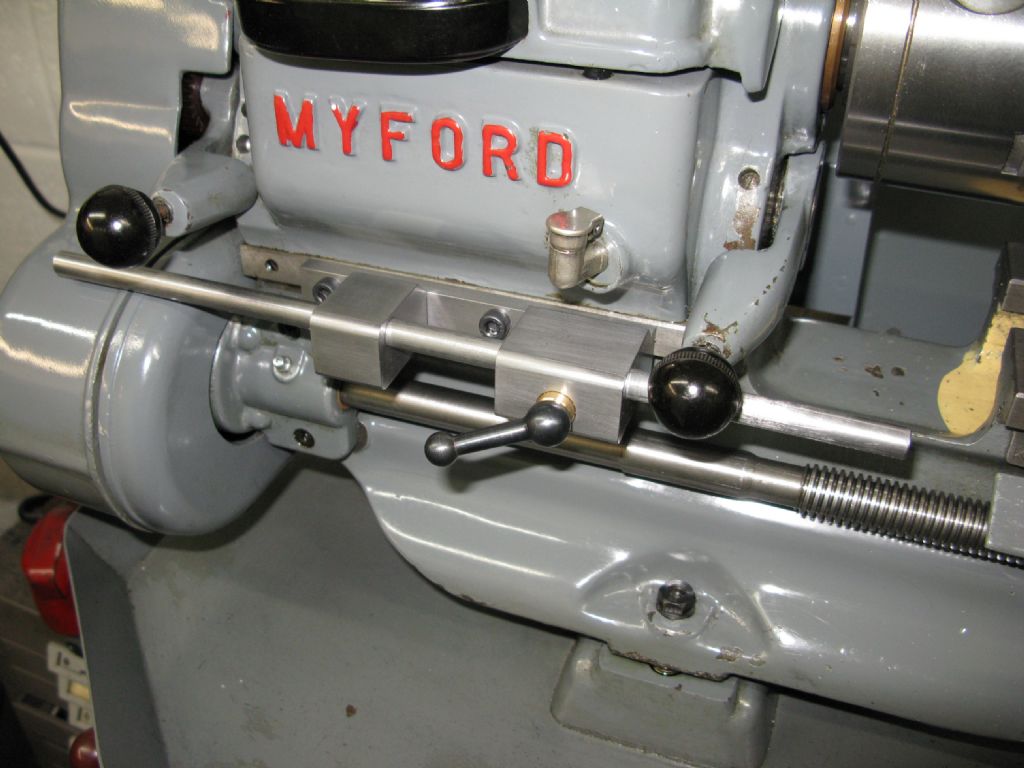

    Steviegtr
      @steviegtr
      I have just made a adjustable carriage stop for the Myford Super 7 lathe.. I am sure it could be adapted to fit any lathe. Please any forum members that think this is rubbish or not suitable for purpose. Please comment & tell me why , or what would be better.
      I love criticism.
      Steve.

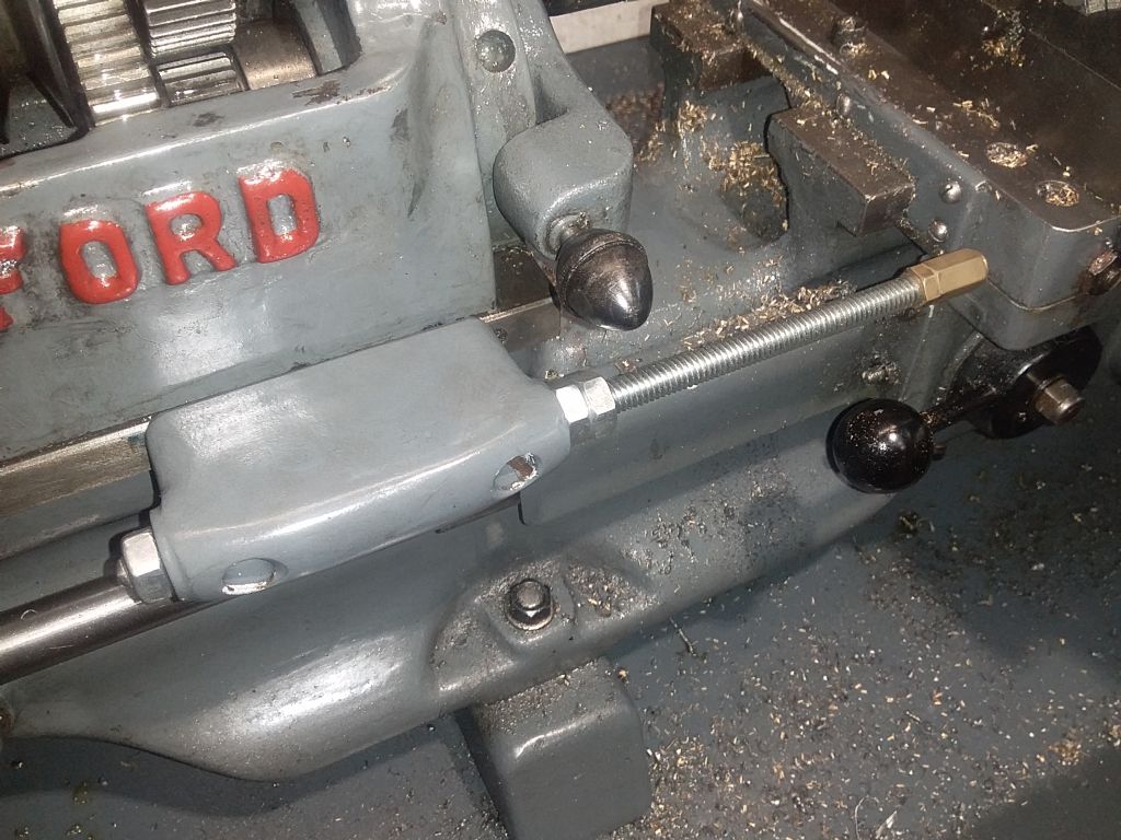

                  Hopper
                    @hopper
                    Wow. Attitude much? It's a wonder you keep posting when things are that bad!
                    Criticism? Well, like such videos in general, 25 minutes of talking head waffling and tedious video of basic turning and drilling in the lathe and we get to the end and …. it's not finished yet! And we still don't know what the finished product looks like, and thus whether or not we might like to make one. "Wait for part two." You have got to be kidding. All this time invested — 25 minutes so far — to find out how you made a carriage stop, when the very simple concept could be grasped in 2.5 seconds via a photo or drawing of the finished item.
                    Here is the Myford carriage stop I made a few weeks ago, used for putting the calibration marks on a resettable cross slide dial I was making. The first pic of the basic "makings" showing the basic principle. Second photo showing the finished item after "tarting up". 2.5 seconds to grasp the basic principles and see how to make your own very simple version.
                    Technical details:
                    • Made from a bit of 20mm x 50mm flat bar about 75mm long. A 5/16" hole drilled lengthways for the piece of 5/16" threaded rod to pass through. Three nuts used to set position as shown.
                    • Two holes drilled and counterbored crossways to fit 1/4" BSF socket head cap screws. Screwed into one existing gearbox mount hole in the bed. Second hole spot drilled through the stop body and tapped 1/4 BSF to suit.
                    • Bit of brass hex bar turned and threaded to fit on the end so it's a bit kinder to the carriage where it hits.
                    • Shaped body on belt sander to make it look like an original casting.
                    • Painted with Bunning's cheapest Machinery Grey rattle can.
                    • Further extensions can be screwed on by replacing the brass hex with a builider's 5/16 joining nut, used to join two lenghts of threaded rod together when hanging suspended ceilings etc. Stop can be set all way to the left out of the way when not in use.
                    • End of.

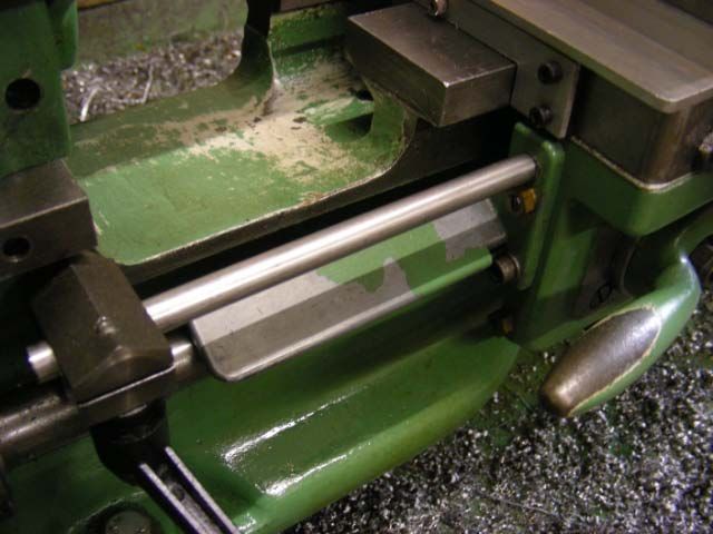

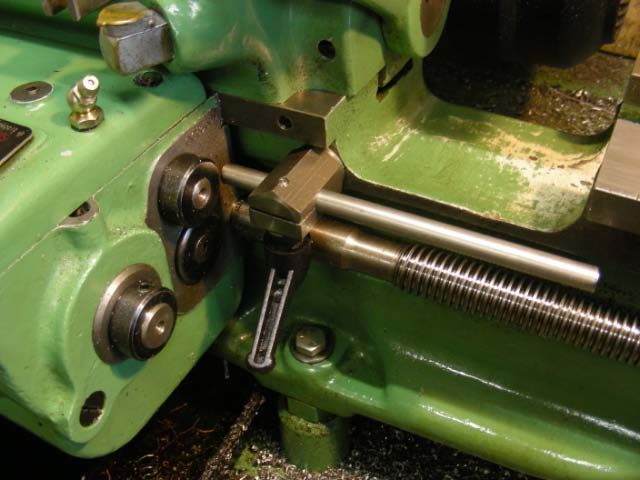

                        Dave Wootton
                          @davewootton
                          Hi Chris
                          I haven't got any clever ideas for turning the machine off to prevent a crash, although I have used lathes that had a microswitch arranged to cut the power if the carriage reached the headstock ( Smallpiece Cromwell S800).
                          But I do use carriage stops all the time, and so far have not had any disasters, I attach a picture of a simple adjustable carriage stop I made when I had an ML7-R , the stop rod is locked by GHT Thomas's pet split clamp arrangement which will slip if it all goes wrong. I made two of these, one for a friends S7 who being quite new to the hobby was worried about a jam up and damaging the fibre feed gears. The stop rod in the one shown is 5/16" diameter , but for my friends the rod was made 3/8" diameter and drilled to take a smaller rod ( 9/32" from memory) so that this rod could telescope into the larger rod, It was cross pinned with a brass shear pin, again from memory 3/32", so in case of a disaster the shear pin would break allowing the stop to telescope and prevent damage. The size of sacrificial shear pin was entirely empirical, we started with 1/16" which sheared too easily and 3/32" seemed about right. My friend tells me it has been tested twiceand has worked!
                          I have not got a photo of the shear pin one, but attach one of the version on my machine, it required careful positioning to avoid the back gear lever. Obviously this is for a non gearbox machine, but the shear pin principle can be adapted to many other stop designs. Hope this gives a few ideas.001.jpg

                                Hopper
                                  @hopper
                                  Posted by JasonB on 20/02/2022 07:15:29:
                                  Well that is one advantage of Steve's over Hoppers. If you were to run the carriage into Steve's stop too hard the bristol lever would likely allow the stop to slip rather than hitting Hoppers solid stop.smiley
                                  Edited By JasonB on 20/02/2022 07:15:54
                                  As I said in my post, my stop was made specifically for the purpose of putting the graduation lines on a set of resettable dials I was making for the Myford. It is designed NOT to move under impact so that the 100 small impacts as I put the 100 marks on each of the four dials I made will not result in the lines gradually getting longer as the stop moves.
                                  If you want a less solid stop, its just a matter of replacing the threaded rod and nuts wilth a piece of plain bar and putting a grub screw or clamp handle like Stevie's or Dave Wooton's examples.
                                  But my point was not how to make a stop. It was how the information could be grasped in 2.5 seconds in a couple pics and a paragraph of text, vs 25 minutes of video, to cover HALF the job.
                                  FWIW here are the gradaution lines, below, on one of my dials the stop was used to cut. I went around the circumfrence once with the stop set for the short marks, missing out every fifth mark. Then advanced the top slide by the 30 thou to make the intermediate length marks at the un-numbered "5" points. Then advanced the topslide by another 30 thou to go around a third time and do the 10 long marks at the numbered "10" points.
                                  Much quicker and easier to keep track of than the traditional method of varying the length of lines every fifth line, then going back to the default short setting then back to the longer after another five lines and so forth. I had the job done in a matter of minutes for each dial. This method also means you are using the lathe bed and carriage to "plane" the marks on the dial, not some dicky little shopmade graduating tool that always has slack between the body and the plunger, which is exaggerated by the lenth of the toolholding bar and results in inconsistent depths of cut. This way, the cuts are as consistent as your lathe's main bed and carriage.
                                  As far as the safety factor of not crashing into a carriage stop under power, goes, the Drummond M Type has that beat. A leadscrew dog clutch with an actuating bar running the lenght of the bed, with an adjustable trip that can be set to disengage leadscrew at any point. Brilliant on long jobs. Set it up, set your cut going on a long job an walk away confident the feed will stop at the set point. Lovely! The ML7 was a step backwards.
                                  My next job is to make one for the ML7 because I got so used to it with the Drummond I consider it essential. Handy too for disengaging the change gears quickly so you can use the leadscrew handwheel, which if you don't have a QC gearbox is a right PITA. I will do this by making an  ML10-style dog clutch consisting of a sliding sleeve over the existing leadscrew. with a couple of driving pins and slots. Then add the bed-length "knock bar" and actuating trip that gets knocked by the advancing apron at the set point.

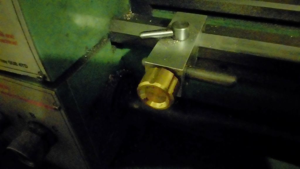

                                        #586402
                                        Nick Wheeler
                                          @nickwheeler
                                          And here's mine for a WM250:
                                          I made that a couple of days after getting the machine. It's 1" aluminium bar, with a notch to fit over the bed, a pinned clamp plate operated by the lever, and a sliding rod clamped by the brass knob. 7 years use suggests that steel would be better as the aluminium has spread. The rod adjustment was a waste of time, because there's no sensible way of adjusting accurately, and adding/removing shims is not going to happen. It was intended to be easy to make from stock I had, and to never need a tool in use which is always a requirement for me. It means I use it most times I turn on the lathe.
                                          I might modify some of the micrometer adjustment designs for my machine later.

                                                      Good news, there's much to like in Steve's video, and I didn't see anything unsafe! I particularly like his slow Yorkshire presentation and the absence of camera wobble and other common production faults.
                                                      Many improvements possible though and Hopper's list of basic story telling tips from a media professional are spot on. By applying them, I think the whole Carriage Stop story and design could be done and dusted comprehensively in under 20 minutes.
                                                      I did wonder which audience Steve is aiming at? The title 'Myford Adjustable Carriage Stop' strongly suggests a practical project for Myford owners advanced enough to know what a carriage stop is. However, the video's content often veers into 'explore the workshop' and 'basic introduction' territory. All interesting, but not mixed together! An improvement would be to edit out irrelevant stuff like the stickers and unfocussed comments like 'lot of letters printed on it', and 'we're not in a hurry, well I'm not…' A script would tighten up the commentary. I prefer to talk to a bullet list: they keep me on topic and allow ad-libbing. Scripts make me sound wooden.
                                                      There are a few mildly unfriendly items that might confuse beginners:
                                                      • Using random scrap is generally a bad idea because not all metals machine well. In fact many alloys are horrible. Giving newbies the idea that scrap will cut OK on a lathe is unhelpful. I'd make the Carriage Stop out of free-cutting mild-steel. Instead, Steve goes for a work-hardening Stainless that becomes "red hot" and mentions two other difficult metals – Titanium and Phosphor Bronze. The project is based on metal he happens to have rather than metal selected to do the job. Working with awkward materials is a video in it's own right.
                                                      • When turning stainless (with an interrupted cut!), Steve says he doesn't know what the correct speed should be. The video would be better if details like that, and the unfinished plan, were sorted out before filming started.
                                                      • The implication that a DRO Tailstock is necessary is misleading. Nice to have maybe though I've never felt the need.
                                                      • Flipping the hex bar in the 3-jaw chuck at about 12:45 causes an avoidable mismatch where the cuts meet. Not the end of the world, but misses the chance to discuss whether or not it matters, and what to do if it does! Being lazy, I'd have dodged the interrupted cut and chuck flipping error by not rounding the hex bar off at all.
                                                      Certainly not rubbish!
