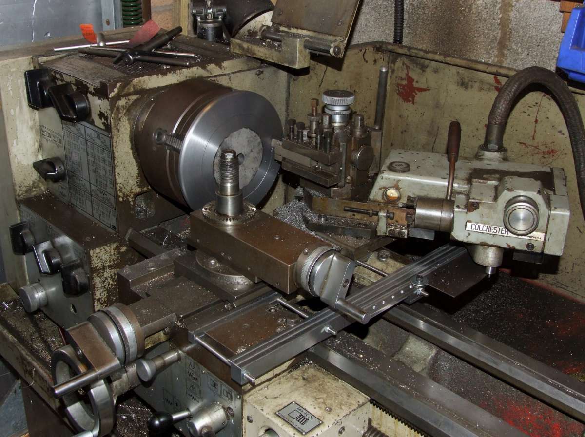

              It might be too much work for a one off, but attach a 3 degree tapered wedge to the cross slide and a bearing stop fixed to the bed. Then as you traverse the cross slide, the carriage will move longitudinally. Either use hand pressure on the carriage wheel or a string and weight to keep follower and template in contact.
              It is no different to a longitudinal template-follower process, just at 90 degrees to the normal direction.

                #798579
                Julie Ann
                  @julieann
                  On DC31k Said:
                  ….no different to a longitudinal template-follower process, just at 90 degrees to the normal direction.
                  Like this:
                  2018_08070012
                  Note the home made bracket and template on the saddle.
                  Julie

                          On milesincam Said:
                          Not sure what the Colchester item is on the right, though…
                          It is a Hepworth hydraulic copier, also called a hydraulic tracer. Tru-trace was a US manufacturer of similar.
                          You may recognise it from here:
                          Hepworth Lathe copying attachment
                          On YT, Keith Fenner did a good video of his:
                          Can also be seen in action in the Colchester Lathes video (the background music should have been ‘ring my bell’ by Anita Ward):
