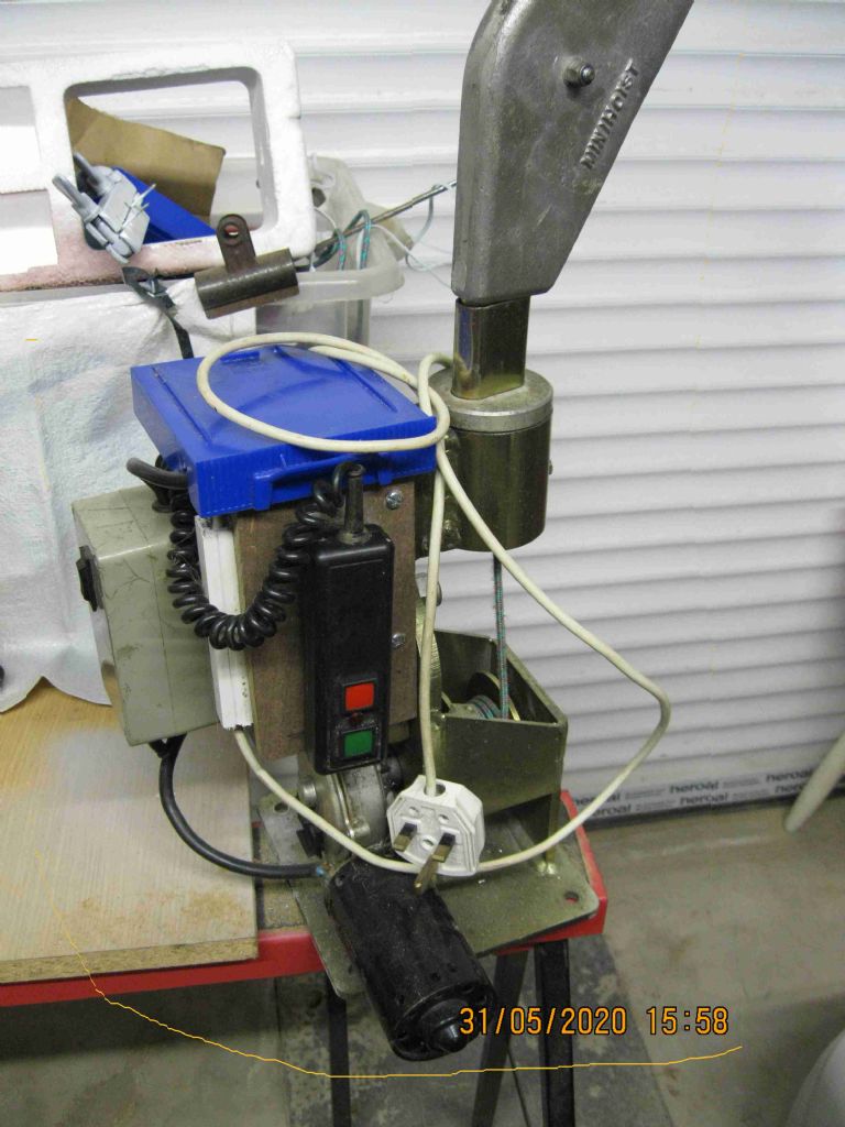

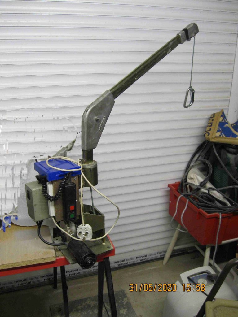

      Just noticed this thread.
      The photos below show a bodge modification I made to an ex-car hoist for mobility scooters.I had to do a bit of rewiring and incorporating a transformer power supply (RS variable output). The base is 7" x 7" x 1/4" steel with corner holes for attachment. Original s.w.l. was, apparently, 160kgs (?) so probably OK for chucks etc. Not sure if I'll get round to installing it.
      rgds
      Bill

      Clive Foster
        @clivefoster55965
        Nice job Bill.
        My feeling is that something of that ilk fitted to a work cart would be far more generally useful than something that needs to be specifically set up for each job. Sufficient reach to handle a lathe chuck or vice – dividing head – rotary table on the mill should be no problem.
        On a rolling cart it also becomes very useful for the "really a two man lift" or "20 (30 in my case) years ago I'd have lifted it no problem" things. Several backs of envelopes and a couple or three years into the thinking I'm reckoning that something very similar with folding jib to get things out of the way when the cart is normal use and using my battery impact gun as the power source is plausible way to go.
        In a practical world 150 lb or so lift ought to be plenty. A tolerance ring can make a nice emergency overload clutch.
        As usual with like to have, rather than need it now, jobs feature creep and design refinements are getting in the way of do-it now. Fact is if I knew I wanted one on Thursday it would be done tomorrow. But for now I keep noodling.
        Clive

            Cornish Jack
              @cornishjack
              Thank you Clive.
              Your suggestion re. the rolling cart is a 'bulleye'! Even I ought to be able to rig up something suitable. The obvious potential 'gotcha' is the counterbalancing but I shall consider … and, no doubt, procrastinate!
              rgds
              Bill

                Clive Foster
                  @clivefoster55965
                  Bill
                  Considering the seemingly "permanent" contents of my work cart counterbalancing oughtn't be a problem for me. If more than half the top tray is clear I hear muted screams of "turn off the light". Two shelves and three drawers in addition to the top tray are seriously tempting. My version of Pooh Bears "useful pot to put things in". Appropriate I guess as Ashdown Forest is only a couple or three miles away.
                  Seriously a paving slab bolted underneath at the opposite end and a bit of orientation intelligence in use should suffice.
                  One thing that has hung me up over the design is wanting a longer jib so the crane can be used extended over the cart if anything hefty has to be lifted. But then it needs an extra fold so the hook can be set close in when working away from the cart. Do-able but I'd rather not have a 3 ft double pole sticking up on one corner. Then there is the controlled adjustment needed so whats been lifted can be dropped on the cart. Overthing, yup.
                  Clive

                            Cornish Jack
                              @cornishjack
                              Clive – Thank you again for the 'mental nudge' re. counter-balance mounting. I have just the sort of thing you describe – ex commercial, foldable metal trolley on casters, covered with 'come-in-handy' items of considerable weight. Managed to 'clear a 7" x 7" space in the top shelf corner and the swivel boom swings to stay within the trolley outline. Sorted!
                              Once I get it bolted down, I'll take a piccie.
                              rgds
