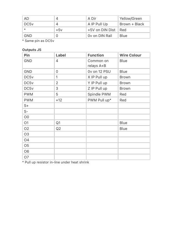

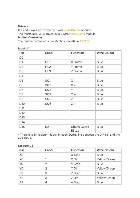

            I converted my KX1 to run Linuxcnc and in the process traced most of the electronics.
            The USB card is a Leafboy77 AKZ250, details still on their website here:
            https://leafboy77.com/?page_id=25/#downloads
            As well as the schematics the manual is quite useful as it gives explanations of the inputs and outputs.
            The following pictures are the pinouts as I traced them ( I couldn’t find a way to easily post a pdf ).
            Keith
            AX250-1
            AX250-2
            #848461
            Steve Withnell
              @stevewithnell34426
              Thanks Keith,  good stuff there.
