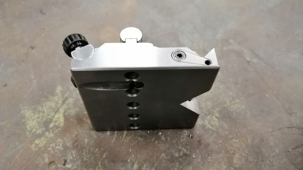

      Strap clamps can get a bit high with the raised clamp knobs sometimes well above the workpiece. This system uses pivoting, sliding clamps with the clamp knob below the clamp top allowing easier access for tooling. The main body incorporates a vee + step + pivoting detent end stop for accurate part location. A separate movable arm can be locked in any position along the centre of the vee for drilling through the centre of a bar. The video shows grinding, drilling & milling operations on small parts of different shapes & in various materials. This principle can be scaled or lengthened to suit smaller, larger or multiple components.

                        How did you machine the profile of the clamp base?
                        Martin
                        #661394
                        Greg Webb 1
                          @gregwebb1
                          I machined the profile on a thicker piece of mild steel on a CNC mill. The excess thickness was then removed in two halves on a manual mill using the side of an endmill with the finished face against the fixed jaw. Then it was surface ground to thickness on both sides.

                            It was the return part of the "shaft" feature that had me foxed. It looks like quite a reach if you are machining that in steps.

                              Sorry Martin I am trying to post an image from underneath that should explain how it works but I can't. Any tips on pasting?

                                  That was a bit of a faff to sort out, hopefully the new software arrives soon.
                                  So you can see the holes underneath for 5 – M4 cap head screws that go through the base & key then into tapped holes in the bar.
                                  The elliptical hole is tapped for a sprung loaded ball grub screw that clicks into the vees on the stop shaft. This allows the stop shaft to rotate without losing its position as demonstrated in the video.

                                    Thanks for taking the time to post the photo. Everything clear now! Very nice design, well executed.
