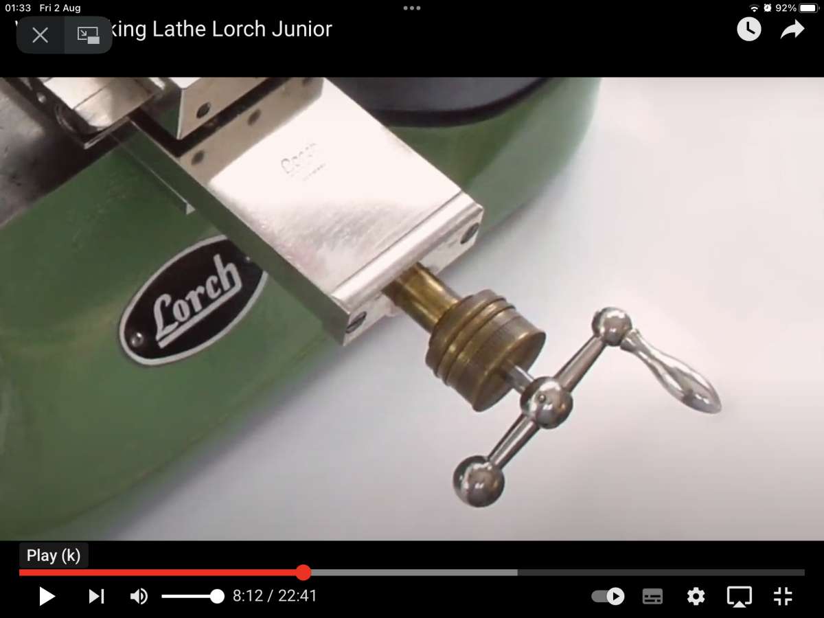

                      To add to your confusion … have a look at this demonstration of the magnificent little Lorch Junior in use:
                      https://youtu.be/R908ONfI-yo?feature=shared
                      Frame-grab:

                        See also the text describing this Junior:
                        https://pennyfarthingtools.co.uk/lorch-junior-8mm-watchmakers-lathe/2017/01/11/

                          Always glad to learn… So, likely to be original. Strange – I wonder why?
                          #744672
                            Regret to say, I have no idea
                            … my own little Lorch has no mechanical slides.
                            Almost certain that the direction of action, and the use of [perhaps bronze?] is standard for small Lorch lathes though.
