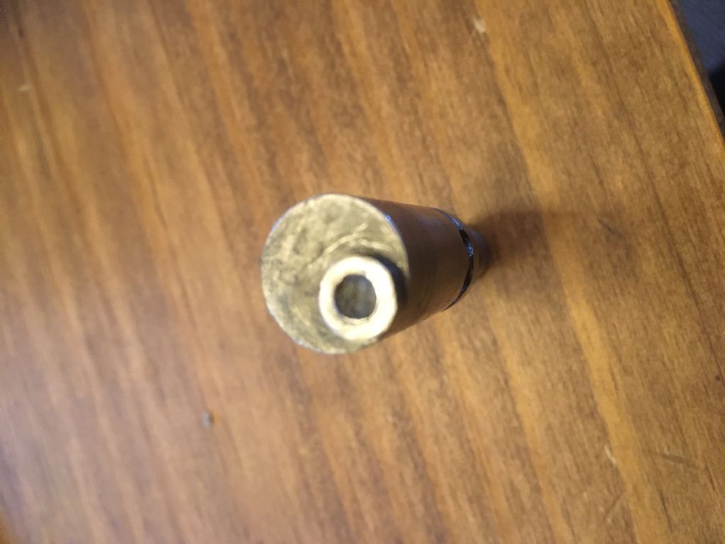

      Has anyone out there got a Lorch LAS Lathe ? I'm in the process of rebuilding a 1960 LAS. I'm looking for information on the selector shaft bearing arrangement, mine was snapped and the bearing missing on the end when I brought it.

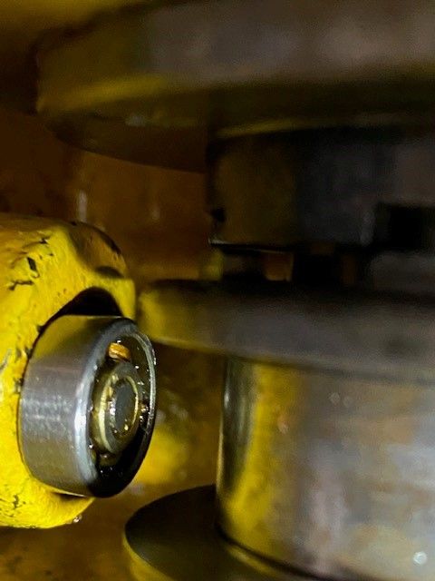

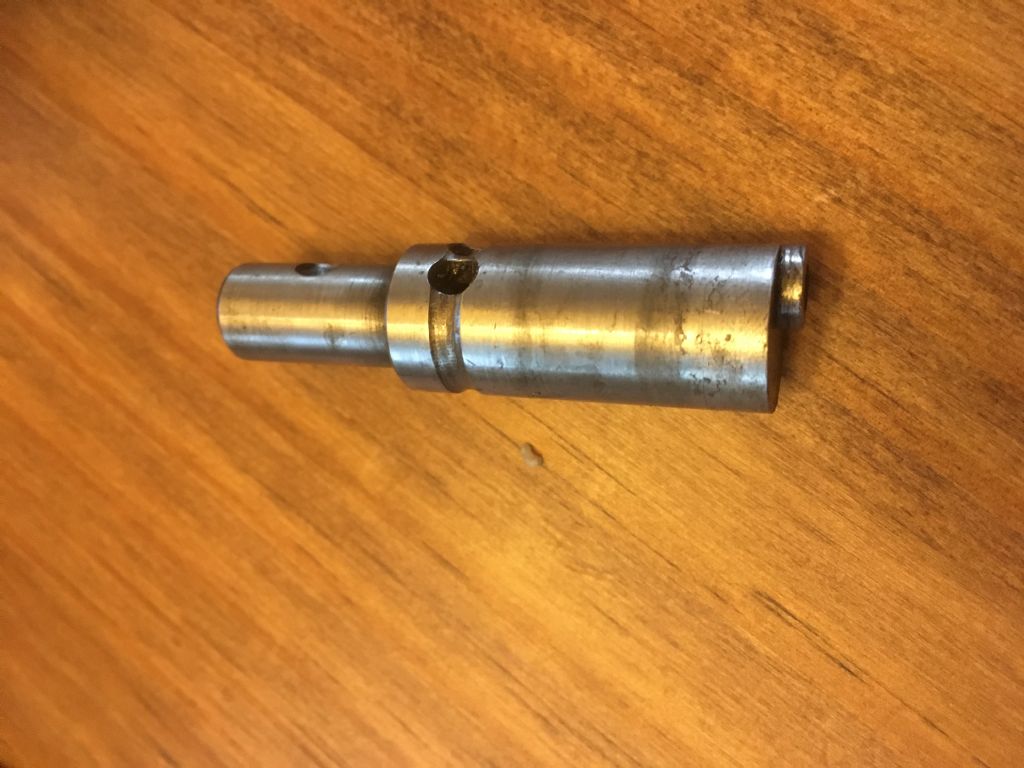

            lorch las broken selector shaft (2).jpglorch las broken selector shaft (1).jpgHi Jon, yes I did see that post. I will see if I can get in touch with Adam.
            The "select shaft arrangement" yes its that part. Where yours has a least an inner race, mine has sheered off the 'cam' part of the shaft that the bearing attaches to, so I'm going to have to make a new one. Do you have any pictures of your arrangement that you could share with me please. Here's mine if the pictures attach.

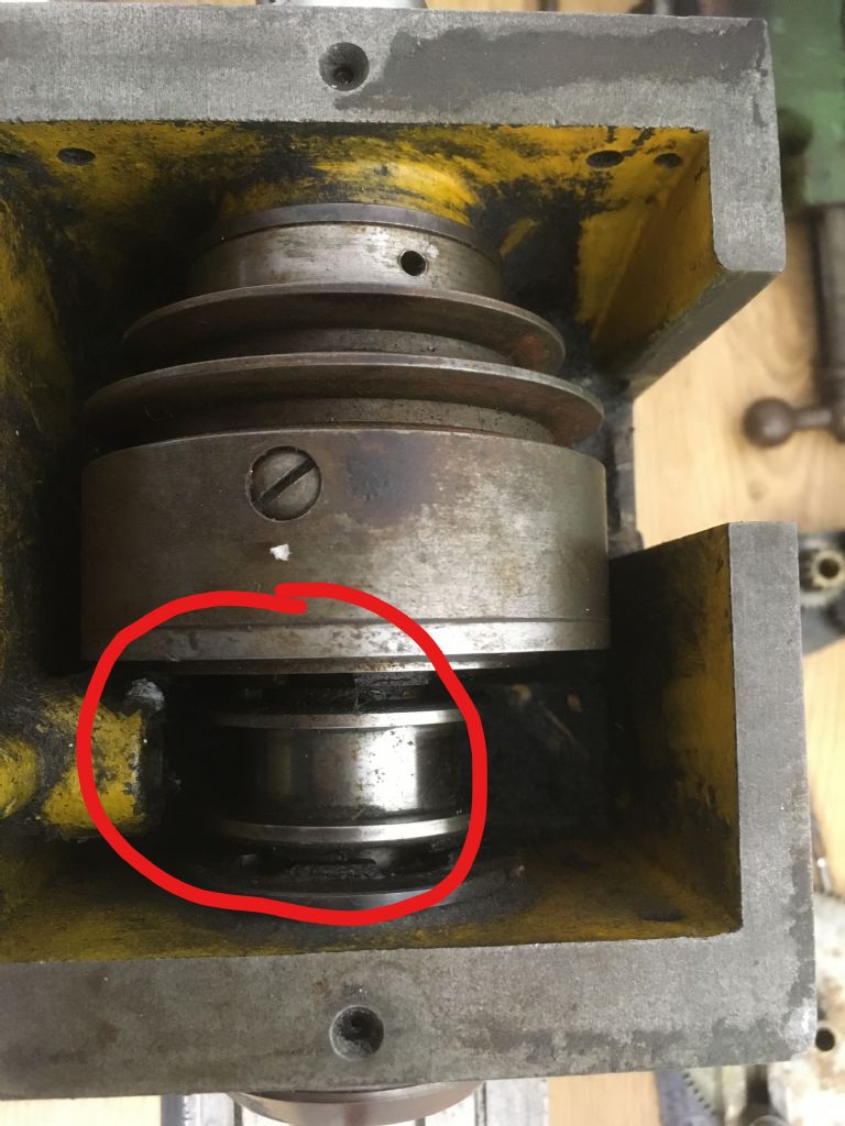

                Here's a couple of pictures (hopefully) of the backgear selector on my LAS. The bearing appears to be just a press fit on the eccentric but I didn't want to remove the whole spindle to take the shaft out for a picture sorry.
                Hope that helps

                  The inner race on mine was reasonably easy to slide off the spindle – a slight friction fit. The bearing really cannot go anywhere once the spindle has been locked.
