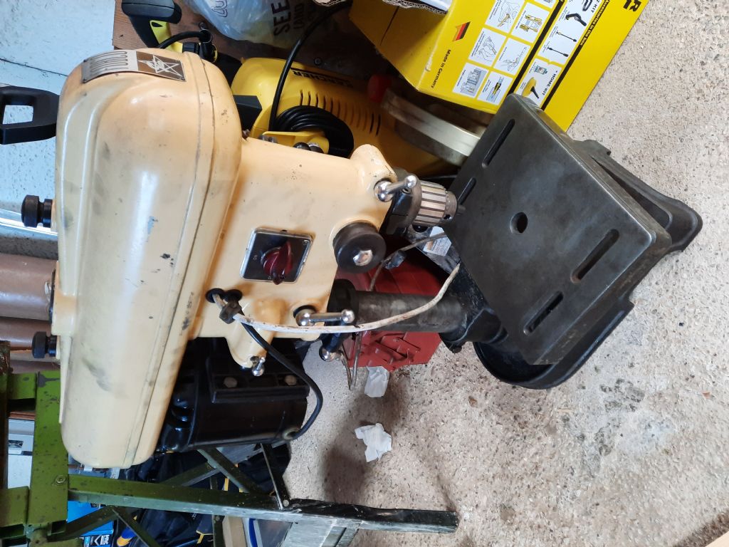

      Hi all
      I've recently purchased a Fobco Star bench pillar drill which is in very good condition and overall I'm very happy with it. However I've just noticed the large table (which I believe is from the floor standing version) is loose on the column despite me tightening this to the best of my ability! It's only slightly loose and can be tightened sufficiently with the aid of an round tube acting as an extension to the handle on the table.
      My question is is there anything which can be done to rectify this or am I stuck with it?

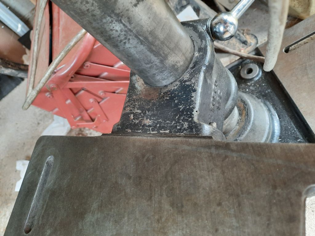

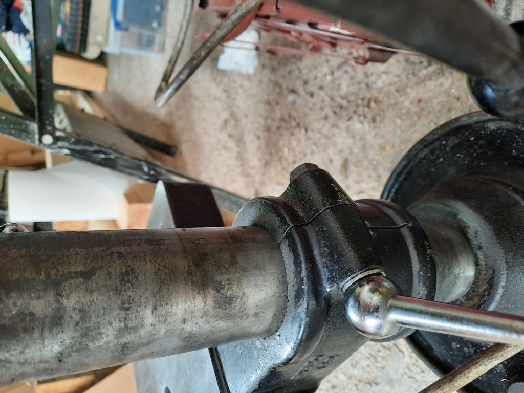

                            20220611_121440.jpg20220611_121449.jpgSo I've managed to take a few more photos of the mechanism to secure the table. I cannot see any perceivable gunk clogging up the split
                            Dave, the table does wobble when wiggled from the front. Using my caliper I measure the column at 54.97mm throughout, indicating no specific wear spots. Looking at the table I believe the hole is probably between 10 -20 thou too big 😪

                                Just measured. Clamping my Fobco table closes the slot by 0.008" to 0.010" so if your hole over-size is much above that figure then clamping is going to require a lot of torque on the handle. As said, there is a possibility of fracturing the casting assuming, as probable, it's cast iron and not cast steel..
                                Although not a simple solution. it might be feasible to put a split-clamp through the casting between the column and the table itself, although the table would tend to interfere with the clamp handle

                                    The easiest solution might be a strip of 5 thou shim or whatever takes up the gap. Make it wider than the clamp so you can cut small cuts top and bottom to bend the ends over to hold it in position when moving up and down.

                                        Thanks all for the help. I've took the table off and measured the gap at the back of the casting. The gap is 1.01mm before being compressed. When compressed around the column it closes to 0.63mm (approx 0.4mm less) at this point the table has started to grip the column somewhat snugly (about enough to hold the table in position without moving due to its own weight). I inserted a peice of paper to act as a shim which was 3.5 thou thick. This worked well and the table was secure with very little force being applied to the handle.
                                        Unfortunately the threads have stripped in the handle which I'm convinced must have happened due to the previous owner using the extension bar
                                        It looks like it's just 3.5 thou too big!
                                        If I made a new handle longer than the original is it likely to break the casing if I tightened it down?
                                        I like the idea of the shim but I'm not sure it wouldn't fall out when moving the table up and down?

                                            My Fobco had exactly the same problem, the table would move under the pressure of drilling unless the clamp was really tight, a little too tight for my liking. I used a piece of shim , I believe only about .003" which wraps about 90% around the column and is about 1/4" longer than the height of the table clamping bore, it is then folded over and tapped flat to form a little flange either end of the table bore much as hopper suggested. So it is held captive as the table slides up and down, been like that for years and works fine, small touch up with satin black and you wouldn't know it was there.
                                            My machine was hardly used when Ibought it so don't think it's wear, looks like Fobco's tolerances were a bit wide, otherwise it's been a great machine.
                                            Just remembered there is a tag on the end of the shim that goes into the clamping slot so the shim turns with the table if it's swiveled. Just looked and the shim is thinner than I remembered , can't meausure it without removing it, but it appears less than .002" We did have some very thin shimstock where I worked at the time so it's probably theirs!

                                                    The shim is just folded over at 90deg and is flush with the drill table. I just ran a screwdriver around it to fold over a little and tapped it down with a piece of brass as a punch.As the shim is so thin it was easy to tap any crinkle's out, the lip is only about 1/8" wide. I just tried to photograph it but the shim is so thin and painted over it doesn't show in the picture. I originally intended to use a wicking grade Loctite between the shim and the bore of the clamp, but I'm fairly sure I never bothered due to concern it may have wicked into the wrong place! . It's been there since 2004 and been in very regular use and hasn't shifted yet, which is I know tempting fate to say.
                                                    It just occured to me that a little epoxy glue under the lip before tapping down would hold it in place without any getting in the wrong place. JB weld would give plenty of time to work and if the column was given a smear of grease to prevent any excess sticking things up should prove a belt and braces approach.

                                                      It is the table off a floor standing Star.
                                                      I have a spare bench top table if you wanted to swap?
