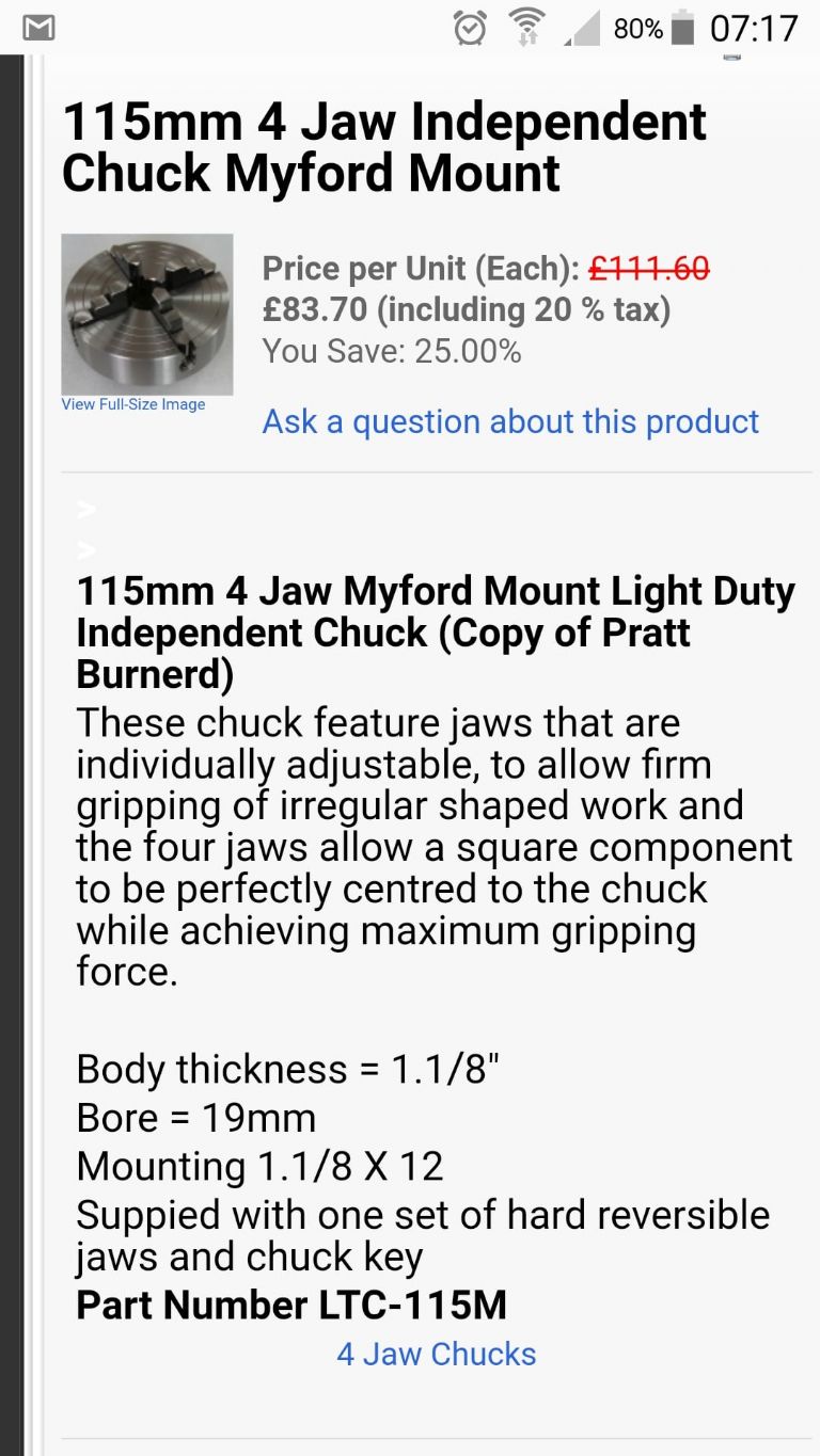

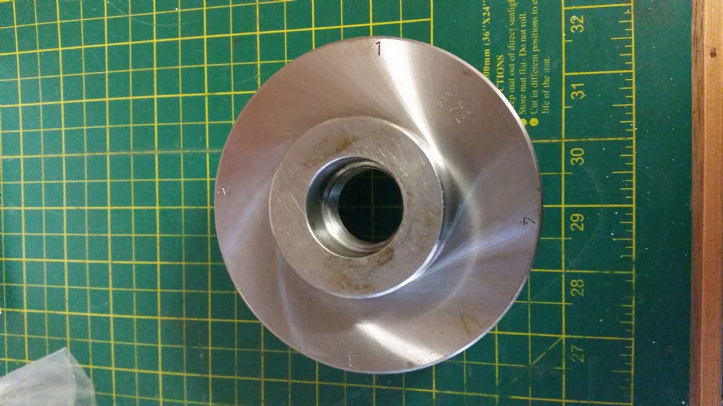

        HI looking around at different options for a 4 Jaw chuck for my ML10 and came across this one from Rotagrip seems to be a great price any one got any opinions on this chuck ?

          Hi I have dealt with Rotagrip for around 30 years and found them to be a good supplier,in this time I had 2 X 8 inch,3 jaw chucks both eastern european manufacture ,and various backplates ,soft jaws ,and other tooling .all have given good service.The advantage of this copy of the Burnerd is that the chuck has good overall proportions,less overhang and jaws are narrower and not so clumsy as some of oriental ones.
          #402551
          ega
            @ega
            Is it perhaps a little on the small side, particularly if it is to be the only four jaw available?
            Otherwise seems a good choice.

              Posted by ega on 28/03/2019 14:57:46:
              Hi I only have a little Myford ML10, it only has a 3, 5/16 (84mm) center height and the original 4 jaw option was only 4" so I thought it may be an ideal choice.

                I notice the words 'Light Duty' in the description and see the body is only 1 1/8" thick, ie it's on the small side and not a bruiser. Slim chucks can be very handy but I'd prefer something a bit heavier for general purpose use. Depends what you're going to do with the lathe but beware! The usual experience is to plan lots of small work and then find yourself making traction engines…

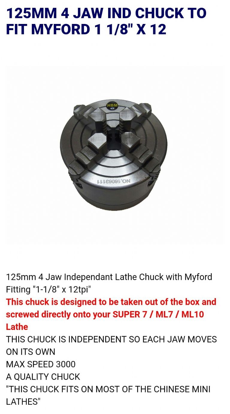

                    This is the other one I was looking at from RDG tools and only slightly bigger in diameter but has a beefier body.

                      HBM chucks are generally quite chunky so that one is significantly bigger and heavier than the one you first posted.
                      Personally I find a light duty four jaw nicer to use than its heavy duty brethren. Smaller jaws make it much easier to manoeuvre around projections on part machined workpieces. But I use 8", 200 mm, 4 jaw chucks so everything is rather bigger. Putting things in context its nearly three years since I used my heavy duty one whilst the lighter one comes out to play on regular basis.
                      Pity you don't have jaw tip width specifications so you can judge what the smallest part you can hold is.
                      + 1 for Rotagrip being good folk to deal with.

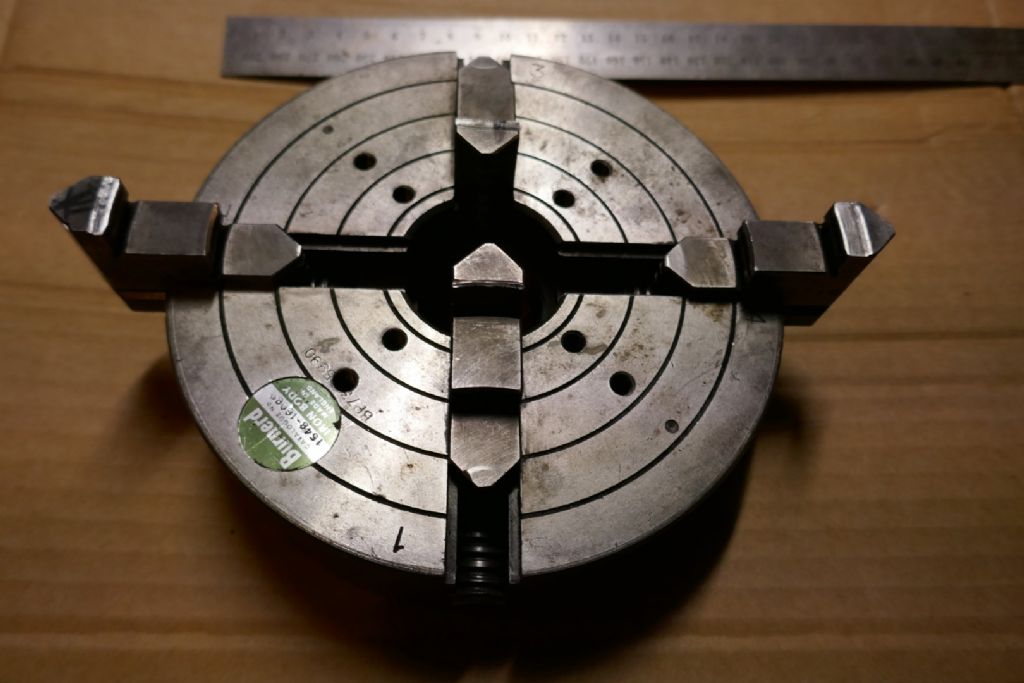

                            I have a Southbend lathe which has a centre height of 4 1/2" and use a 6" Bernerd chuck similar to the one in your photo. Also have a heavier, chunkier 4-jaw but prefer the slimer one. (I am building a 6" traction engine).  The 115mm version should be perfect for your ML10.
                            Paul.

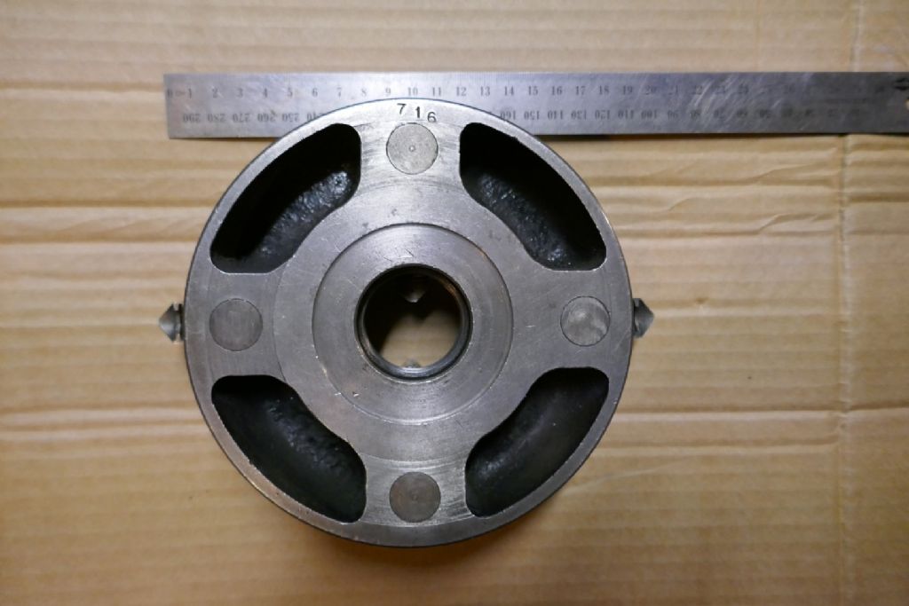

                                  I confess to being a little bewildered: I have [and have only ever seen] a 6" version of the genuine Pratt Burnerd 'light duty' Myford-fitting 4-jaw chuck
                                  • Does anyone have a photo of the back of this 115mm copy, please ?
                                  • … Is it a 'scale model' of the 6" ?
                                  My 4" is designed for front fixing to a backplate ['though it actually lives on the rotary table] and has a solid body.

                                    One thing with the "lighter" chucks is the jaws are narrower ( easily seen on the two photos above) which I find a big advantage particularly when holding things on an inner edge. Don't think my heavy one had been out of the cupboard for about 7 years which is when I bought my Bison slim chuck.
                                    #402631
                                      Posted by Michael Gilligan on 29/03/2019 05:46:52:
                                      Looks like "Light Duty" not lightweight as per the hollow backed slim chucks from their e-bay page

                                          Posted by JasonB on 29/03/2019 07:04:40:
                                          Thanks for that, Jason yes
                                          … makes much more sense now.

                                                    For reference, this is a 6" Bernerd light duty chuck. My preferred 4-jaw for most work on my Southbend lathe (same thread as Myford). Screwed sirectly to spindle with no back plate reduces overhang.
                                                    Paul.

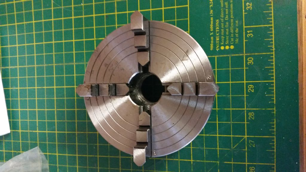

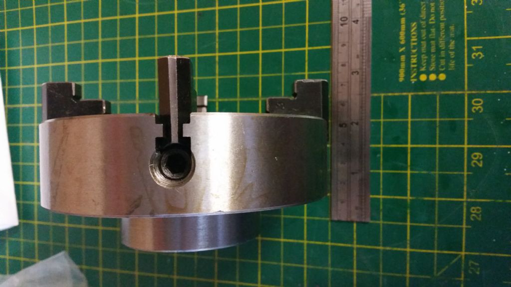

                                                      Hi all well I went for the slim body 12mm chuck from Rotagrip. It looks really nice and is very solid, I've taken a couple of pictures for those that wanted to see the back.
