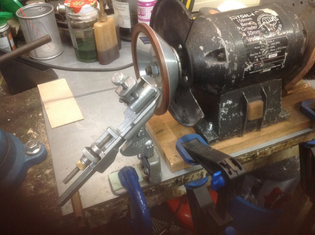

                              #640654
                              Bill Phinn
                                @billphinn90025
                                An update to this thread and another that I contributed to.
                                I ended up buying a 5 inch "diamond wheel" directly from a seller based in Shenzhen. I paid £25.
                                I have fitted it to one of my 6 inch grinders [courtesy of some Albanian builders who had thrown it in their skip].
                                I'm pleased to say that unlike the CBN wheel I bought from Axminster Tools and returned this wheel has scarcely any detectable lateral runout. I have sharpened around 20 drills on it so far [all 5/16" or under], and everything seems good.
                                The only thing I would change if I bought another of these wheels is I'd buy a coarser grit one; the one I bought is 320 grit. Buying a wheel with this fine a grit for tool grinding went against my instincts but I had read feedback suggesting the wheels were actually coarser than their grit rating suggested. I found this not to be the case.
                                I have not come close to overheating either the wheel or a drill yet.
