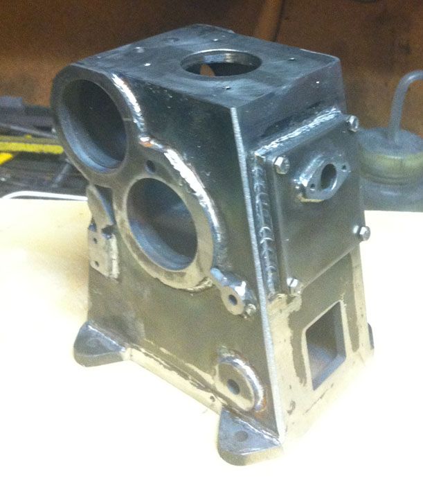

      So I have figured out the drawings, with JasonB and Georges help. The case I started on was incorrect, so I redid it with new sides and cover end.new case all ground.jpg
      #116098
      Sub Mandrel
        @submandrel
        How did you manage that in less than 25 hours, even with 'machine assistance'!
        #116116
        HobbyNut
          @hobbynut
          Posted by Stub Mandrel on 04/04/2013 16:08:13:
          Neil, I cut the parts at work, took about 45 mins, went home had supper, went to garage about 6.30pm, took Dremel and cutoff wheel to old assembly, cut all tacks, cleaned up parts, tacked new parts together, welded them, took hot assembly to milling machine, removed vise, clamped down fabrication, took cleanup off base, flipped the case and cleaned up .75mm off top, flipped it sideways and propped it up to face off cover flange, took it back to welding shop and ground it down a bit, took the Dynabraid and did more cleanup, put a carbide bullnose x 1/8 dia. bit in the Dremel and dressed the welds a bit, drilled and tapped the holes for the cover, fitted the cover. Shut down the workshop(shed) and went into house had a shower and head hit the pillow at 11.00pm.

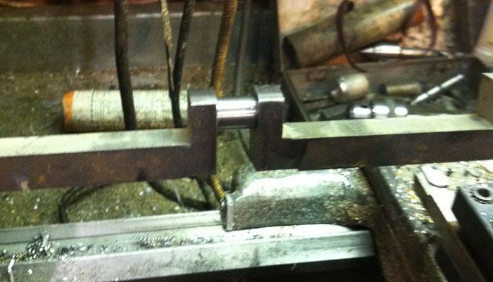

          HobbyNut
            @hobbynut

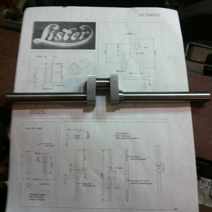

            A couple of parts in progress, the crank and the conrod.crank.jpgcon rod step 1.jpg

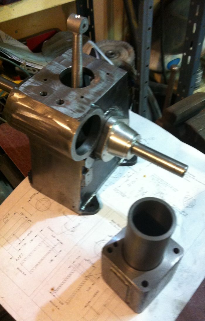

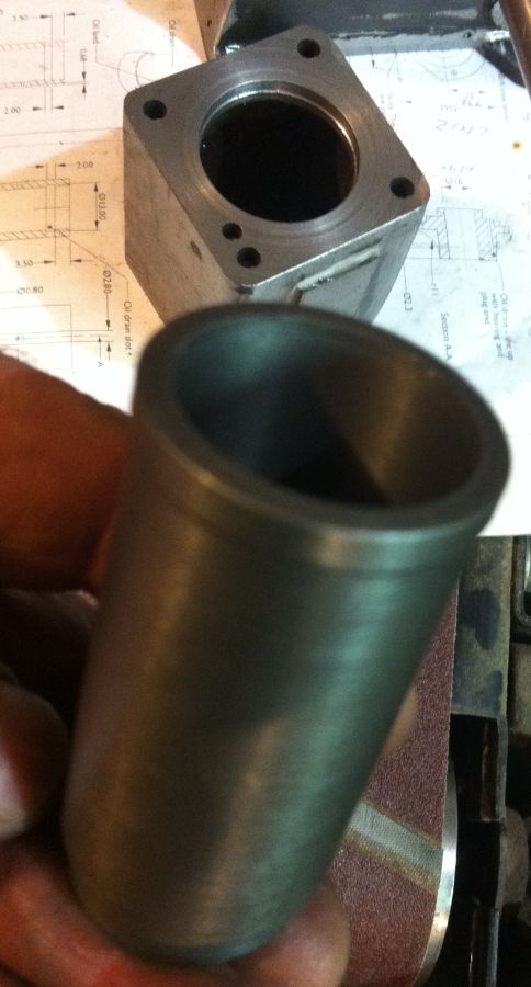

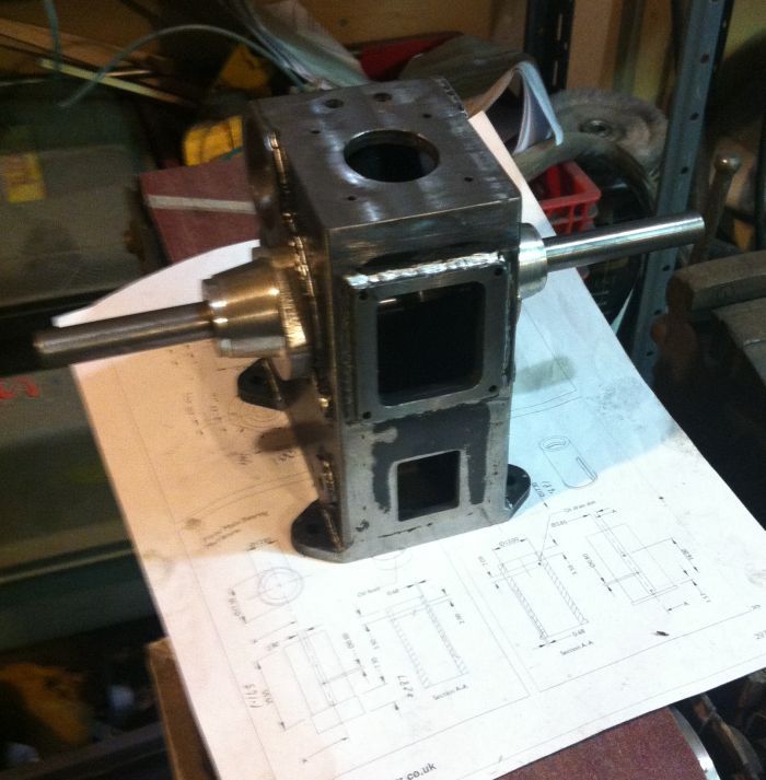

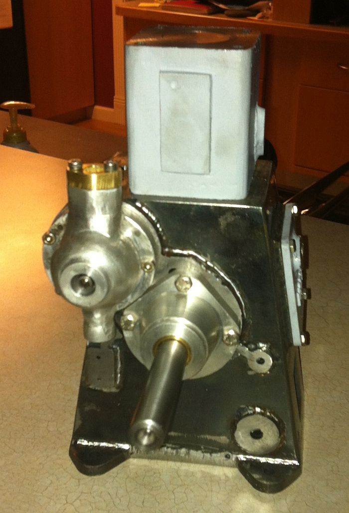

              Just an update on my progress on this. I have now got the crank and main bearings trial fitted.bearing housing.jpgcrankshaft.jpgcrank installed.jpg
              #120050
              HobbyNut
                @hobbynut
                Still building away here..Have not found any more missing, or non determinable dimensions.

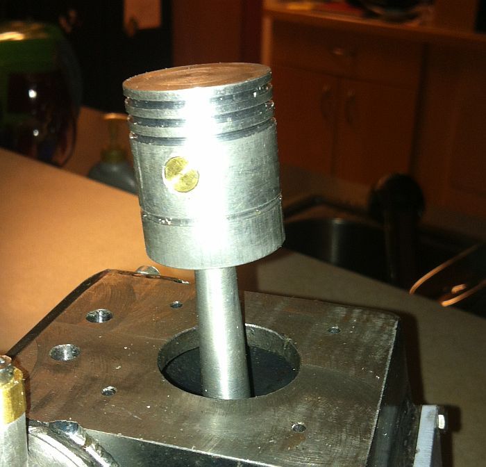

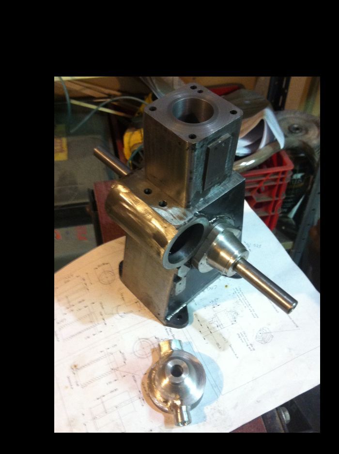

                #120467
                HobbyNut
                  @hobbynut
                  Some pics of my latest endeavors on the Lister.

                      Jeff, the drawings are definitely confusing.
                      I am redrawing and fitting as I go now, as it seems to be the only way. I find it very difficult to figure out how the 2 pumps go together, as there is not an assembled cross section, or exploded assembly drawing of either.
                      I am concentrating on getting the basic, crank,cam, piston to all work together then hopefully the head details will turn up in the mag.
                      There is no detail of how the oil gets to the main bearings, or am I missing it.
