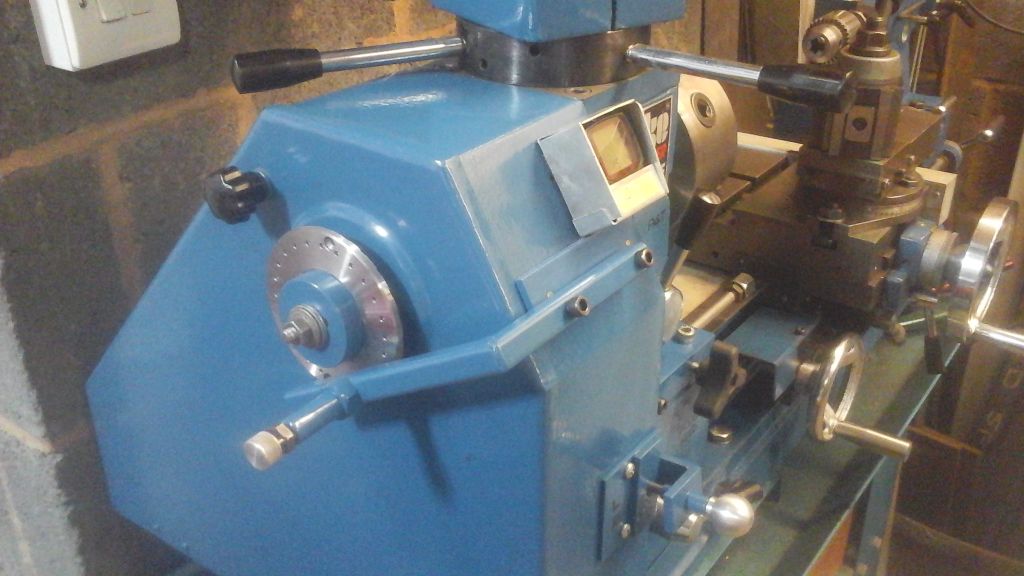

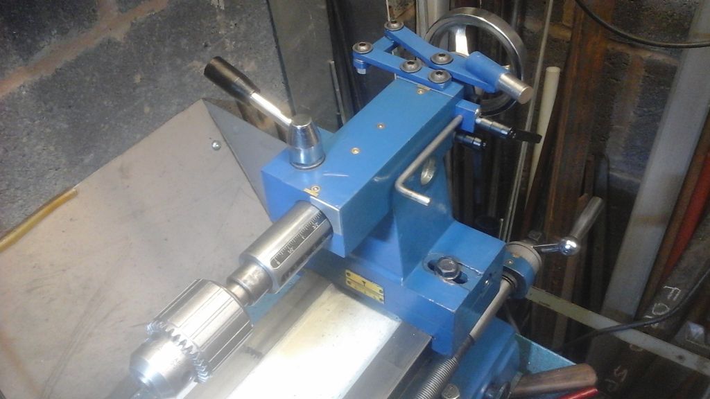

      The recent thread by Hopper encouraged me to make this mod based on a mini lathe conversion I found via google photos. It works well and smoothly, and retains hand wheel operation by locking the barrel extension in the rearward position.

                I did it because I can Mike. Scrap materials mostly – I bought two oilite bushes and two proprietary adjustable locking handles to finish the job. On the contrary, I expect it will give me more 'feel' for some drilling jobs, and allow rapid withdrawal for clearing swarf when drilling long holes. I think it's been worth my time to make (and an enjoyable project), and time will tell on utility.

                  John, I'm glad my thread was an inspiration to somebody. It looks good — and much less work than the hand-carved look!
                  Mike, I have been getting to know mine as I use it more. And I like it. Drilling a 1/16" hole is much easier than winding handwheel in and out. Much more "feel". The long lever gives surprisingly delicate touch. And it takes the trepidation out of centre drilling as you can whip it out very quickly to clear swarf and and oil. I was using it to drill a 3/4" hole yesterday and thinking how much easier that was. Well worth having, i reckon.

                    I made something similar for my Clarke CL300 some time ago. This was based on a article in "Mike's Workshop" site. mikesworkshop.weebly.com/lever-feed-tailstock.html
                    This has the advantage of a lever feed or lock it and wind the handle as before. It makes "pecking" while drilling easier and I find it very useful if using tailstock held taps or dies. Also of course, an interesting construction project, which is what this hobby is all about, whether one is making some simple tooling or constructing a model railway engine.

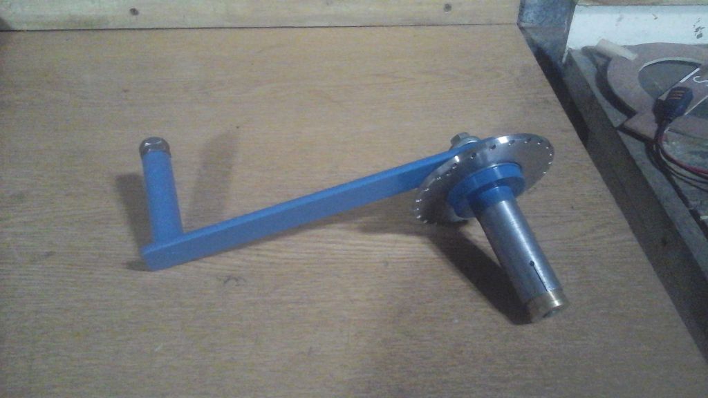

                      I suppose the sliding tailstock will also allow a tap to advance in a workpiece held in the chuck -the chuck being turned by a crank like this one I made earlier. I have not tried this yet.
                      The wheel on the crank is a cheap 24 hole indexer intended for a wood lathe, and used with the spring loaded plunger shown in the second photo.

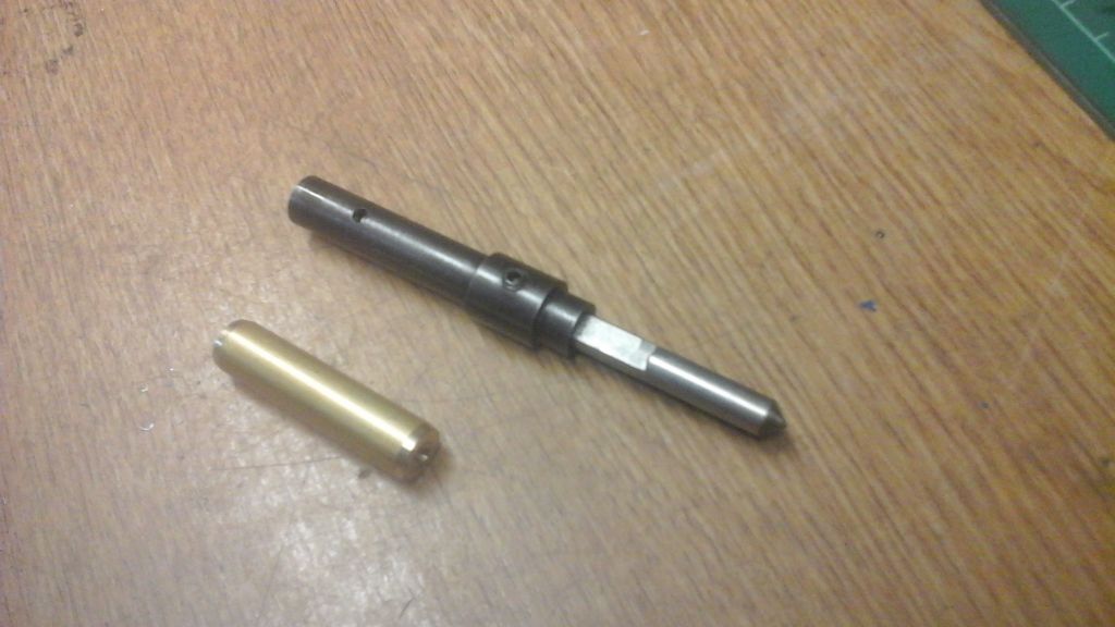

                            John H : Have you tried one of those spring loaded centres that you can use with taps? – they work great generally and allow a straight start to threading a piece in the chuck. Use with your 'crank' (often referred to as a mandrel handle)
                            All the best, Mike
                            #597018
                            john halfpenny
                              @johnhalfpenny52803
                              Yes Mike. I make a lot of kit, but no models yet. This one has a brass sleeve for my small taps with pointed ends. The crank may be better for larger threads where it is difficult to get a big tap wrench to turn in front of the chuck, and of course you have to stop the chuck from turning with the tap.
