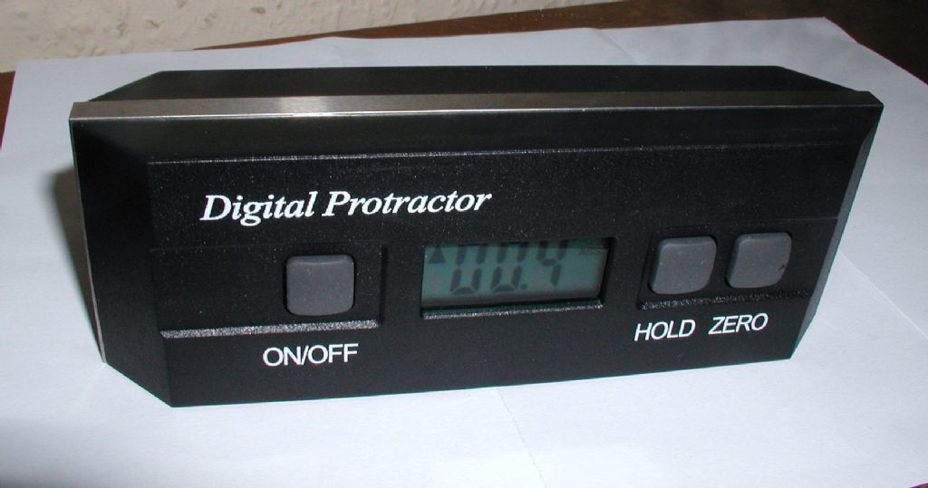

                          Nicholas Farr
                            @nicholasfarr14254
                            Hi, with ref to John’s post, 30/11/10, yes it is ideal to have the mill table level for a referance point to set up your work, but you can still do that if it isn’t. The best way is to use an angle gauge or graduated precision level and read what angle your table is and then just add or subtract that to the level you want your work at.
                            I have one of these digital protractors, which you can set to zero at any level and then it will give you the direct differance at any other angle and there are little arrows on the left of the digits to show if it is up or down, but in most cases it is obvious.
                            Very handy and not terrable expensive, its resolution is 0.1 degree.
                            Regards Nick
                            Edited By Nicholas Farr on 30/11/2010 11:16:55

                                Hi Nick,
                                the IPhone App I mentioned earlier can do the same, and it can be used flat to give two axis of level or on edge to give one axis.  And as i said I use it on a relatively inexpensive IPod Touch (1st generation,2nd hand off eBay). and the IPod Touch can be used to store my music, calculate,  Store drawings and videos (useful ones such as techniques off YouTube etc) and many other things.
                                Some people think I am suggesting one should buy one of these devices to use as a level, I’m not, it’s just a cheap way to get a precision level (0.1 degree sensitivity) level if you already have an IPod Touch or IPhone (or even IPad but that’s a bit too exotic).
                                Terry

                                Nicholas Farr
                                  @nicholasfarr14254
                                  Hi Terry, I understood your post about the IPhone and appreciate its values. Idon’t have one and agree with you that is not expected one should buy an IPhone just on that merit. I just pointed out what I have that was not too expensive, but low cost dail angle gauges can work as well. Digital gives you a figure, whereas you might argue with yourself is it above or below the line with a dial. People with ungoolgeled eyes of course can read dials easyer than I can.
                                  Regards Nick.

                                  Terryd
                                    @terryd72465
                                    Hi Nick,
                                    Of course I quite agree with you and understood where you’re coming from.  The IPhone app. also gives readings and can be zeroed in a similar way to which you are describing.  If I was in your position I would probably do the same and buy an inexpensive digital instrument.
                                    The use of a dial gauge would of course be similar to tramming the machine to check accuracy.  The main point that seems to be coming up that absolute ‘level’ is not really required, it seems that beginners are often put off by the seeming complexity which is pushed by some and are afraid to use the machines unless perfection is achieved in setting up etc whereas perfectly acceptable results are achievable with less than perfect set ups.
                                    Terry
