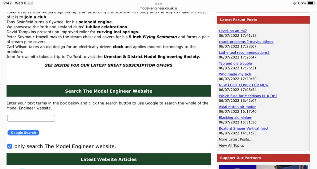

          The subject has been worked to death on this forum, Chris
          May I suggest that you search [using the box on the home-page NOT the one on this page] for the word levelling, and see what takes your fancy. …

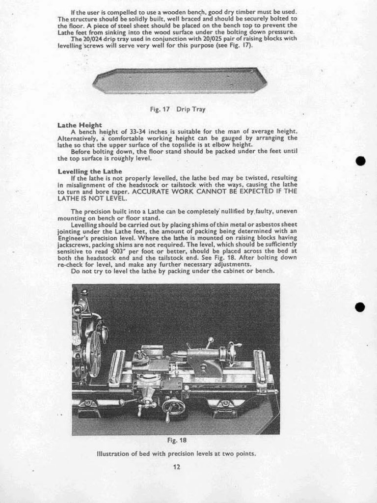

                                So, if a precision level gives an accuracy of half a thou per foot, and your old Myford has easily 4 thou wear on the front way in one place, and 2 thou wear on the rear way, which is common and within tolerance for not needing a regrind, that is a difference of 2 thou over the width of the bed, which is 4 inches. So that is equal to 6 thou per foot of difference between the ways due to uneven wear.
                                What is the point of putting a half-a-thou per foot accurate level on a bed with 6 thou per foot of wear? If you twist the bed to get a level reading, the rest of the relatively unworn bed will be 6 thou per foot out of level.
                                So with a used old Myford etc, it is best to not worry too much about super accurate levels and follow the instructions in the Myford factory User's Manual to bolt the lathe down without distortion by using a clock on a 12" piece of bar in the chuck while tightening down the mounting bolts. Any movement of the clock and that bolt needs a shim around it.
                                Then do the turning test as Chris has done on a test piece of 1" bar 4" to 6" long and measure it for taper and shim the tailstock end mountings accordingly, as per the Myford User's Manual. This is the ONLY test that really matters. All the rest is theory until you take a cut under real-world conditions and cutting forces and see what your worn old lathe is really doing.
                                #605025
                                  Posted by Hopper on 09/07/2022 06:06:07:
                                  So with a used old Myford etc, it is best to not worry too much about super accurate levels and follow the instructions in the Myford factory User's Manual …
                                  Which, for sake of completeness, I an showing here:
                                  There is a lot of knowledge condensed into those approximately two pages worth of instruction ^^^
                                  #605026
                                  Hopper
                                    @hopper
                                    Thank you Michael. A lot indeed. And that is about all that needs to be known to get your lathe set up, if you include my above proviso re the dangers of using sensitive levels on worn beds. (Although Myford above specifies levels with a sensitivity of 3 thou per foot which are not so sensitive by today's digital standards.) If you have a brand new unworn lathe bed, then page 1 will get you back to where the lathe left the factory, all nice and level and flat. Pages 2 and 3 are the relevant ones for old lathes with a bit of wear in them.
                                    It's like they say: When all else fails, read the manual! Your post should be enshrined somewhere on this site as the standard reference to all levelling questions.
                                    Edited By Hopper on 09/07/2022 07:03:08
