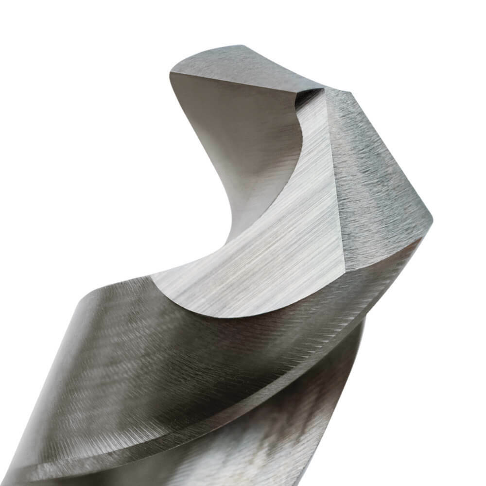

Look at a humble twist drilldrill, it may be 118 or 135 deg point angle, it may be split point or conventional point or one of many variations ~ Racon point anyone?
It may have a thin web or a thick web, it may have light or heavy lands.
It may be a rolled drill bit (generally black finish) or a ground bit ( generally bright finish)
It may be coated or uncoated, it may be HSS eg M2 or a cobalt tool steel
All this will influence how it cuts & in what material.

Conventional drill points ( 118 deg non split ) are great for the hobbyist,
These you can sharpen yourself. Money saving.
I'm not the best @ this but can get the job done.
Everyone should give this a go.
My non machinist, keen DIYer friend was ecstatic when i gave him a sharpening gauge~ he seems to have got the knack of it very quickly.
Backing off the trailing edge makes things easier
….What i'm less keen on is with conventional drill points you need to pilot/ center drill first.
They do seem to work better for step drilling however IMO.
Split point drills, particularly those with a larger point angle require less power to drill a hole.(major boon for small machine tool users)
If you don't believe me try drilling a 1/2" hole with a conventional drill then with a split point.
On the negative side there doesn't seem any easy way to resharpen them. You could resharpen as a conventional point but as they usually have a heavty web this may be less than satisfactory,
I guess some enterprising individual has found a way to resharpen these at home.

Let's keep it simple. 4-facet (or 6-facet, if you want to be fancier) points are the answer for most (of our) applications. They can be elaborated to split point (as Ady1's link shows) if you want to make re-sharpening more difficult. The chisel point on 'conventional' bits just makes things difficult, especially on less-than-rigid machines.
As for 'step drilling', try to avoid the need – it's a tricky operation at best, and a drill-bit breaker at worst.
Oh, and don't start drilled holes with a centre drill – use a 4-facet pointed spotting drill.

My everyday drills, 1 to 10mm by 0.1mm, are Dormer 4-facet. Imperial, number and letter drills are conventional, but don't get used that often. I expect drilled holes to be within 1 to 2 thou, usually oversize. For better accuracy I bore or ream depending on size and machine in use.
For general work 4-facet drills start, on the vertical mill, without needing a centre, provided the work is smooth and flat. If I need to be assured of positional accuracy I use a carbide spot drill first. Never got on with using centre drills for spotting. I only use centre drills in the lathe.
Stoning drill edges never worked for me so I have a small set of slow helix drills for use on copper alloys. Bronze and gunmetal are worse than brass for pulling in. I also have a few fast helix drills, but I don't machine much aluminium these days.

The reason your holes are oversize is that the two drill lips are different sizes, even from new, and once used the outer corners of the cutting edge unevenly worn. Step drilling helps with this, and ensures the little lathe is not overloaded.
If you read old ME articles drilling is always done in stages but recently there seem to be a brigade of "I was a toolmaker for 50 years" who can't grasp that a minilathe can't shove a 2inch bit through steel in one go like their 20 HP industrial machine did in the blacksmiths shop where they really worked.
The reason for using a centre drill not a spotting drill to start is that is it is rigid but your tailstock must also be firm, the barrel not sloppy, and of course on centre. Make sure there is no residual burr to throw off the next stage drill which is why you go in to just start using the coned part of the centre drill.
Each drill in the steps needs some metal to work on so choose steps appropriate to the size of lathe so that the chisel is well cleared and there is at least 1mm for the edge to work on.
The reason new drills do not have a secondary clearance is that the area of that back slope stops the drill spiral trying to pull it in too fast. Amateurs putting on a secondary clearance actually make performance worse, which is not helped by the tailstock thread backlash allowing it to snatch.
Hand ground drills whatever those "toolmakers" claim are always out of true as it is a physical impossibility for a wobbly flesh hand to hold a constant angle, let alone duplicate it for the other lip. Even lightweight hobby tool and cutter grinders cannot achieve this,
