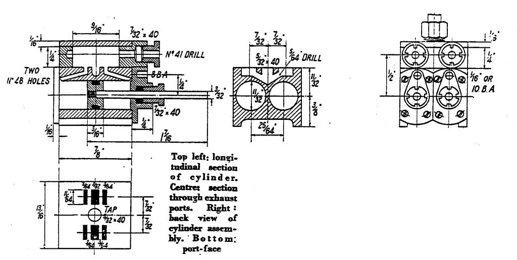

                    Hi Steven, the publication from Tee Publishing is a complete facsimile of the original series that were printed in ME of both "Bat" & "Owl" the Owl is a twin cylinder design.

                      Really? Wow how would 2 cylinders be squeezed between the frames?

                              Hi Steven, like this.

                                Nick, thanks for that.
                                I’ll order the reprint and see what I think after reading that.
