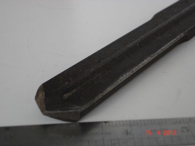

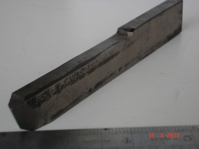

                                              023 (640x480).jpg024 (640x480).jpgAnd cast iron use no cutting fluid, it's dusty, and dirty.
                                              A homemade lathe tool, the flat drill was left behind by a railway work(?)gang, I saw it was HSS, so I got to work with the angle grinder, and converted it into a reasonably serviceable tool.
                                              Ian S C
