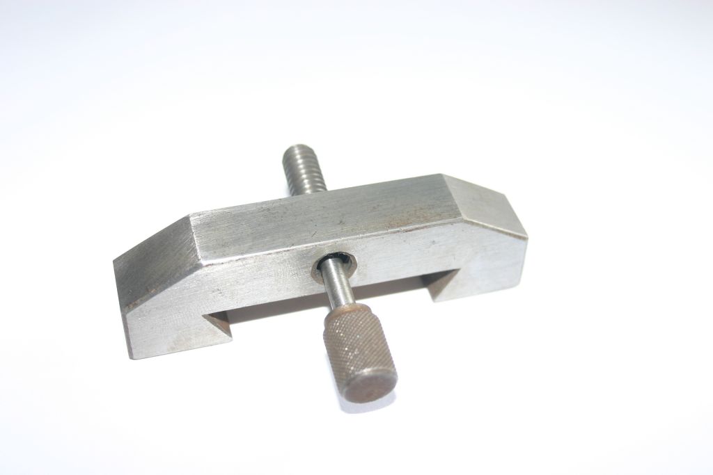

          I’m not sure exactly what you mean by a ‘thread stop’. I had a Boxford which had an attachment to provide a stop on the cross slide for use when cutting threads. It consists of a simple clamp which fixes to the cross slide dovetails with a sliding screw which screws into a tapped hole in the end of the cross slide itself. In practice it allows you to set a stop when cutting then it is possible to withdraw the tool, rewind cross slide and then reset the tool to it’s original setting. It is, as you say very useful.
          In the picture below you cannot see the grub screw which secures the clamp to the dovetail. It is fitted into a threaded hole in the LH side of the clamp and presses on a slug of metal the end of which is shaped to the angle of the dovetail which does the clamping to avoid damage to the dovetail itself. I can’t show a picture of the parts as the device was lost in a workshop fire last year.
          The cut of course is put on with the top slide
          Hope this helps,
          Best regards
          Terry

            Hi Terry,
            Yes you nailed in your description what I meant by “thread stop”.
            Thanks for the image, I should be able to adapt something similar and as you say, very useful as I do cut alot of threads.
            Thanks for the post.
            Cheers Michael

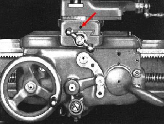

              Glad it may be useful, it really is quite a simple device to use and works beautifully. Here is a picture of the Boxford carriage which i found, it shows clearly the threaded hole in the cross slide for the threaded part of the sliding stop bolt. It makes it quite easy to visualise the operation of the device.
              Best Regards
              Terry

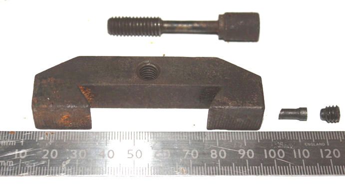

                      I managed to retrieve my cross slide (thread) stop after salvaging it from a workshop fire. I intend to clean it up when I get my workshop rebuilt. I’ve posted a picture below of the disassembled stop showing the component parts. Note the thrust pin (for want of a better description) is angled to match the dovetail to prevent damage. The reduced diameter section allows the ‘thrust pin’ to be made captive so that it isn’t lost when removed from the lathe.
                      Best regards
                      Terry

                          That’s great Terry and thanks for the picture of the lathe as well, much appreciated. Looks Like I have a little project to perform this weekend.
                          Cheers
                          Michael

                                The CVA/Monarch lathe comes with a threading stop built-in. It allows two turns of the cross slide for fast retraction then 2 turns in again to meet the same mark. Advancing the tool into the cut is done by swinging the top slide around.

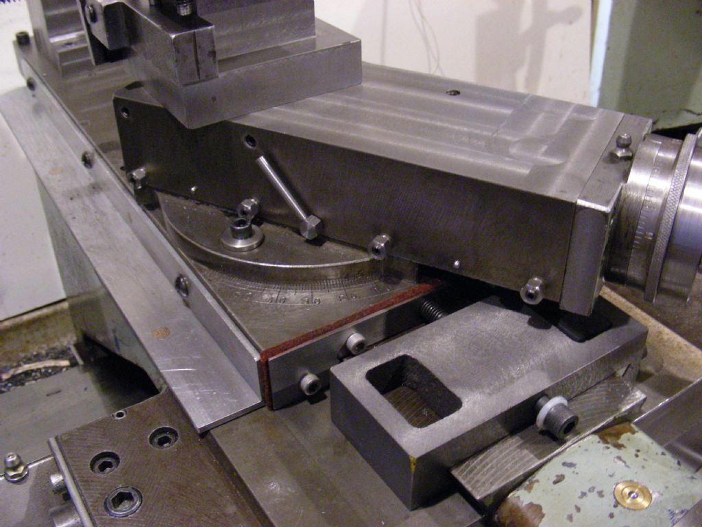

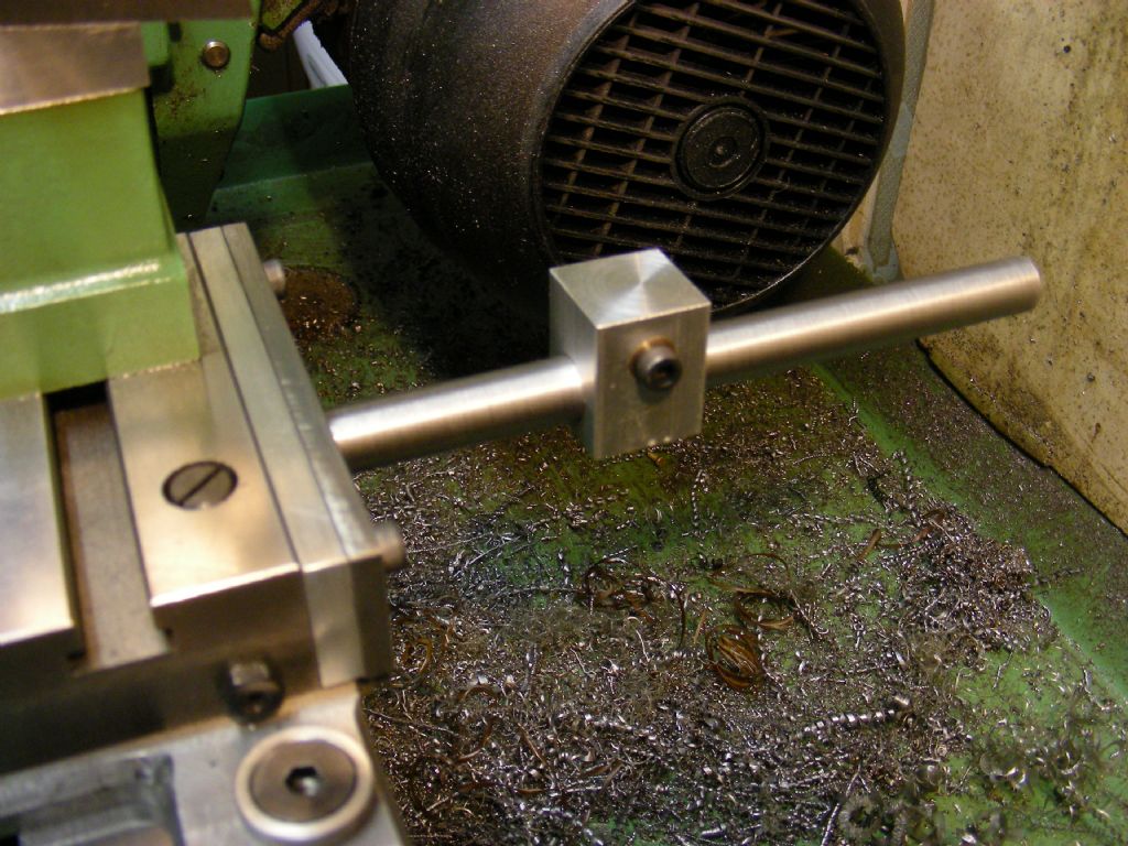

                                      There was a recent post deploring the industry's failure to provide cross slide stops on our lathes and I was prompted by this to continue with a long-dormant project for the S7. I had considered an ingenious micro-adjustable device by Tubal Cain and other devices which looked likely to get in the way and opted for a rod projecting from the rear of the slide with a simple clamp which buts against a plate screwed to the back face of the slide:
                                      The Boxford style device mentioned above seemed suitable for the Willson slant bed (the two rectangular holes in the cast iron block are a legacy from its former role as the base to a fixed steady and are not part of the design):
                                      There is a potential problem with both kinds of stop in that the cross slide can "bump" the stop by a thou or so and thus inadvertently alter the infeed; the plastic washer on the cap head screw is an attempt to mitigate this. Both stops are stops are still "under development" but seem likely to simplify screw cutting with set over top slide.
                                      The swing-up tool needs no stop, of course, but does require the ability to stop the lathe and reverse without mishap.
