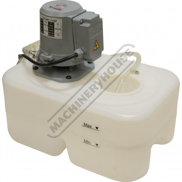

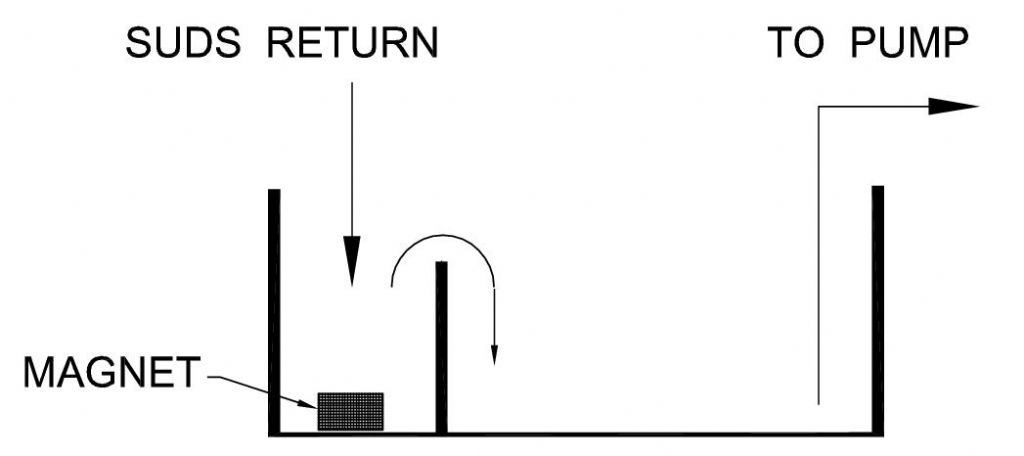

                    #506105
                    Paul Lousick
                      @paullousick59116
                      Hi Jim, Your arrangement is similar to my suds return.
                      The suds for my mill goes thru a strainer first to remove large swarf before returning to the tank. The tank has 2 compartments with a wall between them. Small particles settle on the bottom of the first compartmnet and the clean liquid flows over the wall. There is also a magnet at the bottom of the first compartment.  (It is a commercially made pump)
                      Paul
