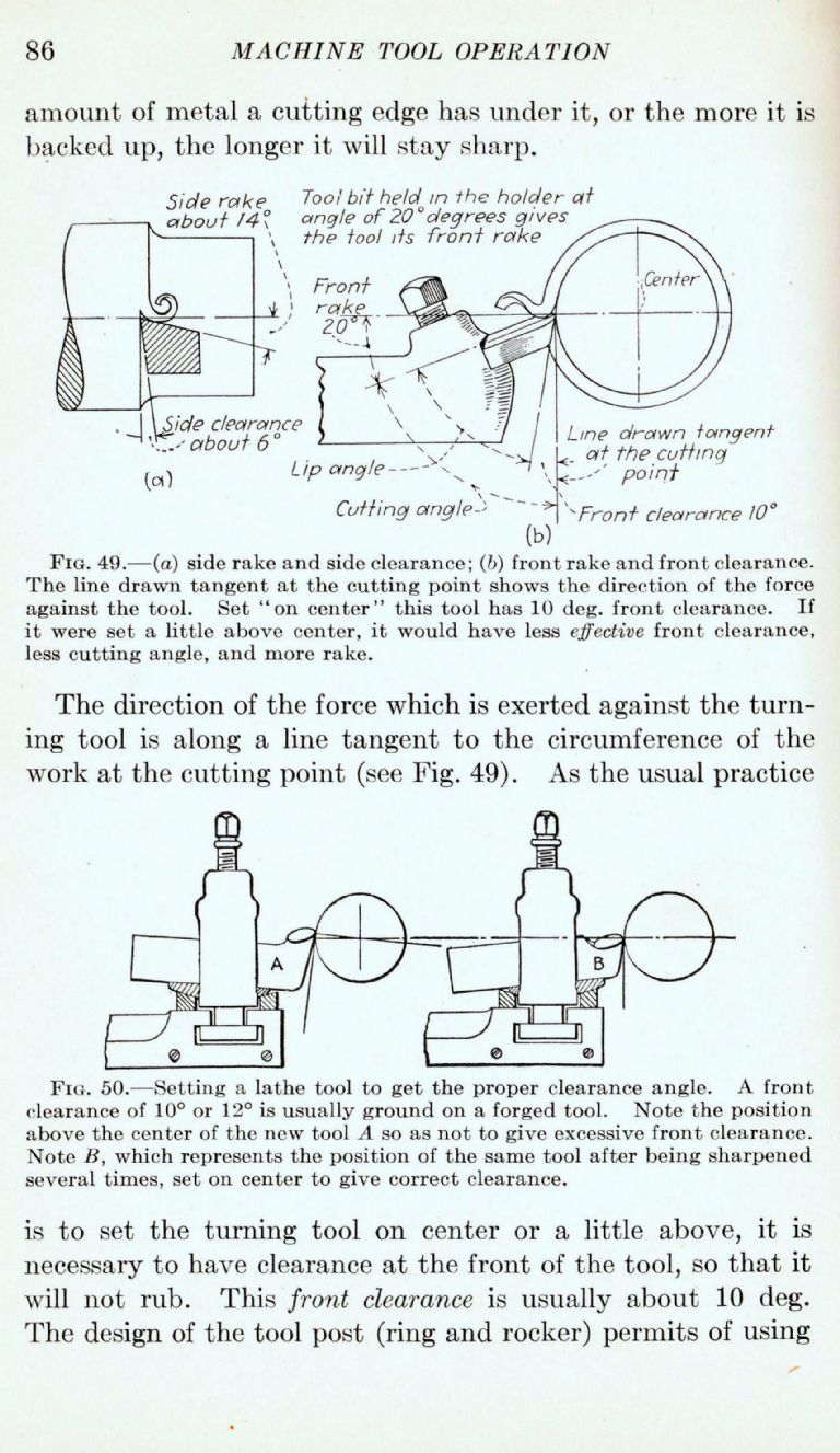

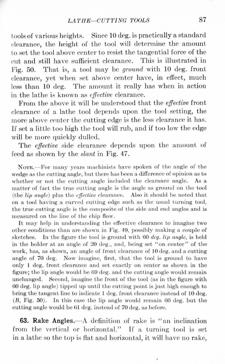

                          The advice in my copy of "Machine Tool Operation" by Henry Burghardt, 1936 edition, (first published 1919 ) basically echos the advice it the South Bend book. Here is the relevant pages giving the rational. It starts about half way down the first page.
                          This book came from my first high school in 1959 when it ceased being a "technical school".

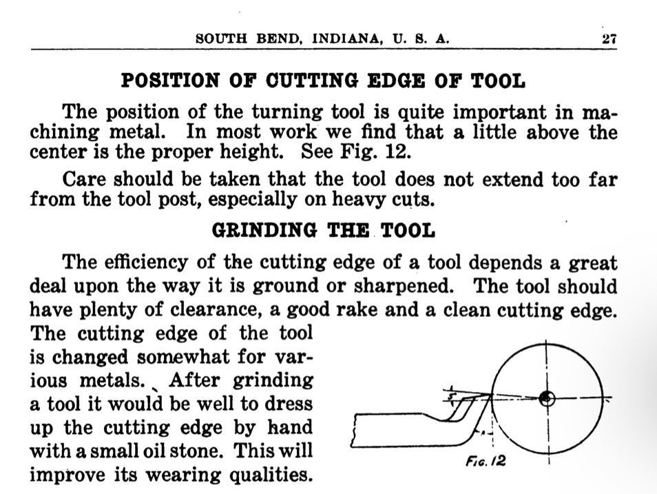

                                    The 'anti-dig-in' idea sounds reasonable, but does it withstand close scrutiny? A tool on centre height still experiences an outward force. I suppose 'dig in' susceptibility depends on the geometry of the deflection of the tool bit, holder, tool-post, slides, etc. With a weedy Myford (for example), a dig-in is an unstable condition, the bit 'nodding' further into the work. It's not pulled in, it's pulled down; the whole tool support assembly effectively pivots somewhere near the topslide base, and this pushes the tool inwards (Long ago, I applied forces and measured deflections, then calculated effective centre of rotation of tool tip). In this case I don't think that an above centre-height setting would help. But – this may have been the original idea, because I'm sure I have an ancient book (somewhere…) that believed that the forces on a lathe tool pulled the cutter towards the centre. Similar thinking may be the reason why some old lathes (and the current Cowells – it's a living fossil…) have the carriage gibs at the front. I wonder whether the high setting results in a little burnishing of the cut surface, which was thought to be better cutting?
                                    By the 1930s, South Bend lathes were pretty hefty, and well designed, albeit with plain spindle bearings, so lack of rigidity should have been less of a problem.
                                    However, none of this musing really explains why the texts advocating a high setting for parallel turning set this aside and allow geometrical considerations to demand on-centre-height setting for tapers. Inconsistent information worries me…

                                                    Fig 50 explains why the same tool is positioned 5° above and later on the centre-line. The change is necessary because repeatedly sharpening the tool alters its geometry. The forged tool shown in Fig 50 is a particular old-fashioned shape. It starts life at 5 ° and is clamped in a horrible rocking tool-holder that allows it to be dipped down to 0° as it approaches end of life after multiple regrinds.
                                                    Forged tools of that old-fashioned type have long since been replaced by plain rectangular HSS tooling that simply sits flat. The original advantage of hooked forged cutters has gone because HSS does the job without needing that special form. And getting rid of the rocker type tool holder was a major benefit – they're not very rigid. Modern tool-holders only support HSS and Carbide at a right-angle to the job.
                                                    I think 5° over centre was excellent advice before HSS, and was still useful guidance up to 1940. During WW2 the need to improve production rates caused a rapid switch to HSS and Carbide, and a preference for cutting on centre.
                                                    Both approaches work, and 5° above could well be useful when a less rigid machine has to take heavy cuts or tackle a difficult material. South Bend's Guidance isn't the law though, it was best practice at the time, hence worth knowing. Coming up to a century later, I think cutting on centre or slightly above is appropriate for most people most of the time. I often experiment for best results, but I always start just above centre.
