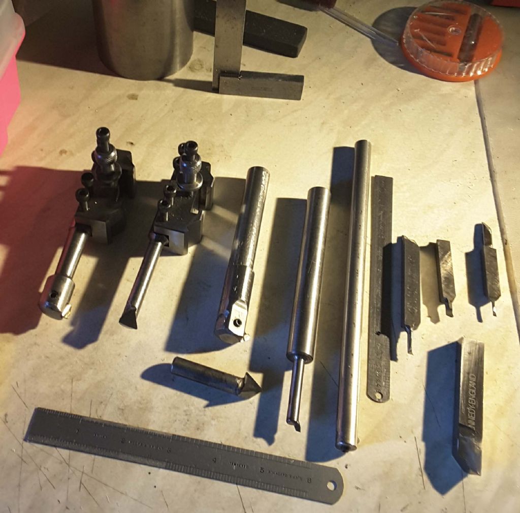

      I've always used carbide insert boring tools but haven't got one small enough for what I want to do now, so I want to grind one from HSS.
      All my carbide tip holders set the tip with a negative top rake – I don't know why, but they work. Is this something specific to carbide inserts or does boring in general require a different top rake from external turning?
      The tool I want to make will be used to bore mild steel.
      Any advice will be appreciated, Robin.

            How deep and what diamiter do you want to bore Robin.
            Here is a selection of tools that I have made. The one's on the right will go down very small holes but not so deep and others with piece of tool steel held by a grub screw. I tend to make them pointed with clearance so that I can face the bottom of the hole as well as bore. The top rake is around 5 deg and only a very small tip radius stoned on if nessesary.
            David

                            Thanks for replies. Looking at David's (impressive!) range of DIY boring tools, and taking Zan's advice that zero rake works OK I made a tool (from silver steel) with zero rake. My need was for a 12mm blind hole 15mm deep with a flat bottom – so it is pretty slender. But it worked!
                            I notice that my first cuts gave a slightly conical bore, with the narrow end towards the headstock. After taking numerous spring cuts I ended up with a parallel bore, but I don't understand this behaviour. How does the tool know where it is?
                            Robin
