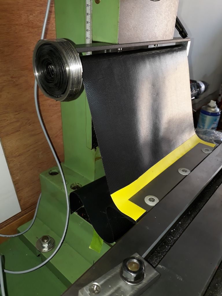

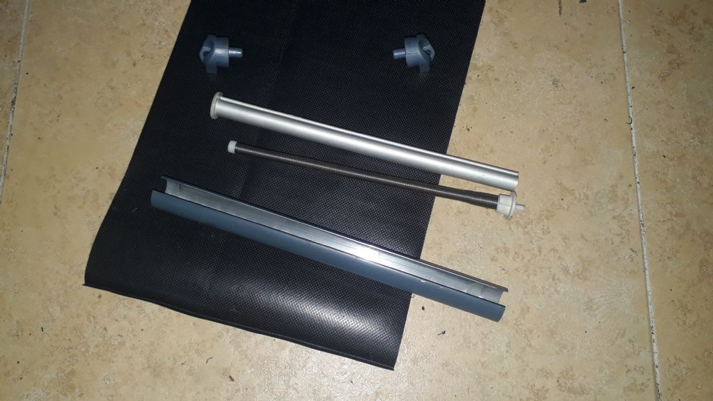

      I while ago when fitting a dro to my WM18 mill I decided to replace the original column accordion way cover and rubber cover Z-axis cover with a roller blind type cover. The original covers did take some travel in both axes, so I figured a roller cover attached to the head and and the saddle will give me the maximum travel you could possibly get from the mill. Also all the chips remain on the table not fall behind the saddle.
      Had the cover on the mill for about a year now and I'm quite satisfied with it, so I'm turning my attention to doing something similar for the lathe.
      The one on the mill was a scratch build project, so made a hairspring from packaging steel strapping and a roller from some scrap steel and the cover from thin pvc fabric. The contraption although compact in size for the mill will not work for the lathe, it needs to be smaller.
      I found a small broken roller blind which I plan to gut and recycle for this project which might work. The idea is to attach the roller to the headstock under the chuck and the pvc cover to the carriage, without loosing any travel.

                            No the whole thing is shop made, at the time I could not find a roller blind small enough to fit. The roller itself is simple to build, just a frame with a hollow tube passing through. The wind up spring needed some thought, so I came up with a spiral flat spring and put it in a housing as it had a tendency to pop out.

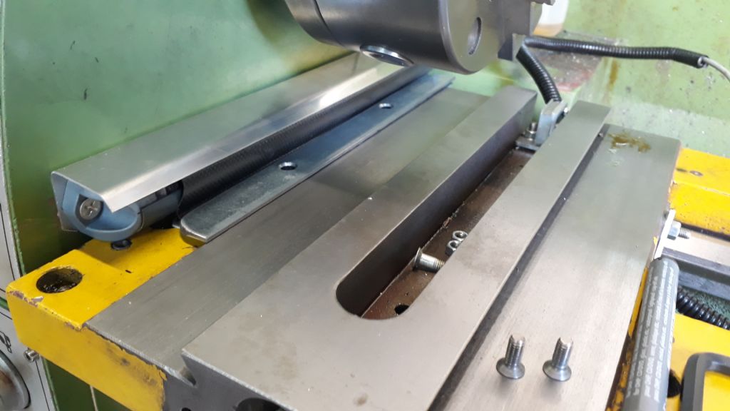

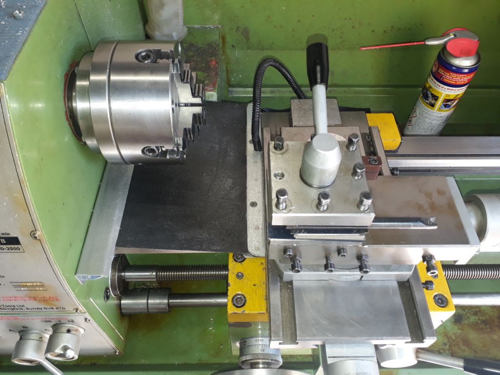

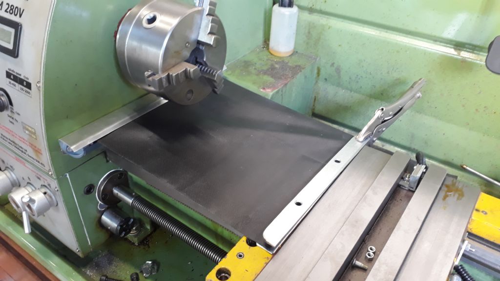

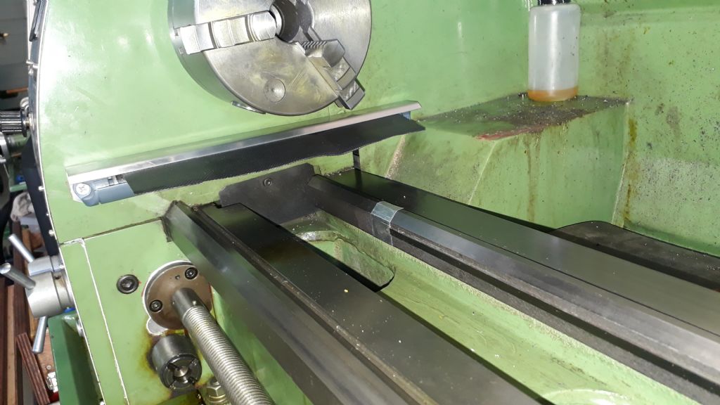

                                    This morning found some time to start this project. Disassembled the roller blind and cut it to the size I need. Made some brackets for the installation and then mocked every thing in place to see how it fits. So far it looks like it will work fine.
                                    Blind cut to size and new cover material
                                    Cover installed directly to headstock, should cover the ways and beyond
                                    Carriage travel unaffected, top cover should prevent swarf winding up inside the blind.
                                    Cover extended, temporarily held with a vice grip, looks like it functions well.

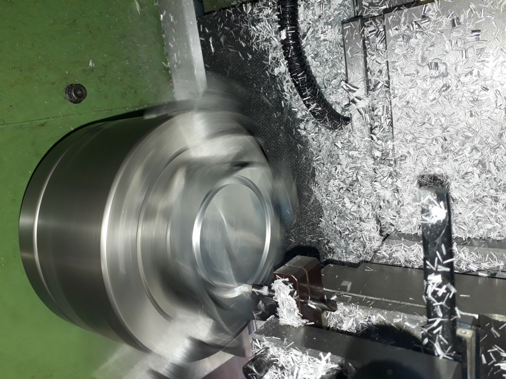

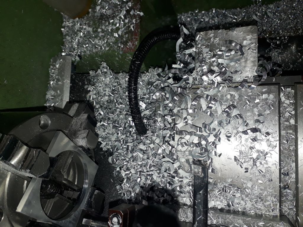

                                      Finished this project a while ago and it's been un use of these couple of months. I'm happy with it, cleaning is a breeze and keeps swarf away from the ways effectively.
                                      Messy job,
                                      Lots of cleaning to do,
                                      5 minutes later

                                        Looks good, have you used it in anger with tipped tools yet? Just wondering if it stands up to hot swarf?
                                        #563983
                                        ChrisB
                                          @chrisb35596
                                          Posted by Ebenezer Good on 22/09/2021 21:28:09:
                                          No issues with hot swarf, I have the same type of material on my mill and had it for a couple of years with no issues. The reinforced PVC so far resists oil and heat well.
