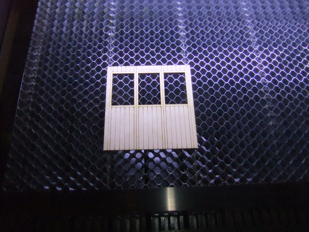

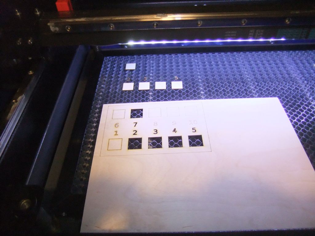

                        Thank you everyone who replied to my initial enquiry.
                        After some consideration the Orion Motor Tech 50W was selected as it has the facility to modulate the laser power under software control, thus being able to minimise burning at corners, for example.
                        The first cut produced
                        and the second cut:
                        Which some of you may recognise as a narrow gauge coach side.
                        The modelling was conducted on LibreCad running under linux on a laptop computer.
                        The input to the laser cutter was by Lightburn
                        Pmm1
