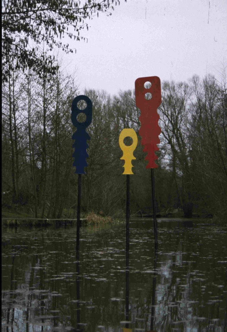

                                      My only experience of this sort of thing was when a friend produced some large artworks in steel and roped me in to help him erect them. I don't remember the process – they might have been flame rather than laser-cut – but I do recall acquiring some of the circular offcuts.
                                      Edited By ega on 02/08/2019 11:33:01
