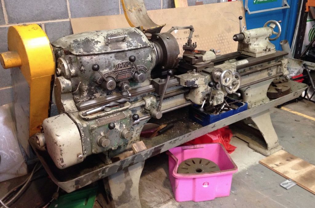

                CHRISTOPHER MILLS 1
                  @christophermills1
                  Here is a better picture of my Lang Junior. Despite tired cosmetics, the lathe is in excellent shape, and shows no sign of real industrial use.
                  This was, after all, John Lang & Sons' hobbyist offering, weighing in at only 1.4 tons. It is the smallest lathe Lang made.
                  Everything on it is seriously chunky – the drip tray weighs over 200lbs, and, covered in oil, it took three men to manhandle it. The tailstock weighs about 100lbs.
                  It has an extra foot of bed on standard, @ 7 ft, and came with three chuck/faceplates, and a whole estate carload of cutting and drilling goodies, and tailstock chucks, centres, etc.
                  Bazyle, many thanks, and I will try your diagnostics when I am next with the lathe in a few weeks.
                  Phil & Brian – I think we are inching forward on the gearbox status quo.

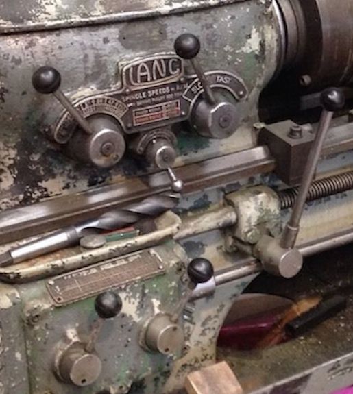

                          CHRISTOPHER MILLS 1
                            @christophermills1
                            Frank, Many thanks. There is no obvious lever to set between lead screw and feeds power shaft. The only control lever addressing these is a right/left reverse feeds/threads lever on the headstock, beneath the main spindle speed levers. This has left and right, and, I am guessing, a neutral in between, whereby the gearbox is disconnected from the headstock. Here is a picture showing it set to 'right'.
                            Apart from this, there is nothing on the gearbox itself, aside of two main positional levers which set the six speeds. Only Lang guidance in the Owner's Manual says that when not using the lathe for threading, that the change wheels on the external part of the gear box must be left disengaged. This suggests to me that the lead screw is normally unengaged, and that it only comes into operation when it has change wheels attached. That might suggest the spindle is primarily connected not to lead screw but power feed shaft.
                            Here is another shot, which shows all control levers together – two main spindle speed levers on headstock, little feeds/threads lever between them, two main speed selectors on gearbox, and main clutch control lever. With prime information on the gearbox information plaque being only feed and cut speeds, my initial conclusion is that the lead screw does not work at all without external change wheels mounted, and that power from the spindle goes primarily through the power feeds shaft. I will know more next time I see the lathe in a couple of weeks from now, when I will take off a few covers, and see better what troubles us.
