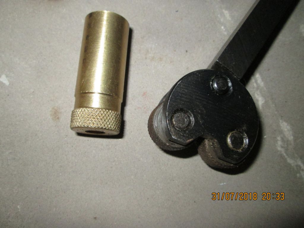

                                    Mick B1
                                      @mickb1
                                      Well, I never knew there was so much in knurling.
                                      I bought an Ebay cheapie at about £9.99 IIRC, and it does this:-
                                      Bear in mind that bit of brass has been kicking about in my scrap tub for a few months since I knurled it. The knurl wheels are hard and sharp, but the holder could've been made by a semi-skilled mediaeval blacksmith – I keep having to pinch its cheeks together in the vice when the force and the coarse feed loosen them off. I run slow, lean hard and don't do no fancy calculations.
                                      When it finally breaks I'll buy another.
                                      Here's another example of its result:-
                                      The blue things are titanium.
