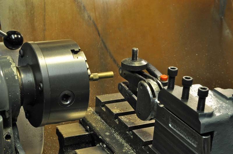

                              Gloster tooling do a range of knurl wheels **LINK**. I find knurling is a fairly forgiving process and a simple design like my commercial version (Denford Small Tools) works fine:
                              This takes 1/4 inch bore wheels. The pivots are simply roll pins. However, I have found that the width of some of the wheels I have is a bit variable against the stated size so a larger gap between the arms with an allowance for a packing washer or two might be a good design feature.
                              HTH,
                              Rod
                              #358032
                                My homebrew knurling devices use phosphor bronze pins for the rollers.
                                Using a circlip on the left side allows safer working close to a chuck.
