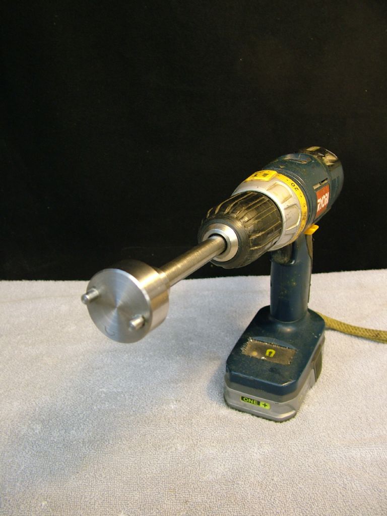

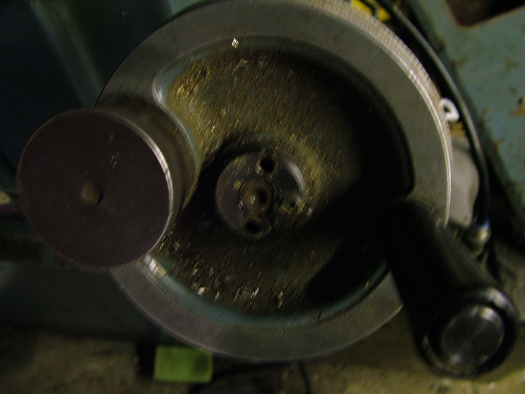

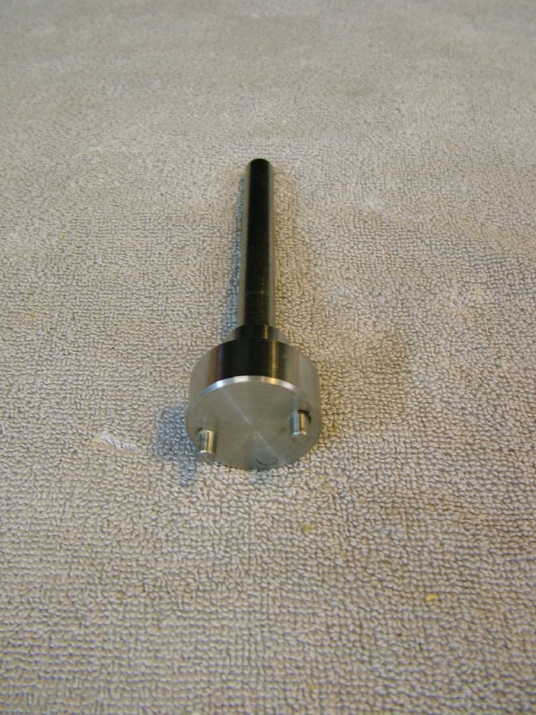

      The drill seems to manage with no problem.
      Regards.

        A quick but useful accessory.

          I do a similar thing with my rotary table although that requires a hex bit. Handy for turning it during setup. Main problem is the hex bolt working loose if you turn it anticlockwise. Your last photo is fuzzy – is there a locking device there at 3 o'clock?

            Ahh sorry about that, the lighting isn't so great there. I'm not sure how the dial fixes on or what that third screw does tbh . The shaft that fits the drill is threaded M12 and screwed on with superglue. If it unscrews in use I'll pin it but it seems ok at the moment.
            David.
