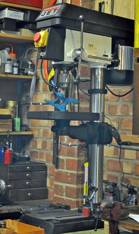

          I've got the 15. When I was looking for a new drill, the Jet was the only one I could find that actually specified run-out on the spindle. Run-out on mine shows zero on my DTI and the table tram is less than 1 thou at the edge all round. I'm very happy with it from that point of view although speed change is a bit clunky since the tensioning device is a bit crude. I keep meaning to modify it…
