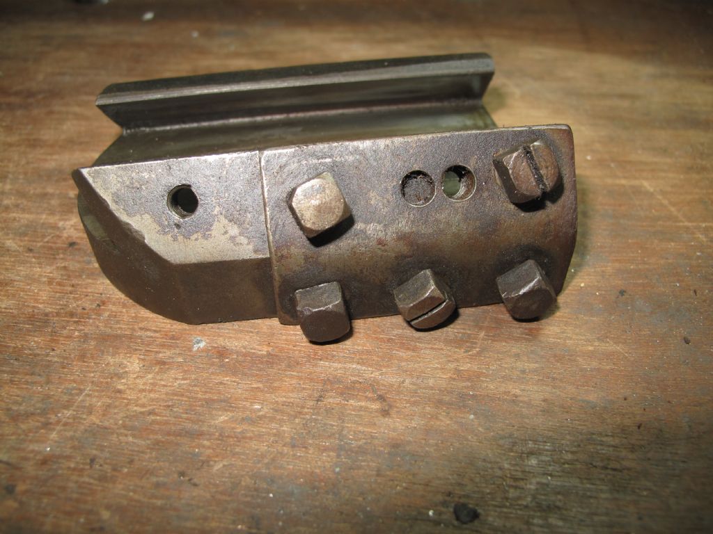

      I've just bought an 1920/1930 bench shaper, which is in suprisingly good over all condition. About a third of the clapper box slide castings has snapped cleanly and has been repaired with a piece of bent sheet metal, with screws through to the broken and intact pieces of the casting, must have been repaired years ago as they used square headed screws. The fracture between the two pieces of casting is clean and the two pieces sit quite firmly together. My question is: has any one repaired a working casting with JB Weld and if so was the bond tough enough to be considered totally repaired. The only other option would be to braze the pieces together, but there is the chance of the parts moving during this process.

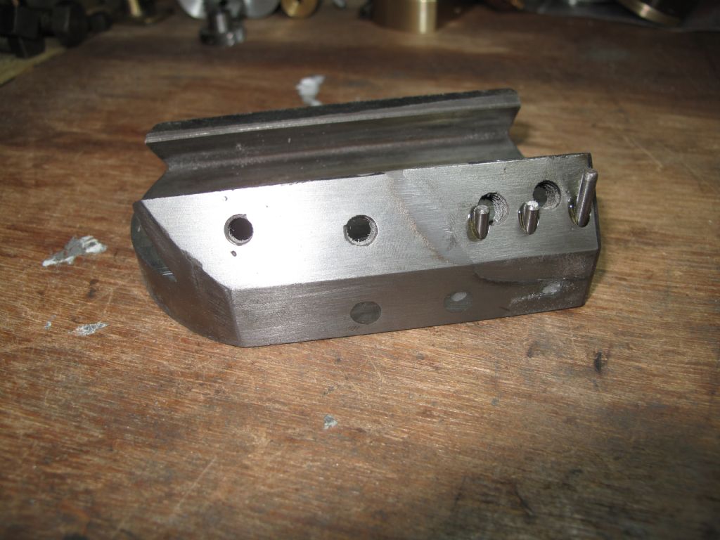

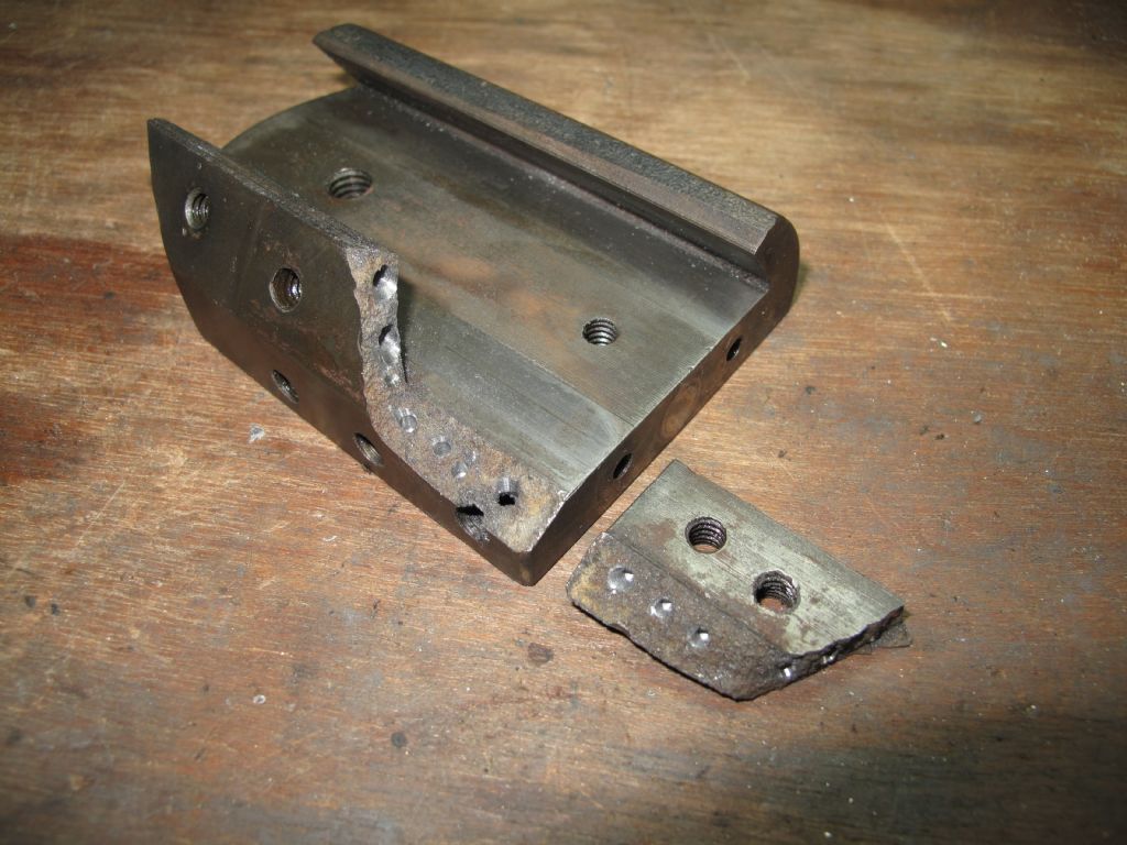

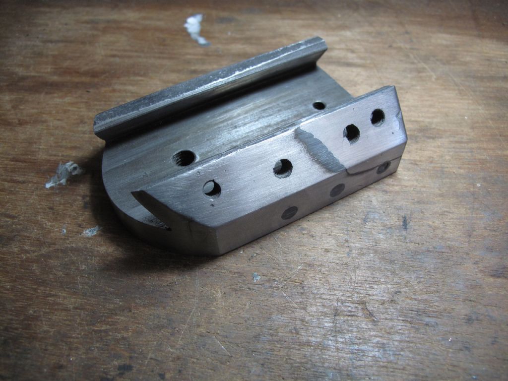

                        #97912
                        mick
                          @mick65121
                          This is the first attempt at posting photos, so please forgive the presentatiom.
                          The first is the repair to the tool slide casting.
                          The second is the two pieces centre drilled to act as a key for the bond.
                          Next, after 24 hours the bonded casting is pinned with 1/8th sliver steel secured with bearing lock
                          Last, the new repair.

                          #98055
                          Sub Mandrel
                            @submandrel
                            If that's a strong as it looks good, you can be proud.
