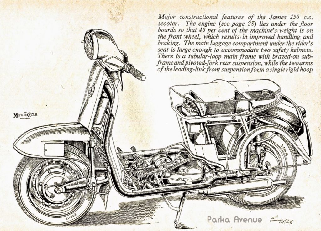

                      Plenty of pictures of James motorcycles on the 'net, amost all showing a "pancake" style filter – where one is fitted. The only image of a scooter that I could find is this one:
                      It's not very good quality but if you zoom in, it seems to show a perforated box-like structure which could be the air filter alongside the carburettor. Could this be the style and form for which you are searching?

                                        That's a very comprehensive parts list but about the only thing it doesn't show is the air filter! It does, however, list an air filter, connecting tube, sheild and flter adaptor, all of which seem to me to chime with the drawing I posted in my previous posting – if you use a bit of creative thinking.
                                        s there not some sort of James scooter club somewhere that the OP could consult?
