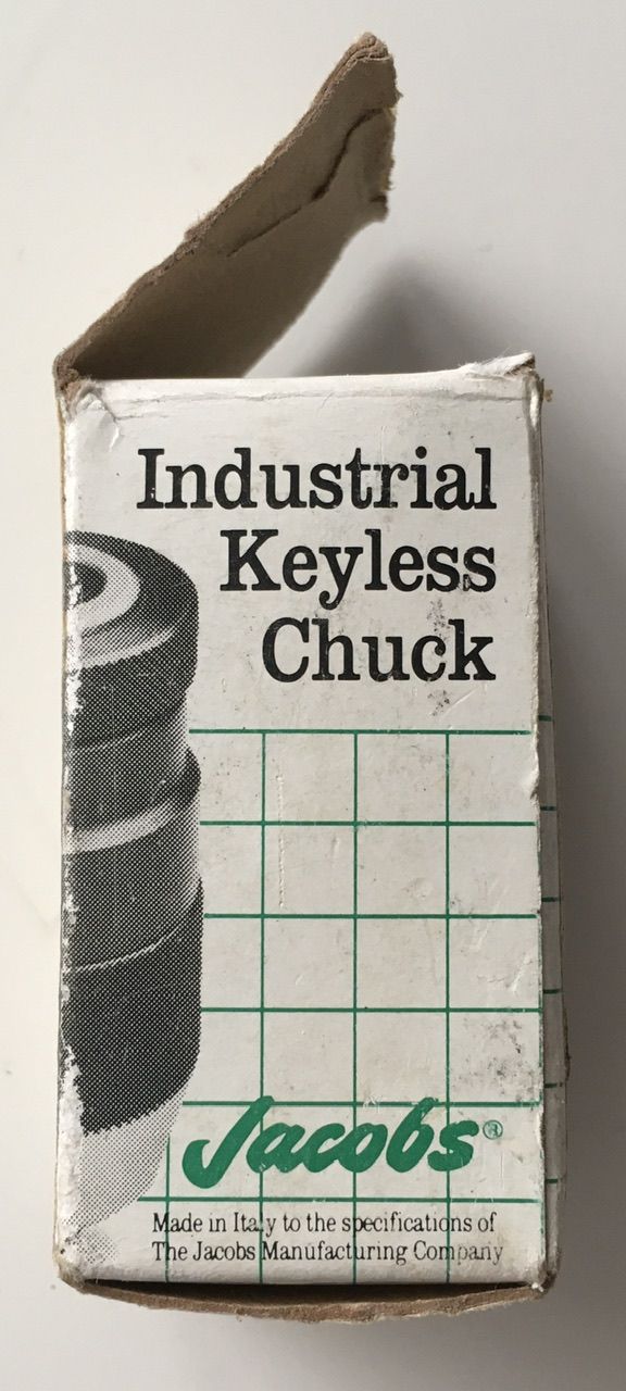

                                Don’t know what vintage this is: I picked it up at the Flea Market, today
                                Made in Italy … by whom, I wonder ?

                                  MichaelG:
                                  You remind me of my expensive walking boots "Engineered in Italy" but actually "Made in Romania"!

                                    I would guess that it was made by Porta. They are (were?) a very respected manufacturer of drill chucks. I have one and it is every bit as good as my older Jacob's chucks. They were still in business up to a couple of years ago. But who knows if they still are.
                                    Andrew.

                                      Thanks for that, Andrew
                                      … I haven’t even taken it out of the cellophane yet, but it certainly looks the part.

                                          Hi, looks like Porta are still in business Porta
                                          Regards Nick.
                                          #635120
                                            That will do nicely for me, Nick yes
