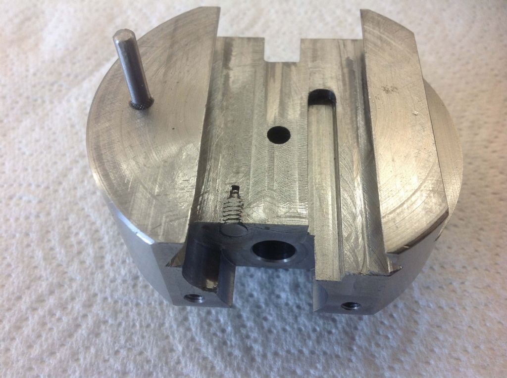

      Clamp a piece of metal against the gap then tap?

        Do I understand that there will eventually be a pin sticking out of this hole? If so how about machining the existing hole into a rectangular slot, with the centre of the slot where the centre of the pin should be, then make a pin square one end, round the other , set it into the slot and put screws through to hold it in place. All a bit of a tricky set up, but the worst is that you have to have a few attempts at the square/round bit. In fact you could make the first deliberatley undersize, fit shims to get it in the right place, then make the final one to correct geometry.
        I'd regard welding as a last resort, it could easily cause distortion to what you've already machined.

          I bet you're all busting to know what cock-up I'll make next, aren't you? Decided to try the Michael Gilligan approach first and did as Geoff suggested and clamped a bit of steel to the edge before tapping. As I've only got a plug tap in 6mm, I had to go a bit careful-like. Didn't want to end up with a broken tap end to get out as well. As a consequence, I couldn't get right to the bottom of the hole, but near enough. After a clean up with an end mill, I'm at the stage you see below:
          Not pretty, I grant you, but I console myself with the fact that it doesn't take any great strain in operation, serving only to locate the idler gear; neither will it be visible when assembled. Unfortunately, I know it's there and I can't erase that from my memory. I might even pop a bit of J-B weld in for cosmetic reasons! Now that would be ironic!

            Hey, we aren't doing this because we're dainty are we? Nahhh, rough work is ok by me. It's nothing compared to the state of some of my things, you should see my bench vice.

                  So you can see some thread ?
                  Why not warm it up with a gas torch and flow some solder into the voids then clean up afterwards?
