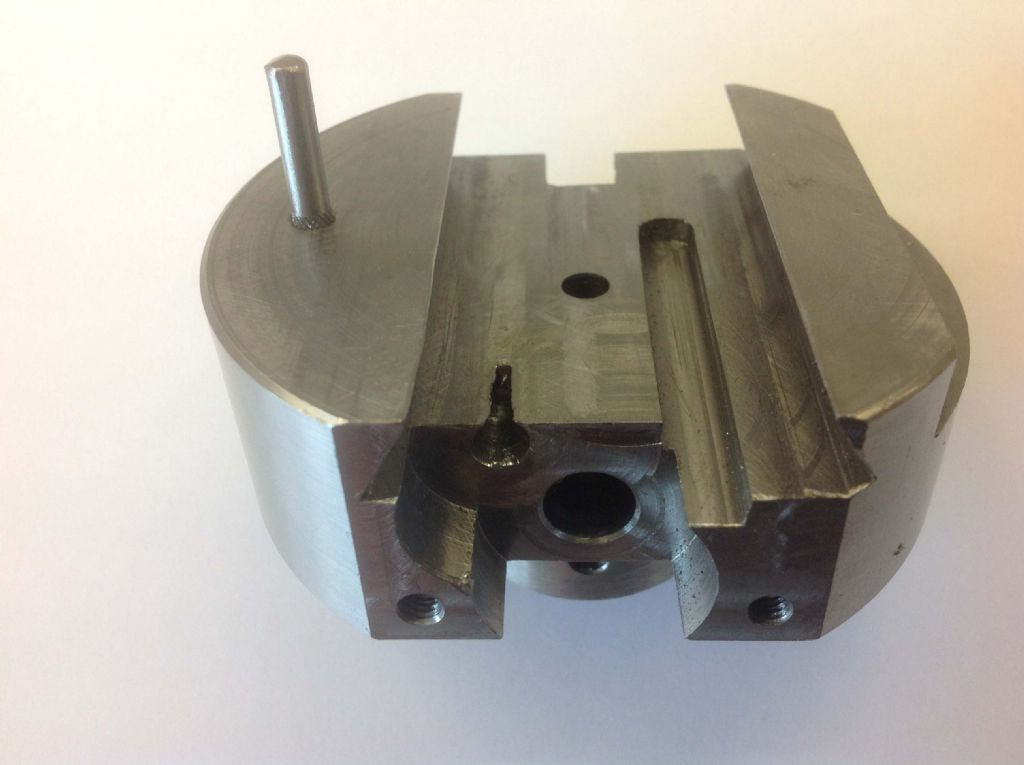

      I have made an error while machining the main body of my boring and facing tool after having invested a LOT of time getting it what I thought was right. I've drilled the hole for the idler gear in the wrong place, but only by a gnat's knee-cap. In trying to rectify the situation, all I've managed to do is make it worse. I've read good reports on J-B Weld coming to the rescue of some on here, so I thought I'd at least give it a try. I wanted J-B Steelstik but all I could get was some two-part J-B Kwik from a local motor factors. I mixed it as directed after cleaning the part thoroughly and applied it to the hole. It was supposed to set in 4 minutes and be machinable in 4 hours. That was yesterday, and allowing 24 hours plus, I had a look at it. It had the consistency of half-chewed bubblegum! I've emailed the UK importers for guidance, but don't expect a reply for a while, so I thought I'd ask on here if anyone knows:
      a) if this could be old stock, past its sell by date,
      b) can the stuff go "off" – i.e. become unusable in the tube and
      c) how do I remove the sticky mess I'm left with?
      Thanks for any assistance forthcoming,
      P.S. Ideally I'd use proper metal weld to fill the hole but no longer have welding facilities at home.

                                    If you've only got a hole in the wrong place, why not thread it and plug it with a threaded steel plug, loctited in and then re-drill the hole in the right place ?
                                    Richard.
                                    #244221
                                    John McNamara
                                      @johnmcnamara74883
                                      This weekend I made a drilling jig for drilling linear ball rails from scrap steel that was at hand, there were a couple of 9mm holes that while not in the way spoiled the look of the jig which I intend to keep.
                                      They were old and a bit rusted so first I drilled them out to a slightly larger size (they were through holes in 5/8 bright plate). Two lathe turned plugs were made about a thou oversize and about 5mm long from mild steel, these were driven into the holes until projecting both sides by 2.5mm.
                                      Next I peened the plugs until they flared around the edge of the hole slightly this reduced the height to about 1.5mm. this forces the mouth of the hole out forming a taper and making the join line close to invisible when finished.
                                      Then I machined off the projecting plug with leaving the thickness of a piece of paper about 3 thou to go, I did not want to mar the surface of the 5/8 steel plate.
                                      Lastly I stoned off the remaining projection.
                                      These plugs would have to be driven out with considerable force they will never work loose and are almost invisible.
                                      The trouble with glueing in plugs is there will be a fine grey line around them. The same applies to threaded holes. I prefer to drill out the thread, fit a tight driven in plug then finish as above.

                                          Much as I appreciate your helpful suggestions, if you look at the photo below, you will see that the hole is (was) very close to an edge. My attempts to rectify the situation have made things considerably worse, leaving me the only option as I see it, which is to find someone to weld it up for me. Unfortunately, I left my welding kit in France last year when we came back to the UK, along with a load more stuff I now find I could do with!
                                          Wartsnall
                                          As you can see, the hole – originally 4mm diameter and since increased to 5mm, has broken through the side of the main body. I'll get it welded, clean it up and re-drill (in the right place) to 3mm and use a stepped shaft. That's the plan.
                                          Thanks to everyone for your contributions, I'm sorted, now, I hope.

                                              John,
                                              Just a thought [feel free to ignore it] … You could, carefully, run an M6 tap down that broken-out hole.
                                              Insert a length of M6 screw, with something like Loctite 601 retainer, and then trim it to shape.

                                                I would (if it was me) prefer to try that option rather than have welding splatter to deal with. If it should fail it could always be milled out with a slot and that then welded.
                                                Nick
                                                #244242
                                                John Hinkley
                                                  @johnhinkley26699
                                                  Michael,
                                                  You know, I will give your suggestion a try. After all, I've nothing to lose by it. Will report back if and when.
                                                  Nick. You may well be right. Weld splatter is not very pretty.

                                                    Although running a tap down partially broken out hole can, and does, work its tricky operation at the best of times as the tap will not only try to run out sideways through the broken bit but also attempt to jam up in it. How great the problem is depends on the depth of the broken out bit relative to the thread. If the broken out part is deeper than the thread its likely to be a battle. For a similar issue I was advised to clamp a piece of light alloy over the break and run the tap down. Theory was that the alloy would keep the tap sufficiently straight. Probably used a second cut tap. It seemed to work adequately but on reflection I wasn't over happy so welded it up for a do-over. At least I didn't have worries about body distortion affecting precise dovetails. Re-drilling the hard weld posed its own problems. Milling out a clean slot so all the re-work is in weld sounds to be a good approach.
                                                    i'm pretty sure that given a bit of practice I could have nailed the technique for straight tapping partially broken out holes to give more than acceptable results. But for something I never expected to do again the effort seemed disproportionate especially as by the time I needed to do it again I'd have lost the technique. Currently running at less than once a decade on that particular problem. Possibly because having discovered what right pain in the posterior fixing it is I tend to take a bit of extra care.
                                                    Clive.
                                                    #244247
                                                    not done it yet
                                                      @notdoneityet
                                                      Using a spiral tap might make threading such a hole easier. That is the way I would go, if I had gotten that far with the project. I would avoid welding because of the distortion and redrilling problems. I might even clean it out as a slot or dovetail and simply replace the area with an insert (grub screws at the edges would hold the new piece in).
