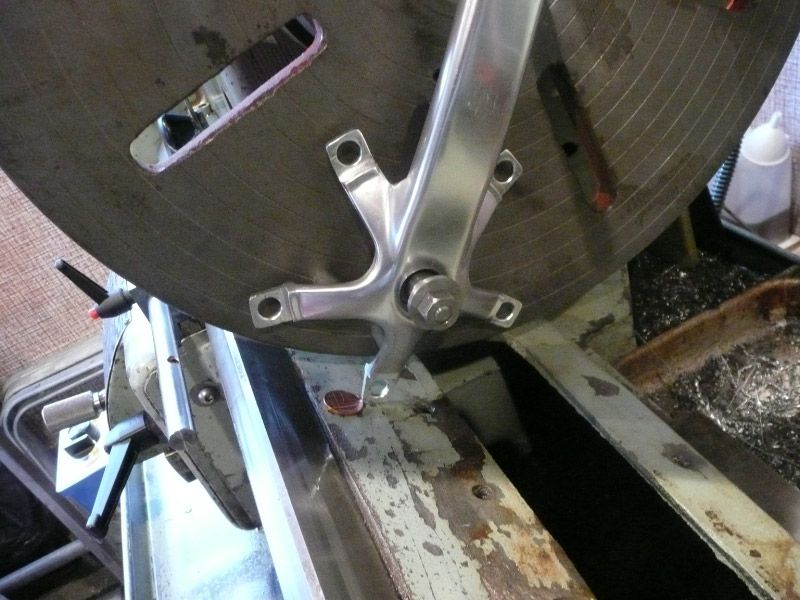

                                Engine Builder
                                  @enginebuilder
                                  Here is my solution.
