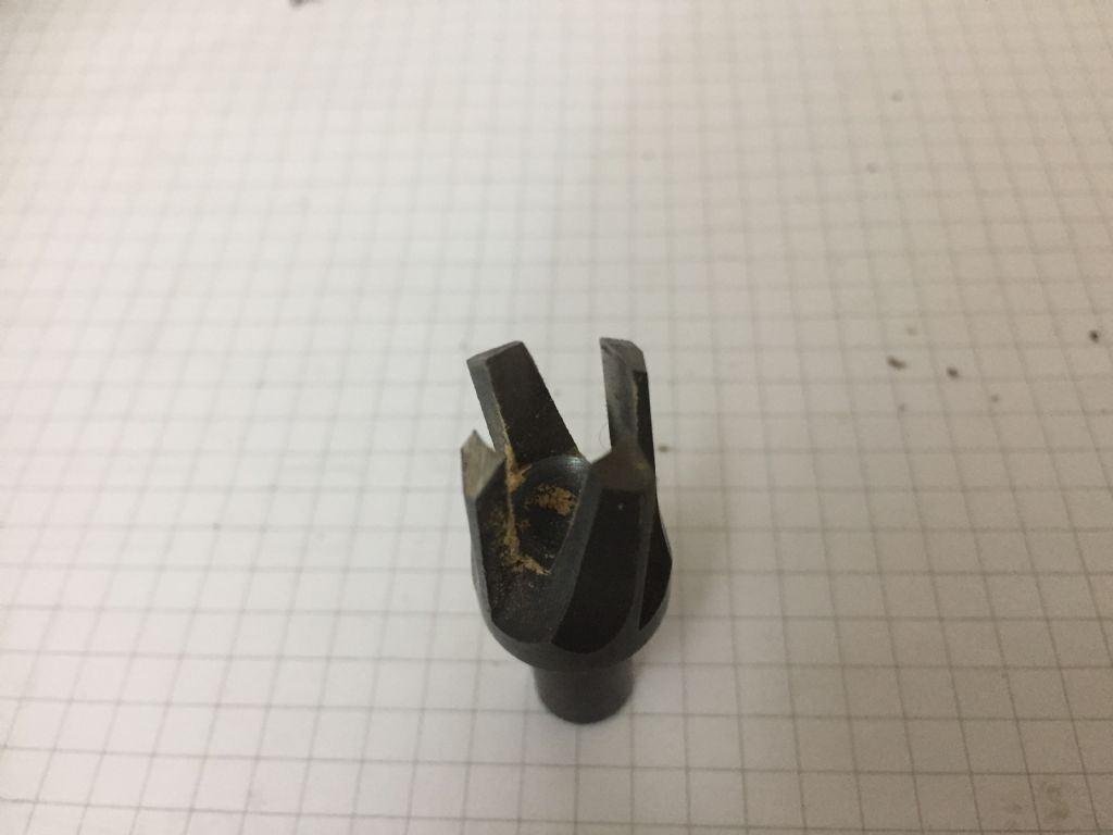

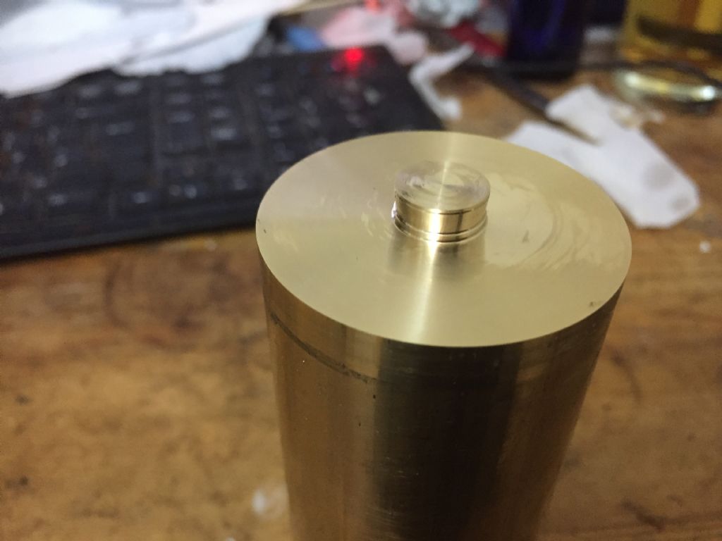

      I want to make some parts which require turning thin discs with 10mm 'spigots' – I don't know if that's the right word, but to give an idea:
      Ignore the 'features' on the spigot which are due to lapses of attention . At the moment it's 11mm so I can turn them out. I was listening to a jolly interesting murder mystery at the time, and sudden plot twists lead to involuntary muscle movements. That's my excuse anyway.
      My plan is to turn the spigot to size (I'm looking for an easy push fit in an H7 hole), part off a slice, then do another on the same bar and so on. As I have to do a few I was wondering if there is a tailstock tool that could form the 'spigot' accurately in one go if I rough turned to say 10.5 mm.
      To give an idea of what I have in mind there are woodworking plug cutters like this:
      Does anyone know if metalworking tools are available for this purpose? I suppose I could make something myself, but I'm reluctant to believe that this wheel hasn't already been invented.

          You may find a Rotabroach cutter with the desired bore, if not make one to suit from silver steel and harden.

            Yes, I could make a cutter but I'm a lazy b*st*rd, and if I could buy off the shelf it would be easier. Also I wanted to know if if such things exist for self-education. Strange as it must seem to those who have spent a lifetime in engineering, I didn't even know how screw threads were made for the first fifty years of my life. I'm an old dog trying to learn new tricks.
            I can make an internal bore to H7 with a boring bar, but for small diameters it's easier/quicker to drill and ream. I can turn 10mm externally accurately sure enough, but I was wondering if there was tool, analogous to the internal bore reamer, which would make the process faster and less prone to error.

              M ount a boring head in the tailstock and set the cutter to the required radius for the finish cut.

                Thanks Paul. That should work , didn't think of it. Compartmentalised thinking on my part – boring head is a milling tool… blush

                  Boring head – You would have to be certain that there was NO play in the tailstock quill for a boring head to be accurate.

                    Time to attend to that cross-slide stop.. ..doesn't have to be anything elaborate, but any kind of repetition work becomes so much easier..

                                              Hollow mills are available. Here s an example:
                                              **LINK**
                                              #558876
                                              John Reese
                                                @johnreese12848
                                                **LINK**
                                                Die heads like Geometric, Coventry, Landis, etc can be equipped with chasers that function like a hollow mill.
