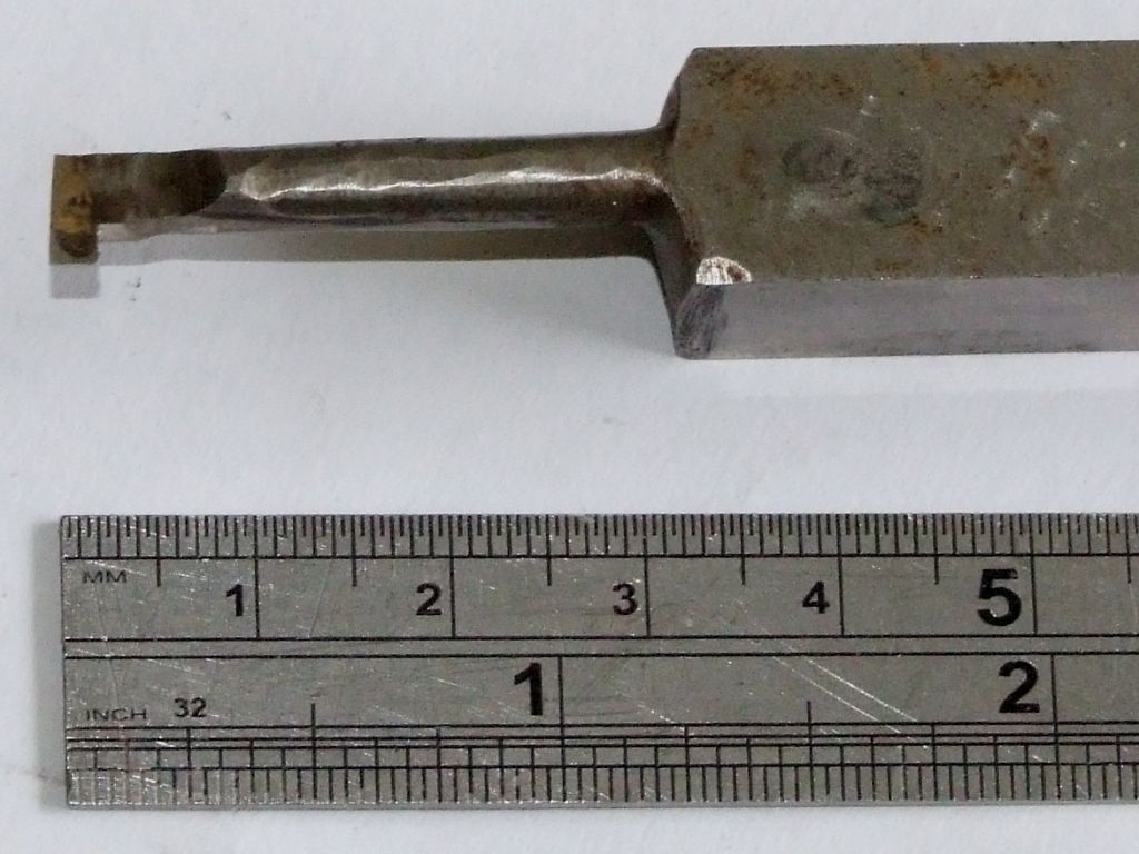

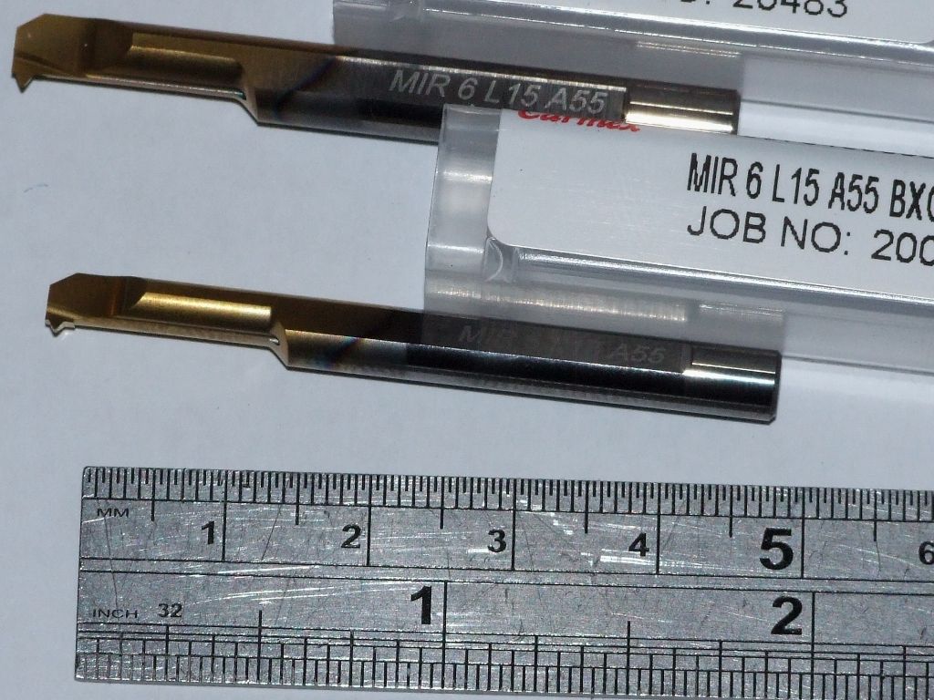

            There is no magic formula. Insert boring bars and carbide bars from professional tool suppliers will have a minimum bore specified. Bars from other sources will be pot luck. Les is correct; although these are internal threading bars the principle is the same, the cutting area is on the centreline of the bar, not at the top:
            Likewise with this home ground HSS bar:
            On insert boring bars the insert area is cut away, and slopes down, for the same reason.

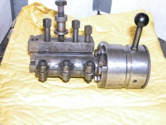

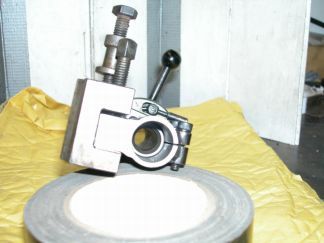

                                                Checking my carbide boring bars and I can see that although they are 8mm, the cutting surface is set down by a few mm as well – which would explain why they are bottoming out on the bore when an equivalent 8mm high speed bit (with the cutting nose at the top) works OK.
                                                JasonB – my toolpost does not have any provision for a round bar – will I need to fabricate my own or do the ones you've pictured also have flats? (RDG?). I'm thinking back to our conversation about parting tools.

                                                  If you need to arrange a holder for a large boring bar and have welding facilities maybe the one I made to mount a Coventry Die Head in a Dickson S2 holder will be helpful inspiration.
                                                  Simply a piece of tube welded to a substantial lump of square steel to clamp in the holder with clamp screw bosses welded on to hold the head shank, boring bar in your case, in. The only tricky bit is getting the mounting lump dead parallel to the tube bore. Careful clamping prior to welding did it for me.
                                                  Or get it close and clean up in situ with a drill held in the chuck if you have the means to do so. Rotabroach in the lathe chuck is the obvious cutter for that sot of thing. If you know a man who will lend you one!
                                                  I made the clamp bosses one piece, tapped half way and clearance drilled the rest. Used a milling cutter to make seats as deep as I could reasonably go before clamping and welding. Cleaned up the tops flat for cap head screw seats using the mill before slitting tube and clamp bosses. Slitting saw does a nicer job but hack or band saw is just fine. Had to sort some minor details by hand filing and deepen one of the clearance holes to go past the slot but it all went straightforward.
                                                  Worth the effort for a proper job. I have a morse taper ended bar made a snug fit in the bore so I can align it central using the tailstock.

                                                      William, if you want to use the toolpost then a 10mm dia bar will be about the largest you could use without cutting flats onto it, you can make or buy these blocks which the round tool fits into and then the whole lot goes into the toolpost.
                                                      Alternatively similar blocks can be used but clamped directly to the topslide with suitable packing which should allow you to get upto about 22mm dia.
                                                      Similar to Clive's photo you could make a holder like the one shown in this video ( scaled down a bit)or look up the "Gibraltar" type toolpost which replaces the top slide and gives a more rigid setup.
