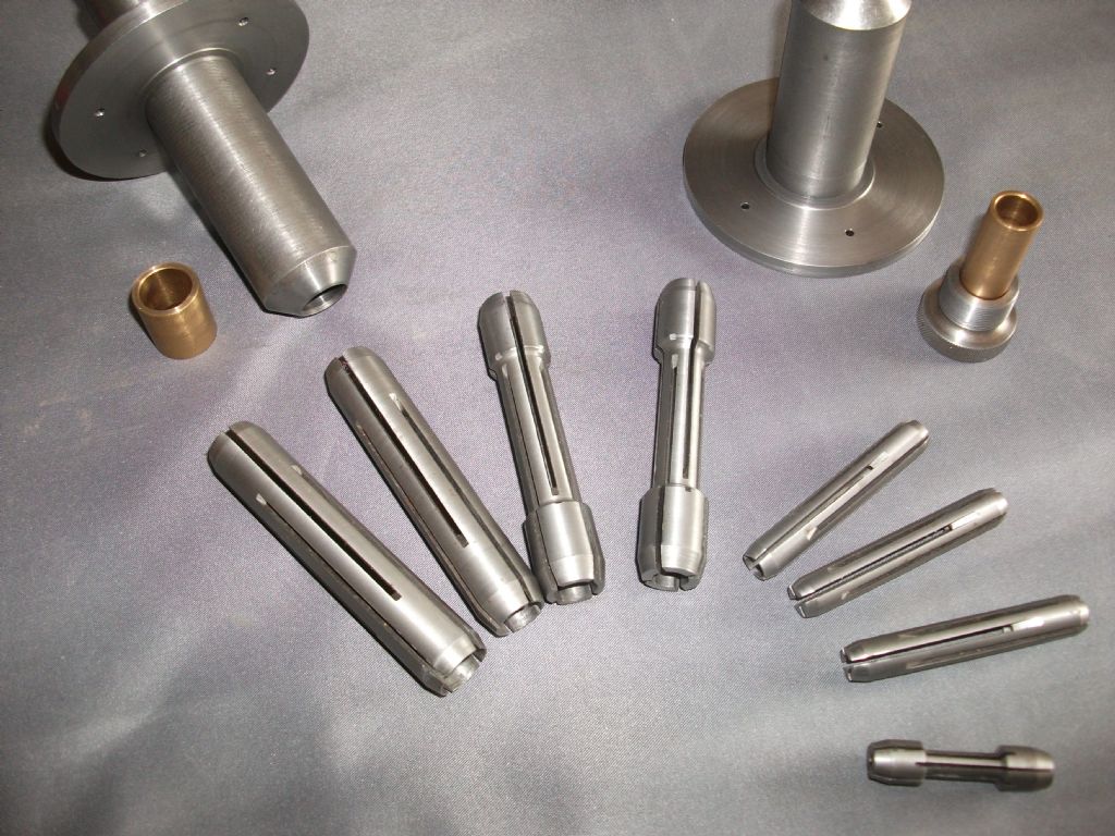

            Hi Mike,
            The collets seen here in the photo are for grinding 4 facet drills
            on a Quorn grinder,they are an adaption of Derek Brown's four
            facet system that was in the model engineer many years ago.
            They are similar to what you have in mind for these internal collets.
            As you can see these have 8 saw cuts ,after all of the turning
            was completed a short piece of round material is placed
            in the bore and the job held in a 4 jaw chuck on the dividing head.
            The jaws of the chuck are at about 45 deg to the horizontal to miss
            the slitting saw ,the saw is fed in close to the chuck and the cutting
            is done away from the chuck ,this is particularly important when the
            job is turned around and reset to do the second set of
            four saw cuts.
            The short piece of round material provides enough stability and
            clamping force for the chuck to hold the work securely.
            The material is silver steel unhardened,the largest is about 3 1/4
            inches long and will hold up to 1/2 inch drills ,the smallest about
            1 1/2 inches long and will hold a .5 mm drill.

            #417184
            Mike Waldron
              @mikewaldron61652
              John:
              thanks for that.
              Mike

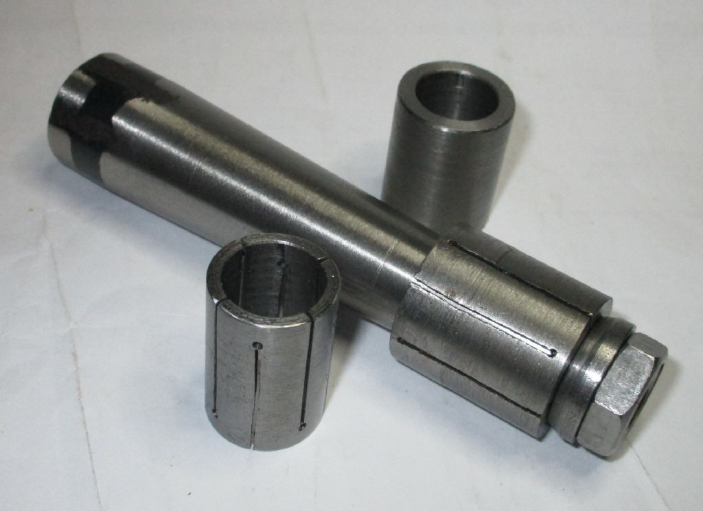

                  Hi Mike,
                  If you mean "collets" for an expanding mandrel, like this:
                  They are not difficult to make. When the topslide is set for taper turning I use the same setting both for turning the taper of the mandrel and the collets in the same setting. I turned the taper in more collets than I needed so I have some spares. For slitting I just used a small hacksaw.
                  Thor

                        #417264
                        Thor 🇳🇴
                          @thor
                          Posted by Mike Waldron on 03/07/2019 21:38:54:
                          Thor:
                          thanks for that.
                          Can you recall what angle you made the taper?
                          Also what sizes do the collets / arbor sleeves cover?
                          Mike
                          Edited By Mike Waldron on 03/07/2019 21:40:25
                          Hi Mike,
                          I made the mandrel many years ago so I don't recall what angle I used, but the "narrow" end is 14.2mm dia., the "big" end is 22.3mm, the length of the tapered section is 85mm. The thread at the narrow end is MF14 x 1 since I happened to have a MF14 x 1 tap. I have got a smaller expanding mandrel as well, I have a tapered reamer that I used to crerate the taper in the small collets. The mandrel itself is made from a high carbon steel (0.8 to 1% C) and mild steel for the collets. I hope that helps.
                          Thor

                                #418251
                                Thor 🇳🇴
                                  @thor
                                  Posted by Mike Waldron on 10/07/2019 20:19:49:
                                  Would that not cause a jam up?
                                  Is that not the whole purpose of a morse taper?
                                  Mike
                                  The mandrel I made has a taper not far from what you find on Morse tapers and the sleeve will hold even if the nut isn't used. I use a brass drift to knock the sleeve off. I have used the sleeve to finish turn gear wheels and pulleys so I need a good grip.
                                  Thor
