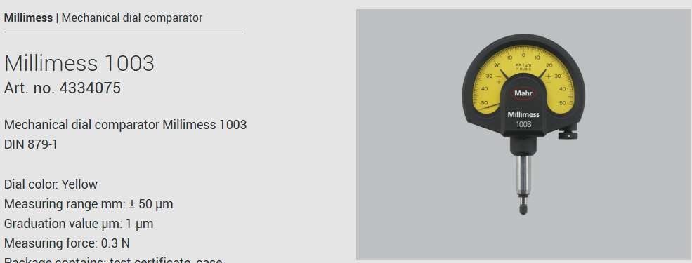

      Hi all,
      I have acquired a Mahr Millimess 1003 comparator gauge,well used but not abused but it has a small crack in the plastic lens (Im sure there is a proper name).
      I am sure Mahr would repair it for me, but probably charge me more than the new cost.
      Try as I may I can’t find anyone in the UK who does a repair service of such things.
      If anyone knows of someone I would be very grateful.
      Many thanks
      Lee

        Try watch and clock spares suppliers like Cousins/ Meadows and Passmore and another one beginning with H but escapes me at present, someone will know shortly.

          Some helpful instructions here; though not ideal for us in the UK as a spares supplier
          https://longislandindicator.com/crystal-installation-instructions/

              Sorry, only just realised it’s not a round crystal on those.

                Cousins sell STERNKREUZ acrylic crystal material in squares. Available in various thicknesses, and simple to cut with a jewellers saw
                PETG sheet for vacuum forming is also a viable material

                    You could try : H Roberts and Co ( indicators) They are situated on the ring road in Leicester. Their website shows a huge range of various indicators. In the distant past I have had dial indicators repaired there but it is some time ago and I couldn’t see any reference to repairs when I looked earlier this evening. Hope you find someone to effect your repair.

                      If it was a Mitutoyo I could buy a spare, flipt it off and replace.
                      This one is an irregular design and stuck in from the back and probably sold as a complete front unit, so I might be out of luck altogether.
                      I guess to do this work you need the skills/patience of a watch repairer but without the rewards.

                        For those who, like me, didn’t check on the model, it’s one of these.
                        https://metrology.mahr.com/en-gb/products/article/4334075-1003-feinzeiger-millimess—50um—1um-03n/

                          If you can remove the front frame then the crystal is likely removable and could be used as a template to cut a new one from PETG sheet or acrylic.
