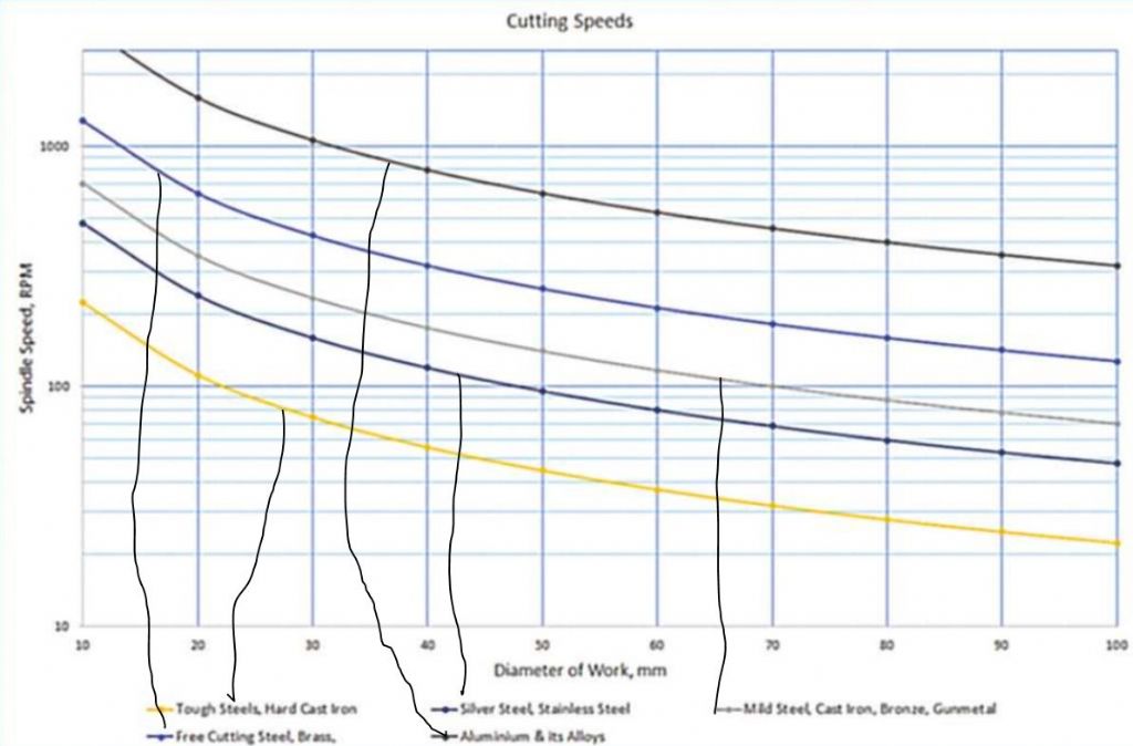

      I have defective colour vision – I am an extremely protanomalous trichromat.
      I can NOT distinguish between the different coloured lines on the graph on page 60 of Issue 303. Only the lowest speed line appears different to the rest.
      It would have been much better for ALL readers with defective colour vision (around 3% of the population) if different sorts of dotted and dashed lines had be used rather than different colour. Or the different lines could have been labelled in the margin rather than using a legend.
      At first sight it seems that the writer of the article (who is not named) is discriminating against disabled (ie colour "blind&quot readers.

        Cutting Speeds Graphs

          #541798
            Not the best colour combinations even for those that don't have problems but I'm sure it was not intentional.

              Hi, I don't have any colour problems, but I also found the graph difficult, although I got it correct according to JasonB's example. It is the top, the second and the fourth lines down that are hard to tell which is which, with the second and fourth being the most confusing, but I concluded which ones were which by the speed range and the materials, which of course can be difficult to those who don't have a clue. It may have been better to have put A B C D and E adjacent to the ends of each line on the right hand side.

                Your point is valid, but with a little thinking, it is not a great challenge to work out which line relates to which material.
                Given the following list of materials, in what order of cutting speed would you rank them?
                Tough steels, hard cast iron
                Silver steel, stainless steel
                Mild steel, cast iron, bronze, gunmetal
                Free cutting steel, brass
                Aluminium and its alloys
                Plastic and wood

                  As Nick says a complete beginner would have difficulty arranging those materials DC31K. Just look at the Proxxon saw thread no idea of what speeds are needed or why and did not know how to work out rpm given the cutting speed of the material.

                        Excuse my ignorance, are there any colour combinations that work for all colour deficiencies? By making a chart better for one group do we alienate another?
                        Question asked purely as I don't know the answer, not intentionally rude!

                          Your point is well made, John … and I suppuse the short answer is NO
                          The site that I linked last night has some excellent illustrations.
                          The classic way to avoid this problem is to use shape as distinguishing feature.
                          e.g. Lines can carry markers [squares, triangles, etc.] to distinguish them … either instead-of, or in addition-to, the colours.
                          The use of colour alone is, I suggest, a triumph of style over function.
                          Edit: __ This is the best example I can find of a toolset:
                          https://www.wavemetrics.com/products/igorpro/creatinggraphs/2dgraphs/linegraphs/graphmodes

                                I don't see the need for colour except for aesthetics on this chart, the curves do not intersect so grey scale with embedded labels will be fine

                                    there are several books that cover how to display data – eg the cutting speed chart is simplified if the medium is printed adjacent to the rightend termination of the curve – no colour is required and the result is simple + obvious

                                      Frances,
                                      That does seem an excellent solution, for a simple graph where the traces don’t cross yes

                                        Printing off the graph in Black and White instead of colour would need suitable arrows to show ho each curve relates to the material to which it refers.
                                        Using different types of lines, (Solid, dotted, various types of broken ) would help, no doubt.
                                        EXCEL provides for different types of line, and point marker, in addition to a variety of colours.
