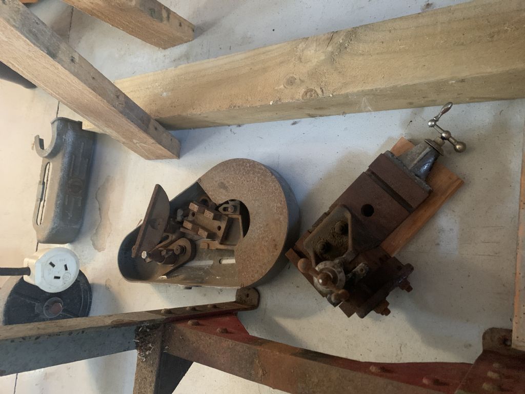

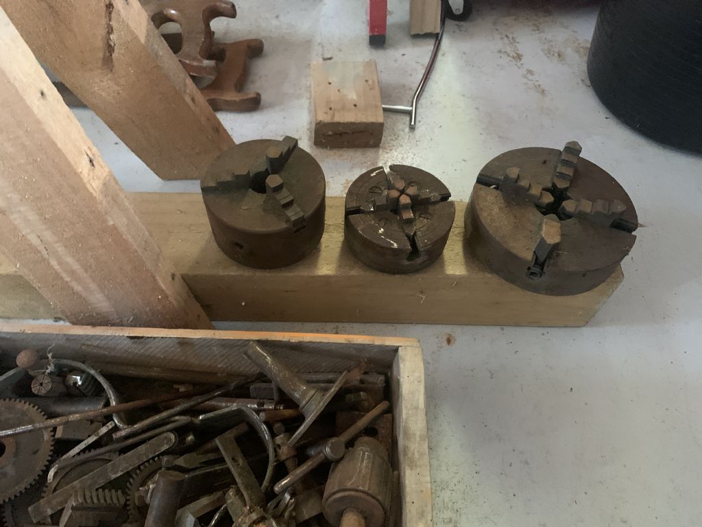

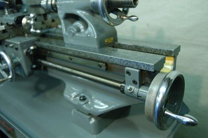

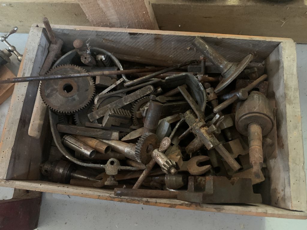

                            Thanks very much everyone for the advice. My inclination was to strip it as a project – lots of sage wisdom here has convinced me to take the subtle approach!

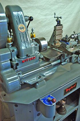

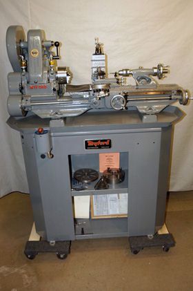

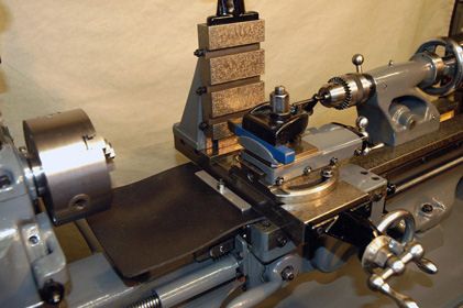

                              I bought a Myford a few years ago, but have not had time to use it.
                              I have been snowed under with work projects literally for years.
                              I keep in a humidity-controlled environment to prevent condensation on the bare parts.
                              With some TLC, yours can look like this again.

                                  Here are some reduced samples of the material I have.
                                  I have a lot of original brochures that explains every part on the Myford 7, and explains the various accessories that can be used with it too.
                                  Edited By PatJ on 03/03/2021 07:07:51

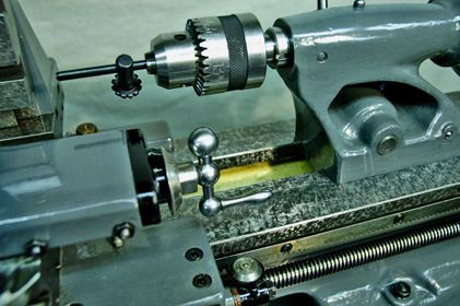

                                    A few more reduced size brochures which I found helpful for identifying parts, pieces and accessories.

                                          Posted by Tom Grace on 03/03/2021 06:20:15:
                                          Wow! Looks like you have scored the motherlode of Myford accessories there. And the rust on the base machine appears very light. I would clean the paint down with degreaser etc and maybe wire brush the painted area and repaint with brush paint without disassembly. Looks like the bed ways and leadscrew and motor drive unit are all in pretty uncorroded condition. That is great,
                                          The boxes of bits appear to contain a fantastic collection of accessories. The old boy seems to have collected about the full kit over the years. I see a long cross slide – highly desireable – with rear toolpost plus regular cross slide and veritical slide, plus lever action tailstock. All very desireable. And the boxes appear to hold a treasure trove of change gears and tooling. Very good. And I see a Myrford milling vice, various collets, a ball turning tool, V blocks, reverse chuck jaws, hand turning rest and just about everything imaginable short of the Myford dividing head. A good haul!
                                          PS every time I look at it I see more. It has a clutch and a graduated leadscrew handwheel. Awesome.
                                          Shame the cross slides etc appear to be more rusted than the main body of the lathe so best clean them up, post some pics and seek advice on best way to proceed there. Again careful cleaning and repainting with a brush will work wonders. A wire brush in the electric drill is good for painted areas and rust that is NOT on essential precision slide ways etc.Do one piece at a time so parts do not get mixed up etc.
                                          Keep us posted on how you go. And seek advice frequently. What you have there is well worth taking care of.

                                              I agree with Hopper that you have scored a wealth of desirable accessories for your ML7. I suggest that you trust your late grandfather's judgement regarding the non-Myford items – he almost certainly acquired/collected them because he figured they'd be useful. Time will tell.
                                              The official Myford user's instruction book (that's not its proper title ) includes illustrated parts lists. These include what are often termed 'exploded diagrams'. Those lists and diagrams are available in down-loadable form on the Myford web-site. (Also, I believe, for the Super 7 as well as for the ML7.) Here's an example: **LINK** . (Note to moderators: I hope I am not out of order with this link in view of the latest forum rules. )

                                              P.S.: The electrical socket in one of your photos doesn't look like a UK item – what is your geographical location?
                                              S.M!
